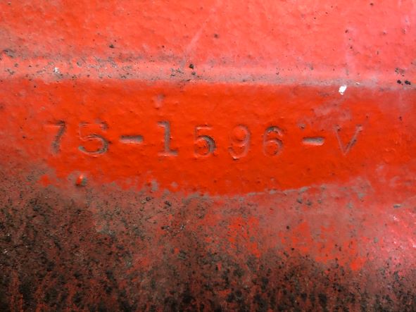

175 gas engine serial #s always end in a -V from what I've seen. Here is one from a repair we did back in May 2020.

Thank you so much, Alex !! So, the AC owners manual AND the Nebraska Test information are indeed incorrect !!    A-C designated this last generation G-226 engine (8.25 to 1 compression/ special camshaft grind / Marvel TSX928 carb with 2 inch air inlet and 1 inch venturi) as the "75" - XXXX - V.   The D-17 engines were "17" ........  the One-Seventy engines were "7" ....... and the 175 engines were "75" ....... information complete !!!  Now, to track down the one and only surviving One-Eighty prototype tractor with the G-226 engine ( I know where it is)....wonder what it says ??  I know it has a mechanical fuel pump on it underneath the engine oil filter. My wild guess is   8 - 1001 - V  ?

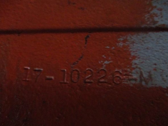

Normal d17 tractor engine serial # here showing 7.25: comp ratio:

Correct.  D-17 G-226 with M code is 7.25 to 1 compression and Z-code is 8.0 to 1 compression ratio. So, at the time that engine was built, I assume it was before July of 1967 when the One-Seventy was released. Really makes no difference, because the letter determines the compression ratio when that engine was built. The "V" code was in D-17 factory LPgas engines and all 175 gas engines. Yes, the lone non-vibrating One-Eighty G-226 tractor still exists., and as I said it does have a fuel pump on it to keep up to the 5.5 GPH fuel burn rate that 64 HP would require.
