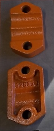

Posted By: PaulB
Date Posted: 15 Aug 2022 at 6:17am
if you're missing the coulter mounts, I have new ones.
