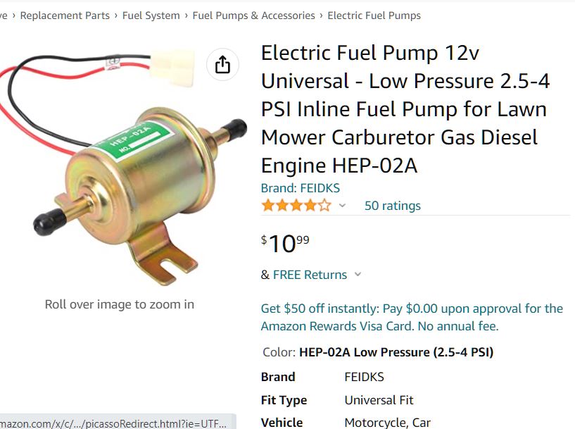

Posted By: steve(ill)
Date Posted: 29 May 2022 at 9:56pm
i would buy a small electric pump for $10. and bypass the vacuum pump.

Posted By: Thad in AR.
Date Posted: 31 May 2022 at 9:25pm
Update
I installed an electric fuel pump. It started and ran perfect for about 5 to 10 minutes and dies as it has been.
I was very unhappy.
I started checking for spark and it was very weak and sometimes not at all.
I even grabbed the plug and didn’t get hit.
