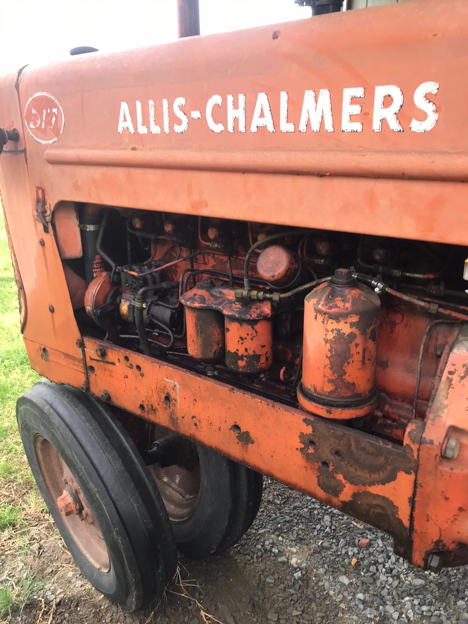

Looking at series 1 diesel. Nice sheet metal, runs well and to my surprise clean exhaust. PD works well, doesn’t appear to be a gear jumper as I went down a step hill in all gears. New clutch, rear main seal and head gasket a few years ago. Unknown hours, Tach works, hour meter does not. Generator needs to be rebuilt, has a alternator that I do not like. I would want to have the generator repaired. What else should I look for? Are the D17 diesels more reliable than the D-19?

40 psi oil pressure. I drove it for about 20 minutes, tested brakes, and pulled several steep hills as well as running around a field. Temp gauge peaked at about 180 degrees.

While I’m the area of the oil filter was there a primer located where this rubber hose is placed? I have a factory parts and service manual and I haven’t been able to find one. It has 2 brass nuts so I’m thinking there was a primer somewhere in the fuel line.

Going by my service manual there doesn’t appear it had a primer pump. Still need to know if I can remove the oil filter base to remove the stuck plug? Is there anything attached to it in the block or just a drain hole going back into the block?
Posted By: AC720Man
Date Posted: 29 May 2022 at 8:05pm
Anyone know the answer?
Posted By: Charlie175
Date Posted: 30 May 2022 at 1:05am
Don't see one on the parts diagram. The fuel tank line goes direct to the filter housing.
Maybe the tank pressure was enough to prime it.
Charlie
Date Posted: 30 May 2022 at 1:10am
The oil housing has O rings behind it to seal
Charlie
