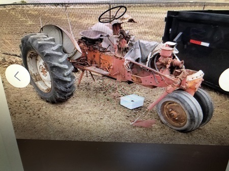

 A guy offered this relic at an almost sale price,,,, He tells me it is a Ford 9N but it looks way too long to be a 9,,,,??? if original paint,,might it be an Allis,,,,??

sure looks like a small FORD.

9N/2N will have 3 speed trannys, Left brake next to clutch on left side
someone's 'bodged ' the hydraulics..
no front end picture s??
9N made from 39 to 41, 2N 42-47, 8N 1948-52...
now Fergusons looked a lot similar(some parts interchange)

Looks like a Ford. Does it have a Sherman 2 speed installed? That would make it longer. I wouldn't bother to haul a 9N/2N home if I had to work with it.

looks like a hundred series row crop to me (700/900), look at the axles under the edges of the fenders, looks like drop box axles, and the lift arms have the holes for the lift rods for cultivators and the mounts for the lift arms under it have the drop brackets too

 Hubert,,,I have no idea what the sherman trans is,,but it must have one as the side view shows the tractor to be quite a bit longer that a regular 9 or an 8.... and it also has the narrow dual front wheels,,,,,and the wheels are not those BIG wheels like most 9's and 8's have

I would say that it is a Ford 960.  The first picture the transmition shifter is for the 5 speed.

looks like the fenders have been chopped to fit?

IIRR, dorfs have s/n stamped on the tranny, right on top , behind starter.  Look it up, and it'll tell you what tha stamped hunk of steel came from...Wink

careful now Hubert.  The Sherman dropped right in the ole ford.  You split it, take the little driveshaft between the motor and trans out and the Sherman fit right in there.  At least that is the way mine is.  Confused
Oh and Joe, it ain't no N.

Ford 5 speed. Had an 851 Ford. Will be same one 900 series

That's a whole lot better then a 9N or even an 8N,  Overhead valve engine, 5 speed, live hydraulics, maybe two stage clutch for semi live PTO.  In good shape worth $3,000 or more.

Looks like a Ford Jubile

I believe someone stated a 900 series.
http://www.tractorshed.com/gallery/tphotos/a28043.jpg
http://antiquetractorblog.com/wp-content/uploads/2013/05/Allen-1.jpg
Posted By: Kansas99
Date Posted: 17 Mar 2021 at 2:59pm
700 series,  think it's getting whittled down
http://www.tractorshed.com/photoads/upload/50164_opt.jpg
Don't have a clue if it means anything or just a year change but if you look at the gearshift it makes yours a 900 series.
http://www.mmogta.org/images/FORD%20PICTURES/1956_Ford_Model_700_High_Crop_Tricycle.jpg

I still say, wire brush out the numbers above where the starter goes, if you want to know what it is!Wink
