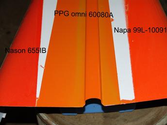

another update on PPG Persian Orange #1 paint #60080.
I was not able to get the remaining PPG toner M130 which is discontinued as expected.
But my local PPG paint guy called the PPG library and was able to get an updated non-leaded MTK 60080 formula that has been created by PPG to replace the leaded 60080 formula. The same PO #1 formula number is used i.e., 60080.
I did not get a copy of the formula but the leaded toners M130 (orange) and M114 (yellow) were dropped and replaced by different toners.
The updated non-leaded 60080 formula is not in the PPG database yet so when a PPG rep looks it up they only find the leaded formula.  Have them call the PPG library and get the non-leaded 60080 formula for your paint.
I got a sample to test out and below is a quick tests.  Let me know what ya'll think of the color.
Posted By: 55allis
Date Posted: 27 Jul 2020 at 3:36pm
Looks really close. Do they call it spectramaster yellow?
Posted By: kelso
Date Posted: 27 Jul 2020 at 3:45pm
55allis,
I did not see the name spectramaster yellow listed.  There is a yellow toner M115 used.
For PPG paint it still goes by the code 60080.

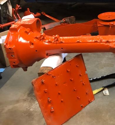

I have been painting a lot since July and below is a photo of my painting tractor parts with the new non-lead PPG 60080.  The lighting does play with the tone color.  This is under fluorescent lighting.
I have most parts painted and will show more pictures as I get the C together.
Tim
Posted By: garden_guy
Date Posted: 02 Dec 2020 at 11:28am
Oh yeah that looks fantastic, thank you so much for the response!

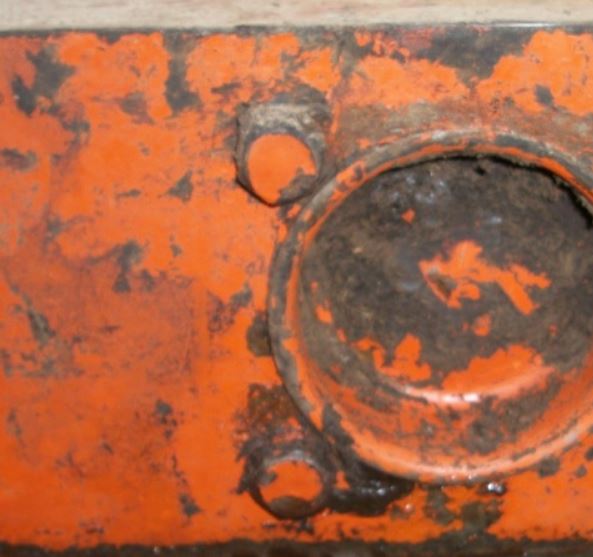

Date Posted: 08 Dec 2020 at 7:30pm
So I did a couple days worth of work trying to peel off layers of grease and dirt and clay from my WD, and I think this paint I uncovered looks pretty much like what I assume it did originally? Or does this seem a bit dark/faded?
Posted By: steve(ill)
Date Posted: 08 Dec 2020 at 7:45pm
I think the ORIGINAL paints did not have the SHINE or BRIGHT that todays paints have.. But i think the COLOR is the same..
Posted By: JohnColo
Date Posted: 08 Dec 2020 at 8:23pm
When I was 5 or 6 I watched a neighbor's B delivered.  As I remember it wasn't shiny orange but it seemed pretty bright orange, would have been 1954 or '55.  Personally,m I like the bright color, it just really stands out and grabs you.
Posted By: Armand(AZ)
Date Posted: 09 Dec 2020 at 7:34am
When we moved down here to Mesa almost 11 years ago, I bought 6 cans of Persain Orange for AMAC knowing it would be hard to get down here.   After using the last can about two years ago I took a sample to my NAPA store about a mile away and she matched it perfectly.   I just picked up two cans yesterday as I paint all of my models the correct color.  I buy aerosol so it doesn't spoil.  Just shoot it into a jar and then into my airbrush.   I can probably get their code if anyone needs it.    Armand
