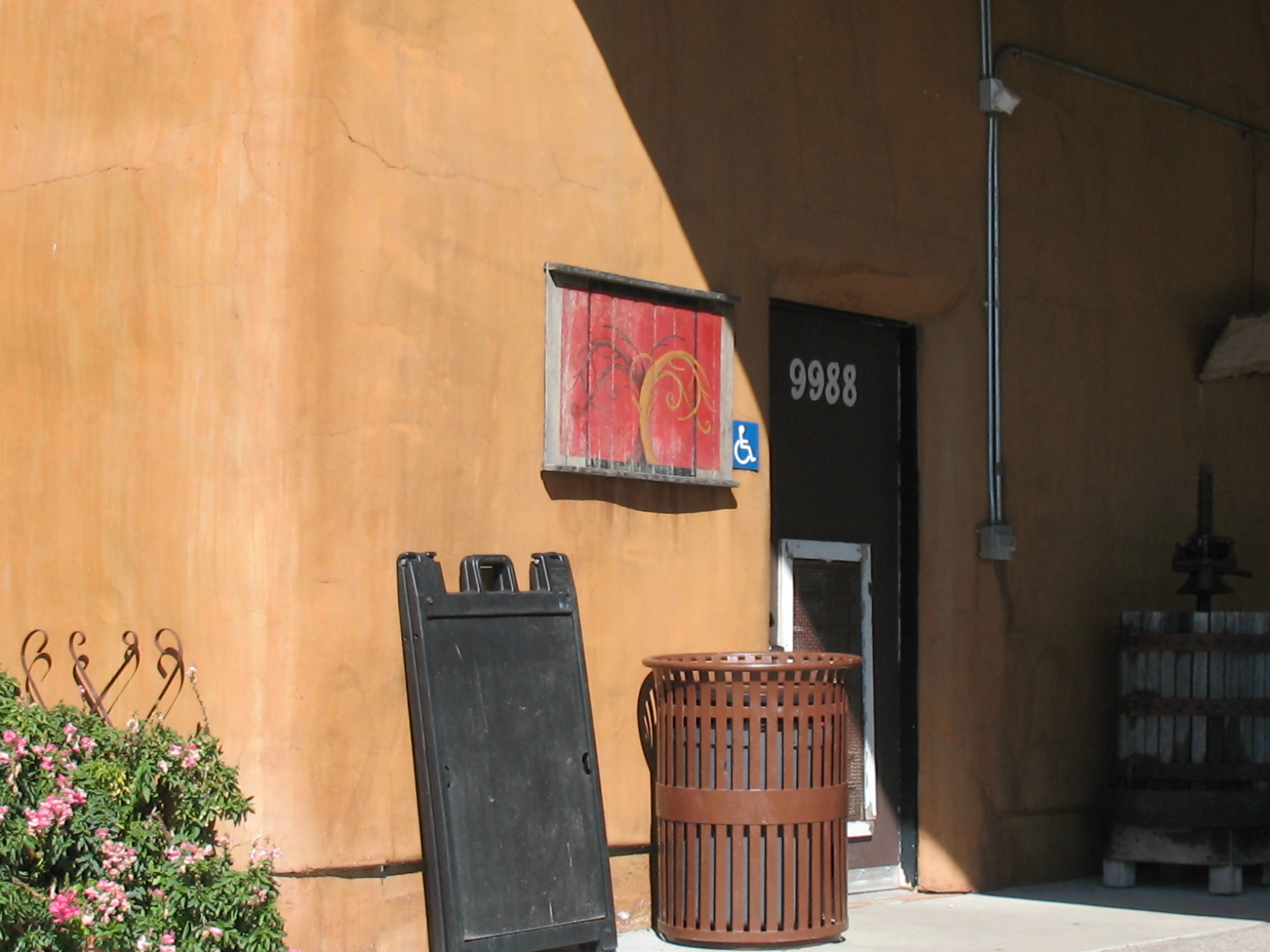

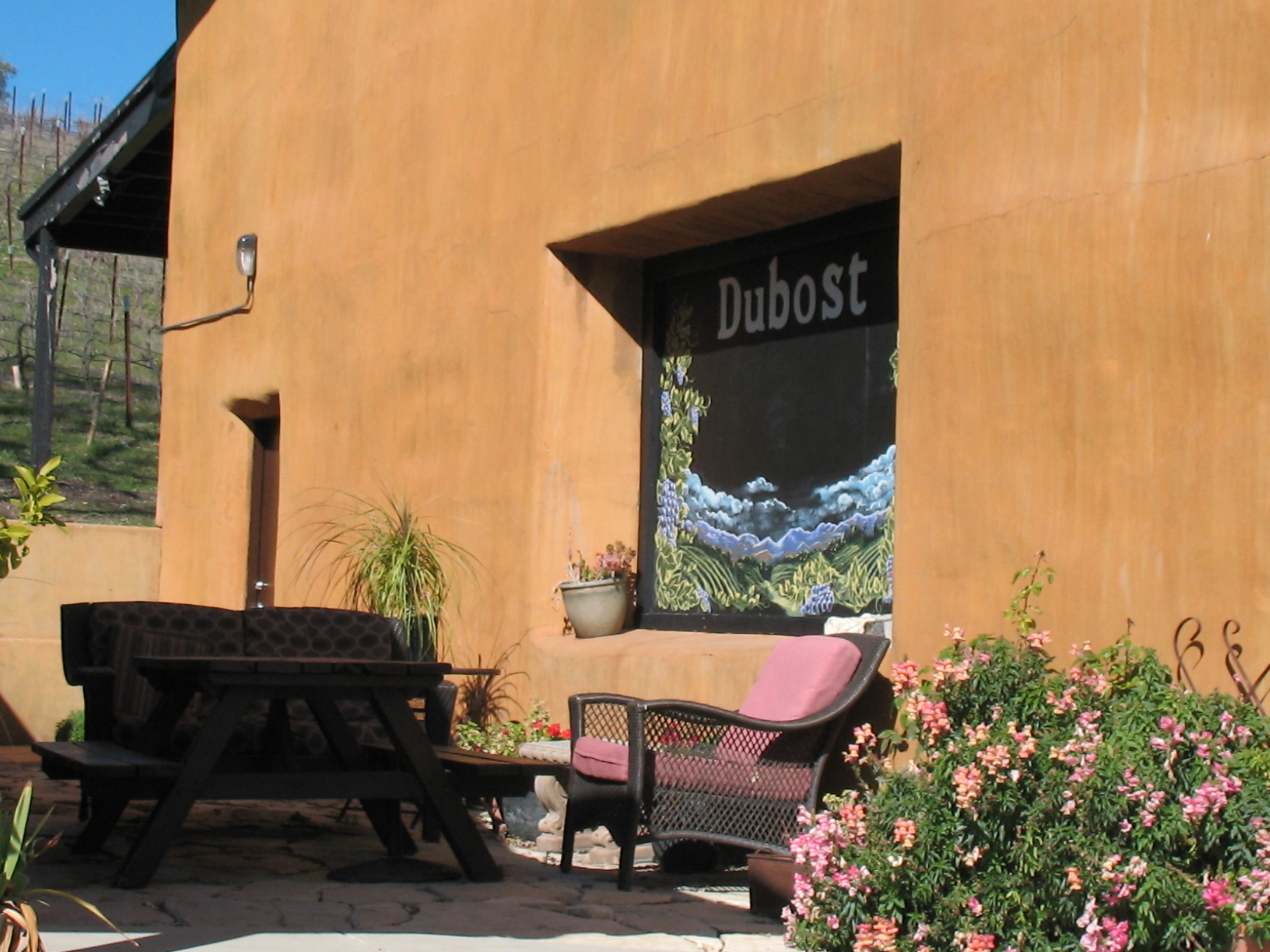

Out here with Fruits and Nuts straw bale building was all the rage just a few years ago. Now I have not seen much in the fake news about it. They claimed mice didn't like rice straw(there claim not mine). I can say it takes a long time to rot away as they had some left over bales they left sitting at the neighbors. But they built pole barn type buildings. Filled the space between posts with bales of straw,covered in chicken wire then plaster. Ended up with a Spanish adobe look on the outside.
We don't ever get much under 20 F out here but get over 100 in summer and the neighbors winery stays between 60 and 80 without any heating or cooling. I will have to ask about fire insurance as we are on the bad list. Got notice my house fire will be canceled because I live among the Confused Fruits and Nuts.

The pole barn with rice straw covered in plaster/stucco. This was left to put a window in  that never happened. All electrical has exposed pipe and conduit,and plumbing is the same but all inside the building. The common bale is 3 strings 15 x 23 ,and you can see the opening is 23 plus the stucco. So the wall is over 2 foot thick.
