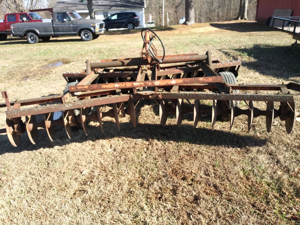

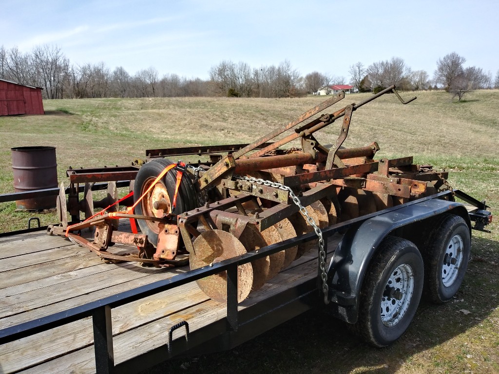

Bought me a new project last weekend. From the manuals I've been looking up it is a model 211 10' Disc. New tires/tubes and hydraulic hose this weekend so I can move it around. 8 blades per gang plus an extra small one on the back. I'll probably replace all blades. All bearings are good but one. I know it will be expensive but I'll just work on it a little at a time. Where will I find correct blades? I've been looking at shoups and I believe I found the correct notch blades I want on the front. Will need various other parts as well. Thanks for any help.
Replies:
Posted By: ACinSC
Date Posted: 27 Oct 2019 at 2:08pm
Agri supply seems to have quite a few discs . Not sure if there's one close to you . Thanks
Posted By: Sugarmaker
Date Posted: 27 Oct 2019 at 5:12pm
Blake,
 Congrats on the disc! The 45 is looking good!

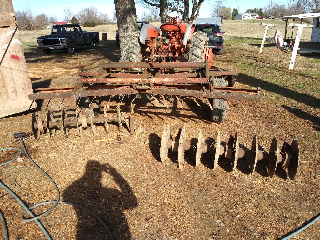

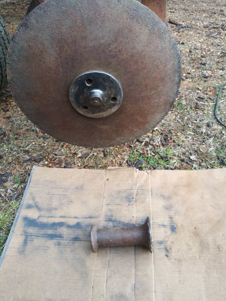

Date Posted: 03 Nov 2019 at 1:24pm

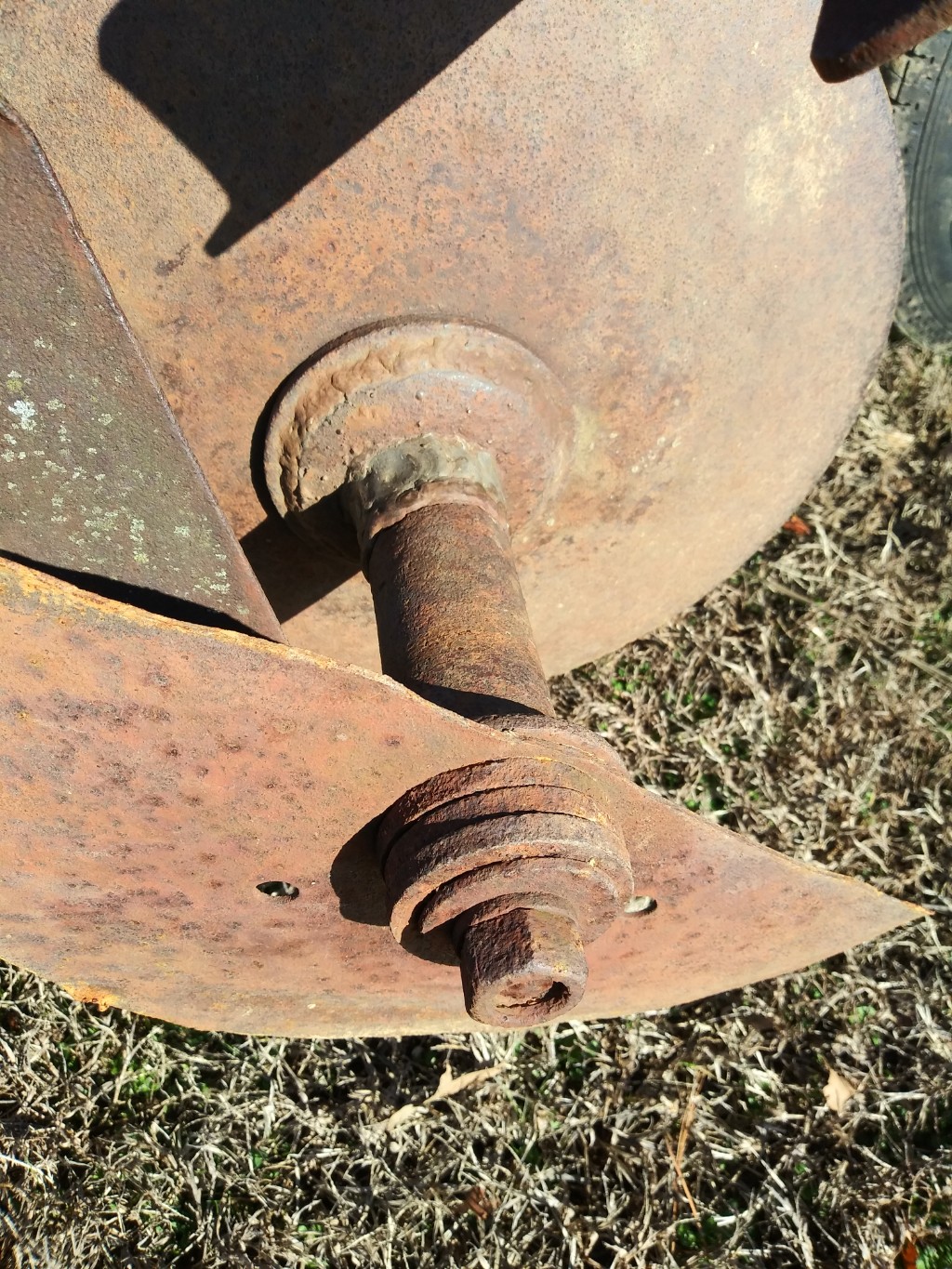

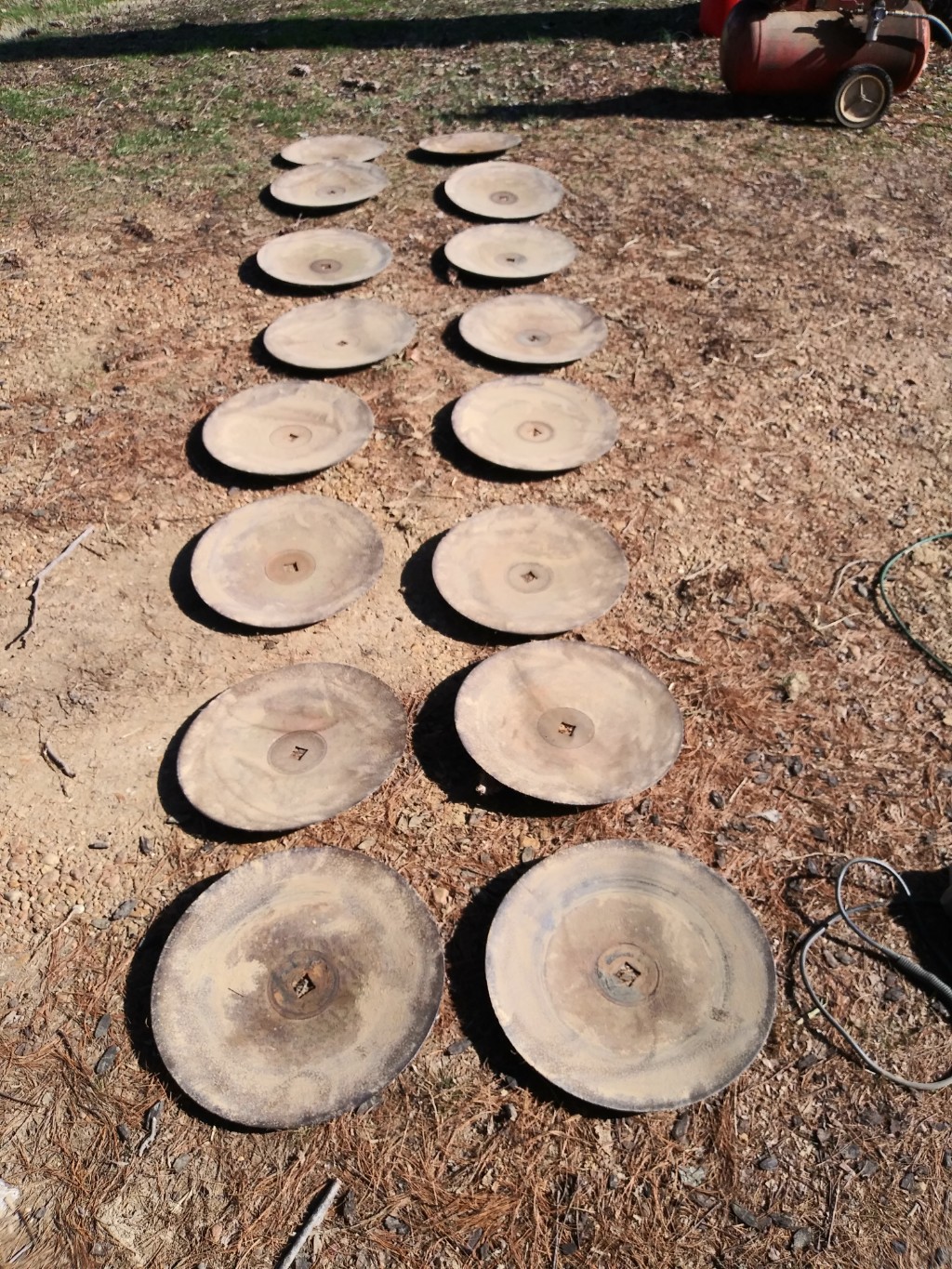

Been tinkering with disc some. Got one gang on front apart. It appears none of the blades were original. Tightened and packed the wheel bearings today.

Received both of these NOS blades from Sandy Lake today. Now I'll know for sure exact measurements I'm looking for to get replacement blades(there wasnt enough NOS for a set).

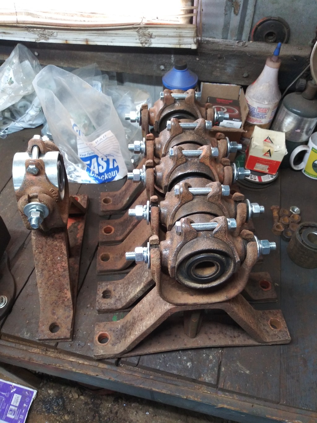

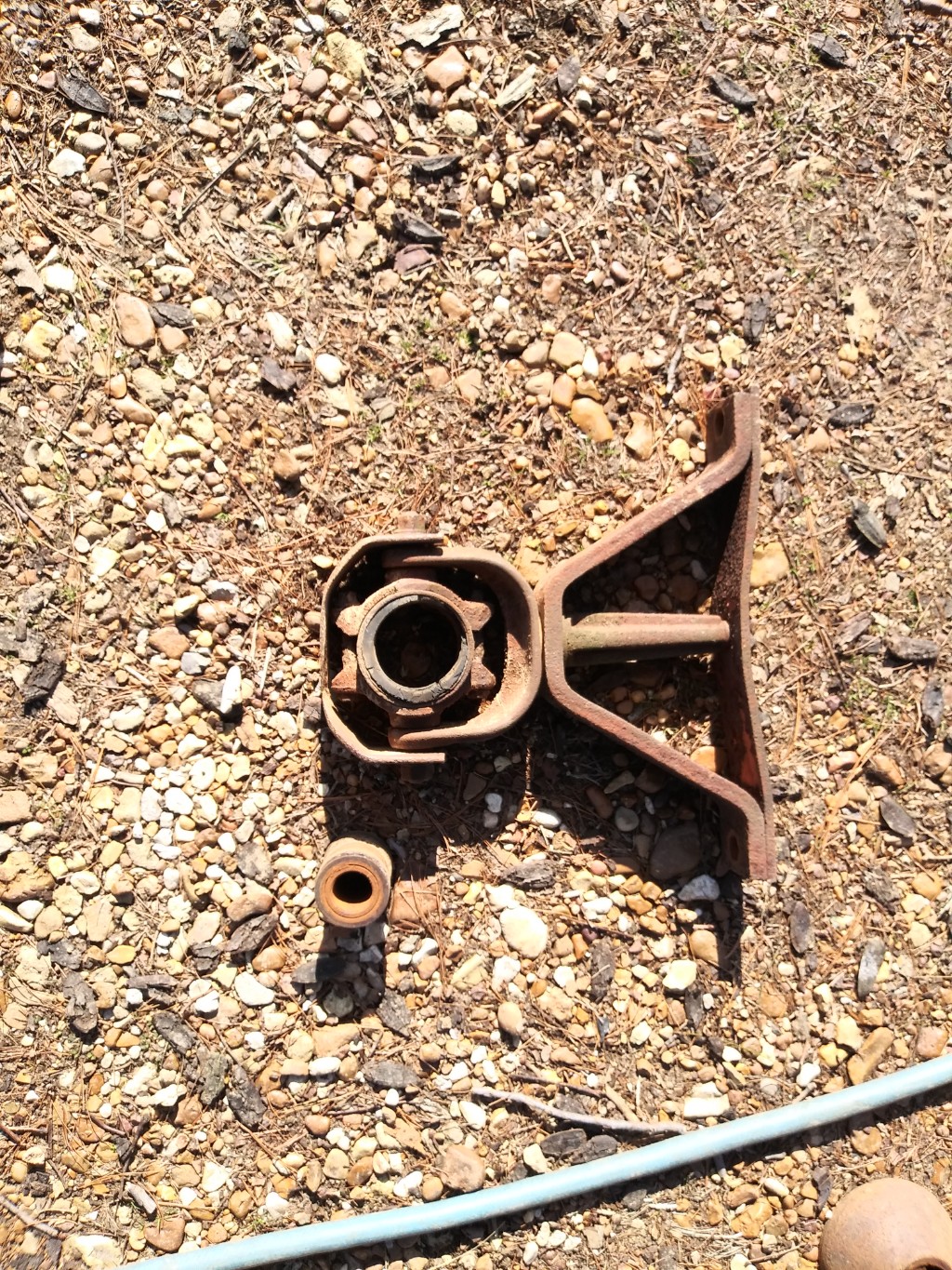

Not much progress today cost myself money mostly. Found 2 NOS bearings by theirselves online. I pushed one into a shell today. The WD wheel felts like in another post would not work for me and I ordered 4($31).I greased them up good and finally got them in. It made everything so tight I couldn't turn the side bushings with it in a vice using vice gripes to try and turn it. Took those back out filled void full of grease and installed the outer seals. I've never had a proper seal driver and never had a problem installing seals until today. I bought 6 seals I ruined 4 of them(and they ain't to cheap).
Posted By: john(MI)
Date Posted: 26 Dec 2019 at 4:40pm
Buy some cut offs of pvc pipe at HD, as many sizes as they have.  They usually have some cut to a couple feet.  Cut a piece off for whatever size seal you are driving and you have a bunch of spare seal drivers left over.  It's hard to mess up a seal with a plastic pipe.
Posted By: 79fordblake
Date Posted: 26 Dec 2019 at 4:44pm
Good idea. I'll look around this weekend for some. I also got the other front gang apart today. 2 locked up bearings....ugh. I'm already in this disc over 1,000.

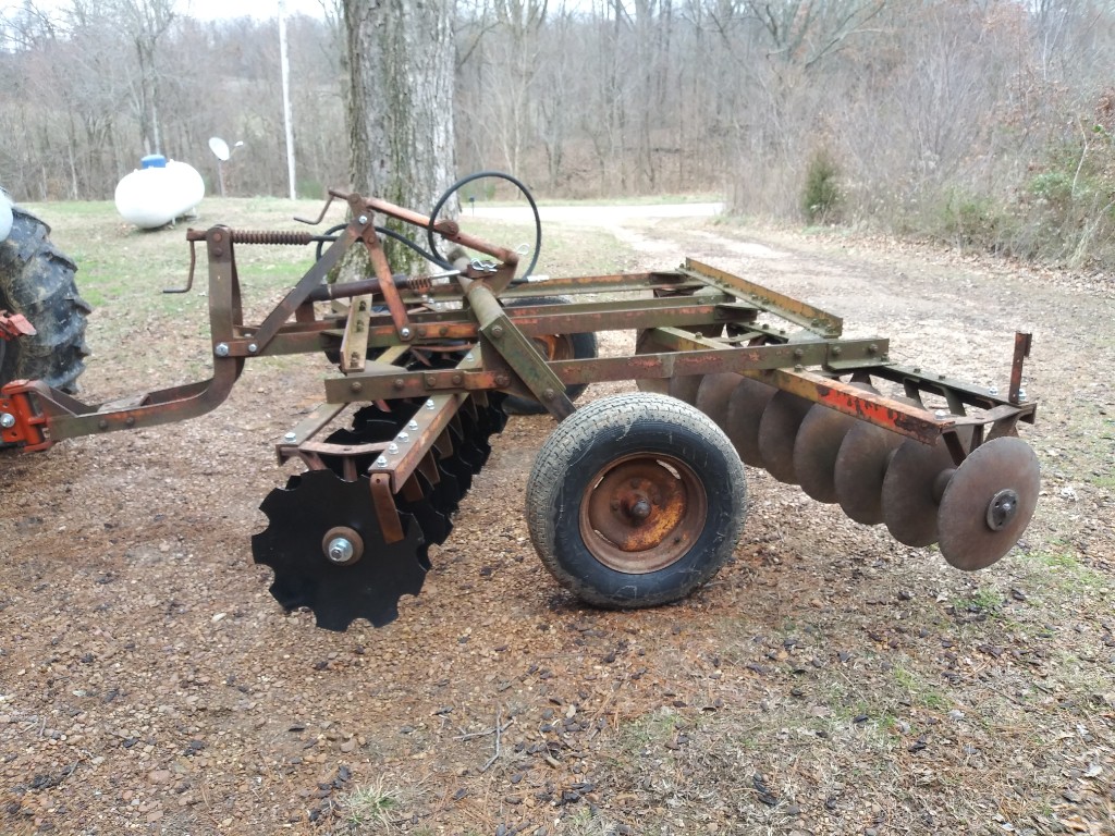

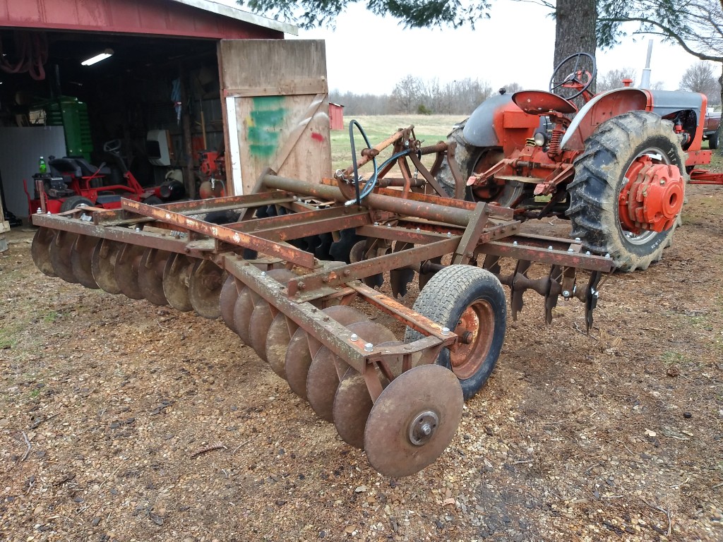

Well I have both front gangs back together finally. New blades, bolts, 4 new bearings.

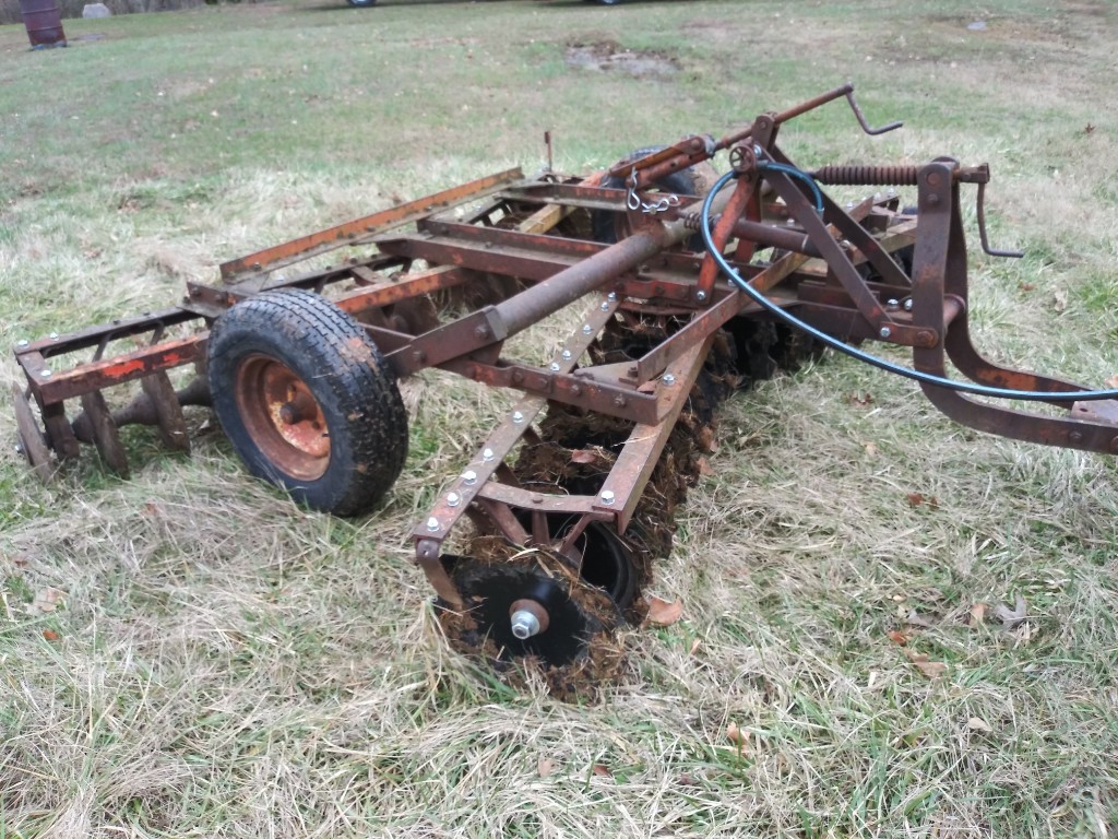

It was a mess when I first brought it home.

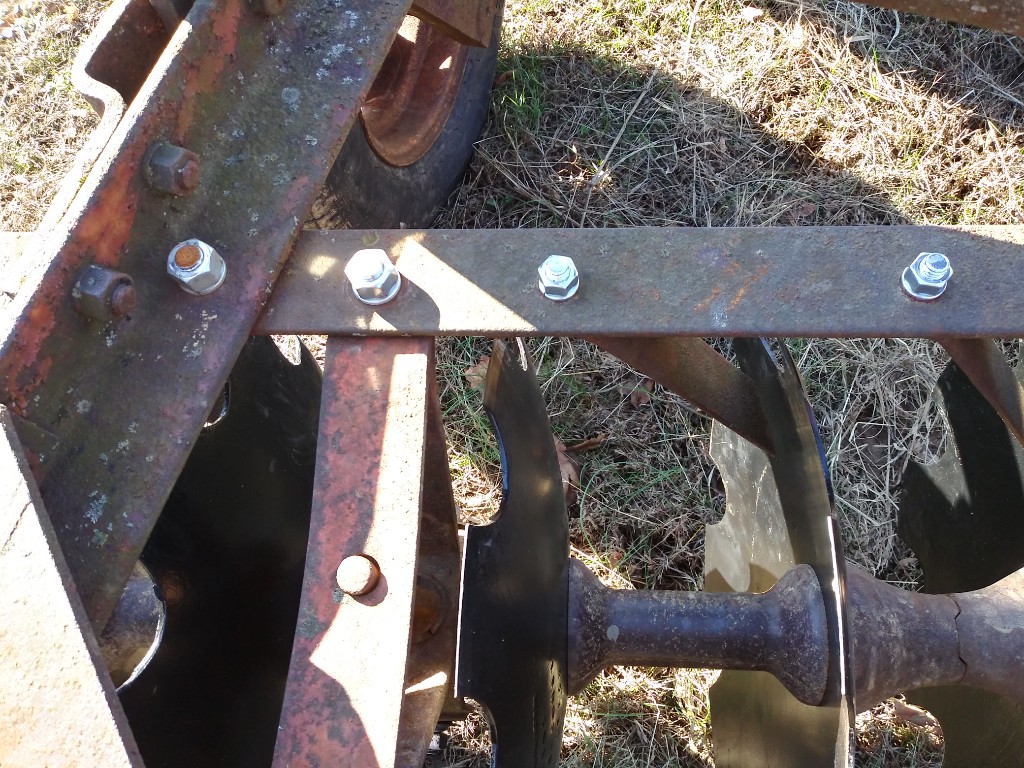

Date Posted: 19 Jan 2020 at 11:55am

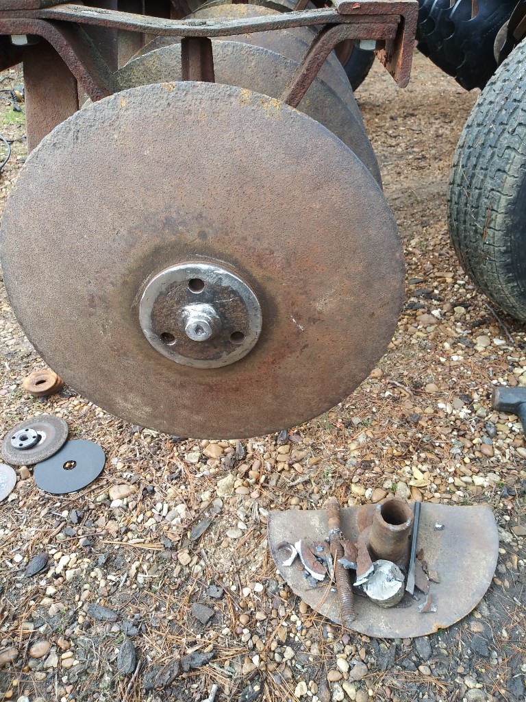

I don't think I have any choice but to carefully cut these off. I don't believe these are real furrow eradicators anyway. Look nothing like the ones in the parts book.

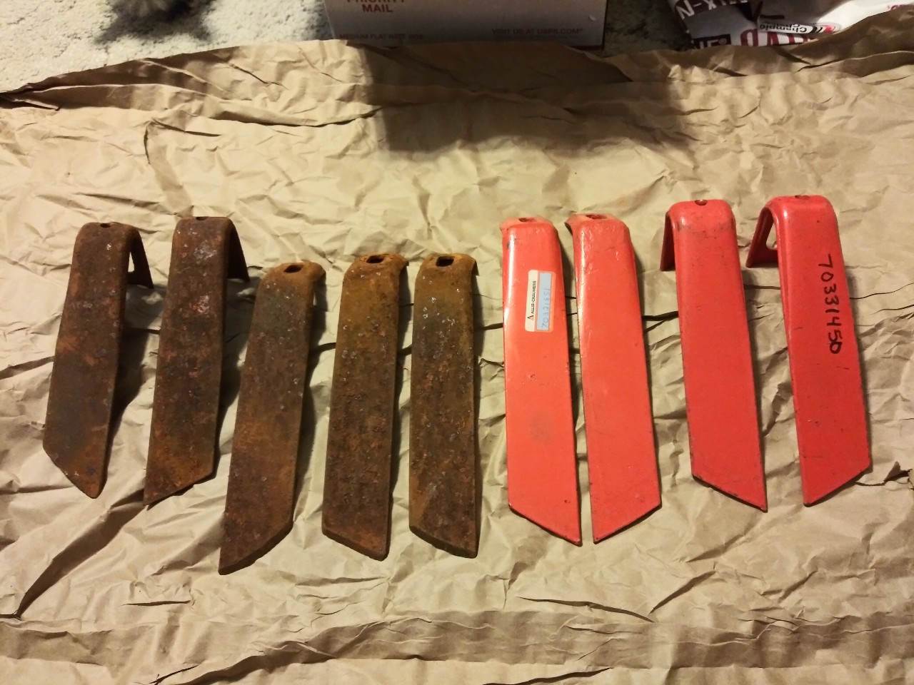

Date Posted: 19 Jan 2020 at 2:03pm

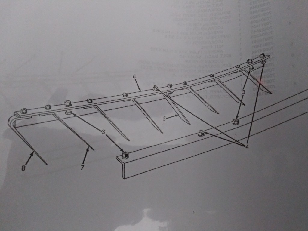

Went out today and straightened and adjusted all the front scrapers. I need one each of #5 in the picture for the right and left. Left #70331450. Right #70331449. I also need 3 rear scrapers. (2) left #703211851. (1) right #703211850. [IMG]uploads/3175/20200119_133856
Date Posted: 24 Jan 2020 at 3:08pm
Found some good used ones from L&L Parts in Minnesota and some NOS ones from Sandy Lake Implement in Pennsylvania.

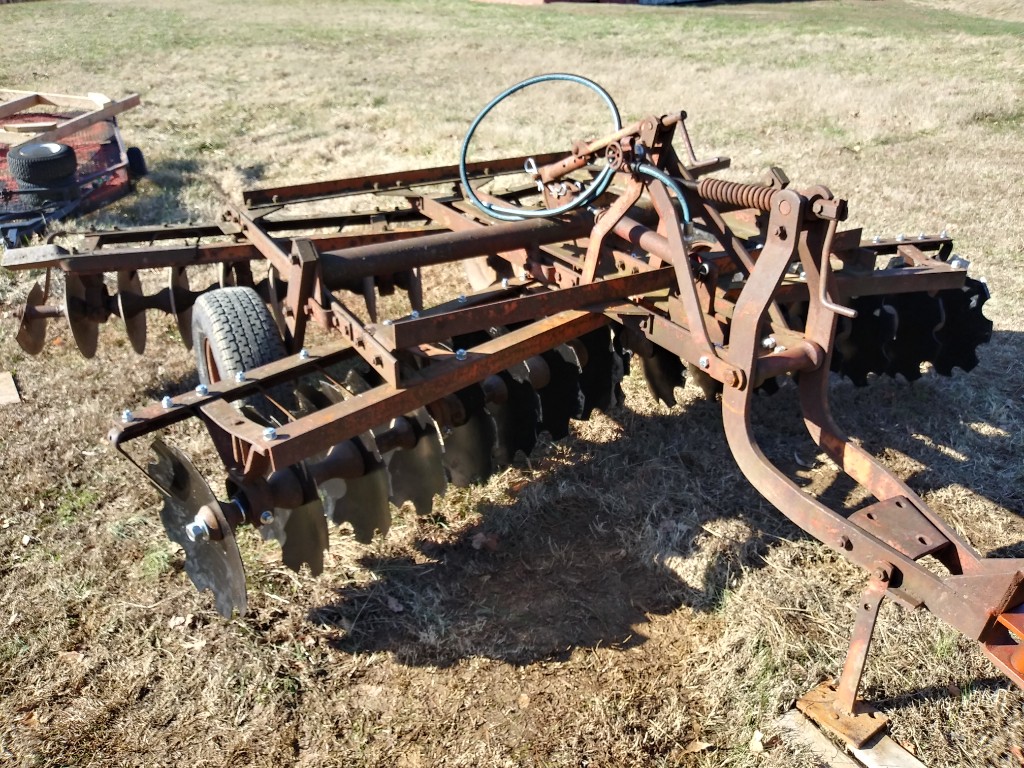

Here's what I have for ridge reducers on my Snap-Couler #109 disc.  I've got them on both sides on the rear gang.  They are bolted on and appear to be OEM.  It was like this when I bought it.
Right side...
Date Posted: 25 Jan 2020 at 1:22pm
Brian those are correct by the parts book. Mine are not except for the parts to the scrapers. Somebody welded these on. I'm cutting them off tommorrow if weather is good.
Date Posted: 26 Jan 2020 at 1:13pm
Well I got the makeshift eradicators cut off today. What a pain in the butt. Looks a lot better. Very wet out today but I decided to make a few passes in a grassy area. Looks like the new 18" notched blades on the front will cut just fine. They are 1 3/4 concavity. Little more than original but after walking back and looking through the ground the brush and grass was chopped very well. Now on to rebuilding the back gangs...

Just curious, but what size tires do you have on that disc?

The tires are 215/75/14 and seem to have worked out just right. To tighten the gangs I used a large pipe wrench on the end backing plate to hold it still. After I snugged it up some everything quit spinning and it tightened up. I tightened the nut with a 1 1/2 wrench. I ordered some more NOS parts today for the hose support. I'll post pics when I get them in.

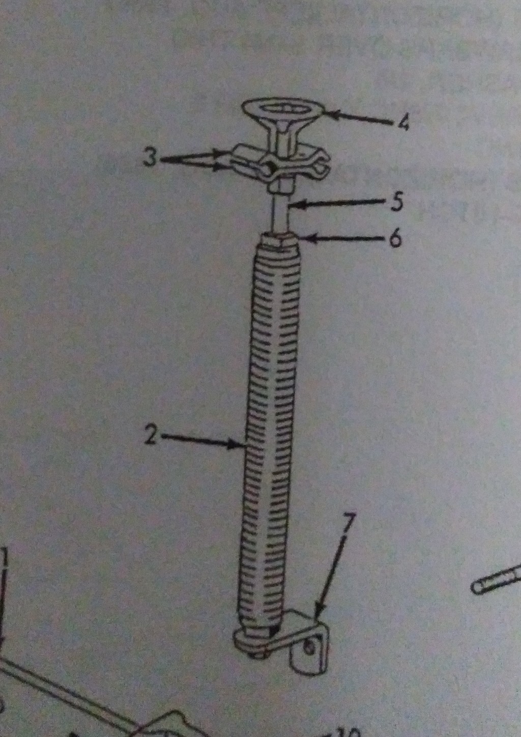

Date Posted: 30 Jan 2020 at 2:17pm

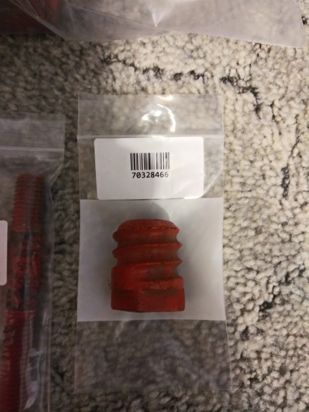

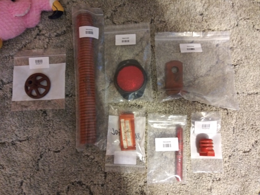

Received more NOS parts today. I need 1 more of #70328466. Don't mind the dog's flamingo in the top left.... Lol.
Posted By: Brian F(IL)
Date Posted: 31 Jan 2020 at 8:06am
Okay, I'll bite.
What is the purpose of part #70328466?  Does it fit into the end of the spring for some reason?
Date Posted: 31 Jan 2020 at 8:52am
Yep that's correct. Hopefully I can find one more somewhere.
Date Posted: 02 Feb 2020 at 2:01pm
I feel like I been down this road before.....lol

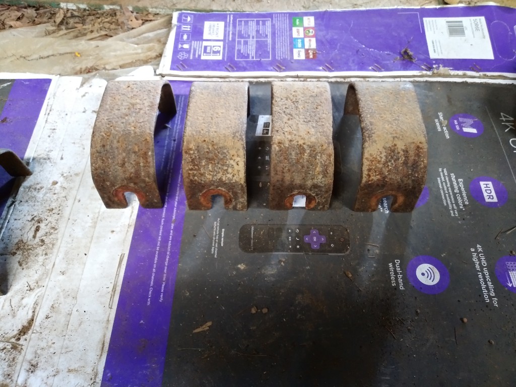

Got the back gangs apart today. All bearings good but one. Anybody need the old blades?
Date Posted: 09 Feb 2020 at 2:26pm
All the bearing assemblies for the rear gangs are back together now. Now just a few parts left to find and it will be a 100% complete disc and I'm never doing this again.... lol. I have all the bearing proctectors but I want them to all be in the condition like these 4 I have. The rest are very worn.

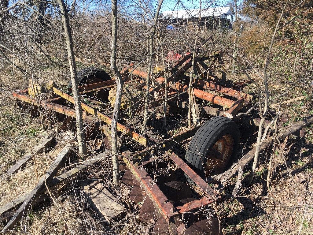

Date Posted: 21 Feb 2020 at 6:41pm
Well I haven't messed with the disc in a little while but.......in the morning I'm going to buy another one...lol.
Date Posted: 22 Feb 2020 at 1:41pm
Well here is what I came home with...lol. I haven't checked it out yet to see what all is good. I'll be parting it out and using parts on the other one I have and storing up what is left.
Date Posted: 23 Feb 2020 at 7:53pm
Tires are not the greatest but they did air up. Wheels are rusted out around valve stem. This one has 15" wheels. The other one has 14" wheels.
