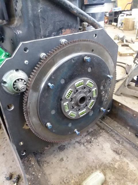

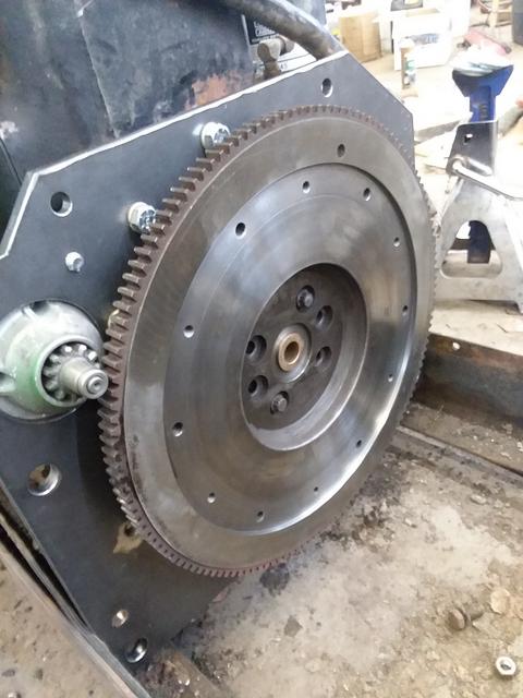

Posted By: Peterson
Date Posted: 27 Apr 2019 at 9:36am
Ok guys got the fan hub adapter made. Now to drill holes and bolt it up.

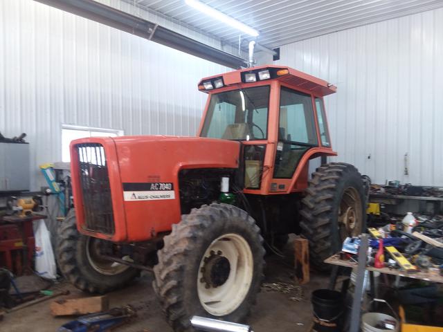

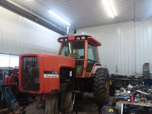

Posted By: Peterson
Date Posted: 28 Apr 2019 at 8:37pm
She has no legs! Hopefully get the engine out tomorrow.

Posted By: rieg
Date Posted: 28 Apr 2019 at 9:20pm
I thought I was the only one that keeps a stump in my shop to hold up the back half of an 8000 series for when they need split. I have used that same stump on three different tractors one twice. Crazy farmers!!!

Posted By: Peterson
Date Posted: 29 Apr 2019 at 8:39pm
http://www.directupload.net" rel="nofollow">
She is out. Got adapter plates off both engines. Hopefully bring them to machine shop Wednesday.

I thought the rear plates had the same bolt pattern.
Posted By: Peterson
Date Posted: 01 May 2019 at 9:59pm
Crank flange, yes. Rear engine bolt pattern, no.

Ive been doing piddly little stuff waiting for the flywheel. Instead of using the dual small spin on fuel filters, im going to run the 8000 series big filter from the 426. Had to make a bracket so it would fit. Still need to bend up some new fuel lines though.

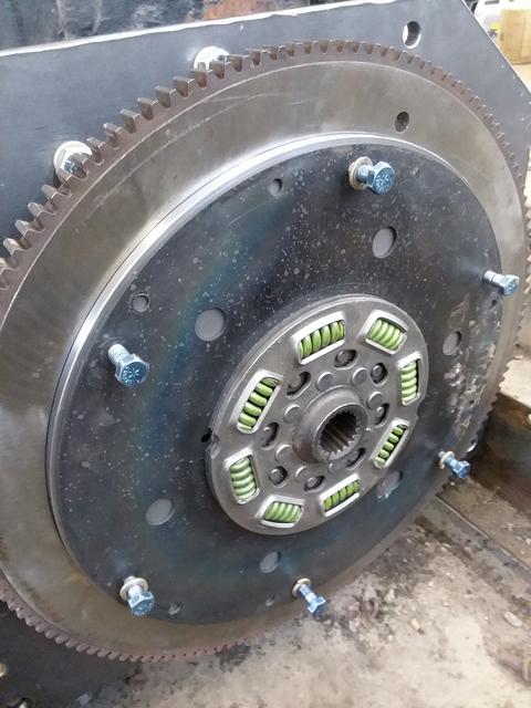

Hey guys, got the flywheel back. Woulda had it done sooner but my original machine shop pissed up the 516s flywheel, so i had the 426s modified to work for the 516 from the shop that made the adapter plate. He did a awesome job!
The mods to the flywheel are, the back side crank pilot had to be cut back .25". The ring gear had to be moved .150" towards the bellhousing, same with the pilot bushing, because the crank standout is .150" less than the 426. Then instead of using a torque limiter, i went with the torque damper from the N7 and had the Powershift hub installed. Then a 1/2" spacer plate under it to bring it more towards the bellhousing/input shaft.
More to come later.

Posted By: Peterson
Date Posted: 08 Aug 2019 at 3:34pm
She is bolted in!! Now onto welding frame rails and making the rest fit together!

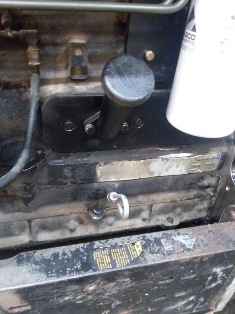

Posted By: ACjack
Date Posted: 09 Aug 2019 at 7:48pm
Interested in what appears to be the data plate mounted on the block by the starter motor location.
During the time I worked there (70's) that "large" plate was only used on the commercial product engines and not on any interworks "IE" engines produced for other AC plants. The larger plate (length) not only had the engine series, engine catalog number and S/N but, also the catalog numbers of all the option groups ordered at the time of build. If that engine came out of a combine produced during my time at the Harvey plant it would only have the smaller ID plate which was the same height but, only about 3" in length and only gave the engine series, catalog and S/N.
Could you post a picture of it?

Posted By: orangereborn
Date Posted: 10 Aug 2019 at 12:12pm
More to come later.
...So how many of the flywheel mods could have been avoided by using the original planned 516 wheel??  Had you planned to use the torque damper/power shift hub concept originally?  Thanks for sharing...Dale
Posted By: Peterson
Date Posted: 10 Aug 2019 at 12:35pm
Yes i was going to use the same torque damper. 516 flywheel needed the ring gear moved, 1/2" spacer plate and the input bushing made too. So pretty much the same amount of work between the two of them. But would have had a much heavier flywheel.

Posted By: Peterson
Date Posted: 11 Aug 2019 at 10:35pm
This is all thats on the engine data plate.
Sorry nothing else to update you on guys. Been making 2nd crop.
7095-685I at 255hp, 8070-225HP,8050-210Hp,8030 with 155HP,220 with 670T engine with A-pump, 7580, 185 with 140HP, 2-6080's,6070, S4 D17,wd45,CA,st34 agco, S1 D17 with 3500MK2
Posted By: ACjack
Date Posted: 12 Aug 2019 at 10:00am
Thank you for posting the data plate picture. I had no idea that they started to use that style plate on interworks engines. Must be something they started in the 80's.

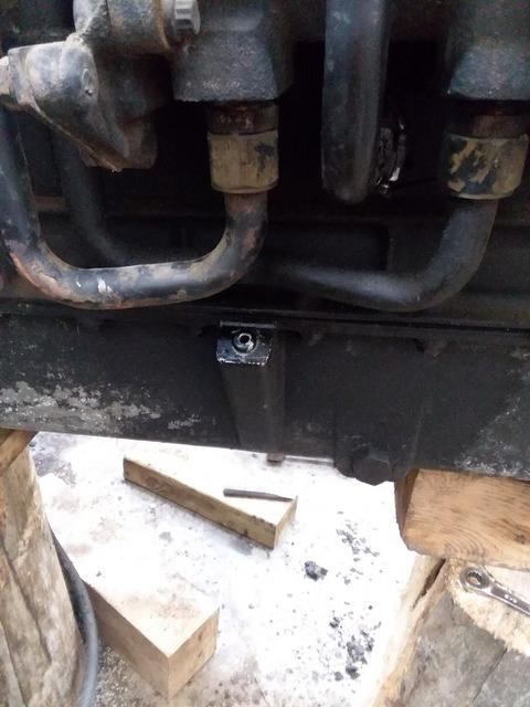

Been working on little stuff between making 2nd crop.
Didnt like the goofy righthand side dipstick.
Opposite side has two ports for different dipsticks. So i popped one plug out and tried the 426s dipstick, and it fit and worked great!

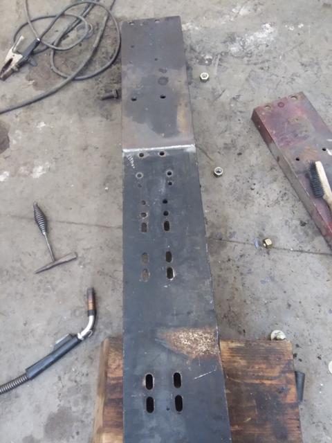

Also started welding up the frame rails. Not done yet.
Posted By: Ron(AB)
Date Posted: 14 Aug 2019 at 9:41pm
Good thing you have that small starter!

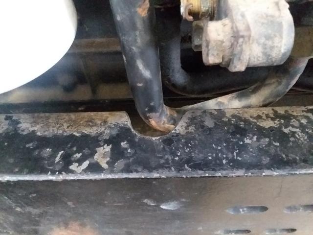

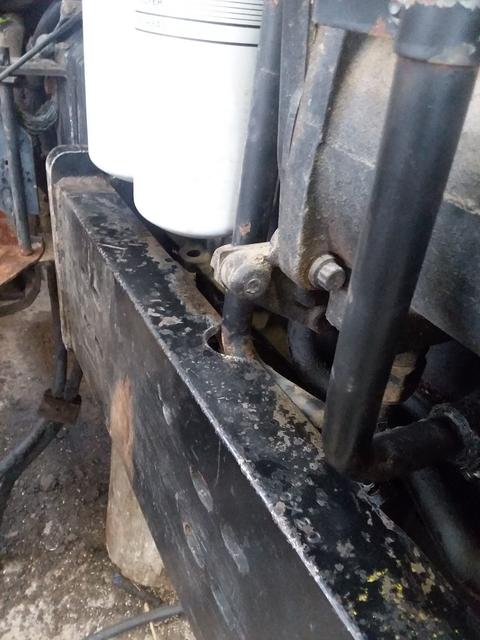

Doing a little trimming of frame rail to fit.
She is slowly coming together.

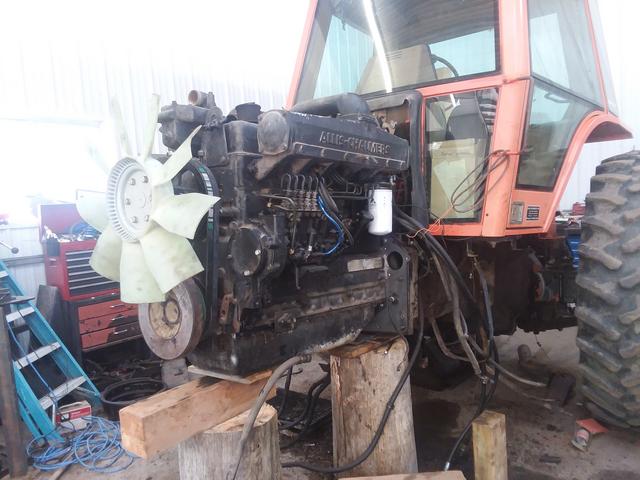

Wanted to show you guys KINDA what its going to look like.

Drilling axle mount holes, had to throw the side panel on again and get a picture! Lol
Posted By: Kevin in WA
Date Posted: 23 Aug 2019 at 8:32pm
Is the intercooler going to fit inside the hood? or are you going to put on an HD11 intake manifold?
Posted By: Peterson
Date Posted: 23 Aug 2019 at 8:34pm
Hood will be widened out. Haven't decided how yet. But engine will be pretty much the same as a N7 combine engine.
