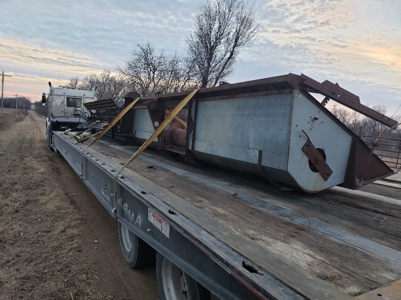

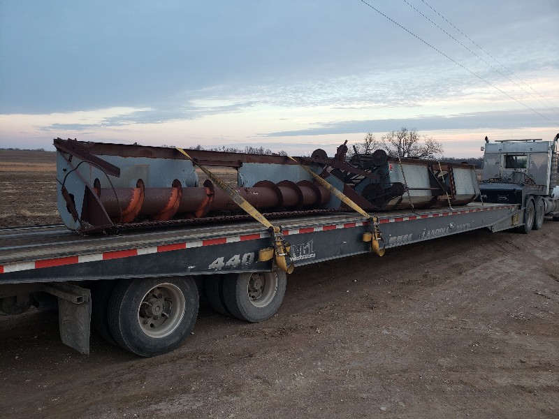

Date Posted: 06 Dec 2018 at 9:33pm
Bought a straight A 14 ft head. While walking around, I found an A2 14 ft head. Next winter project, build the A2 header.

Posted By: Don(MO)
Date Posted: 07 Dec 2018 at 7:26pm
I helped Bob unload the two heads first thing this morning with my D15 fork lift (it was cold that time of the day too) heads didn't look bad to me. Bob is not going to get to his WD45 Diesel for a sometime on down the road with all is new toys. This is the way Bobby go's at all his work wide-open!!!!
