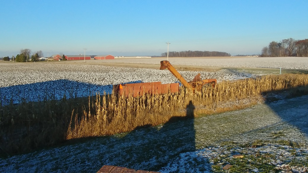

In the process of saving another AC from the scrap yard. Tractor/picker are located about 3 miles from my place. Tractor/picker sets on a cement pad located behind a barn. I can remember as a middle school student (10+ years ago), riding by on the school bus seeing just the elevator sticking up from the brush. I received permission last fall to walk back behind the barn and take a look at it. Been asking the old gentleman ever sense about selling it. The gentleman finally informed me this week he was ready to sell it. Here are a few pictures. Will upload more when I finally get it home. May need help identifying if the picker is a model 33 or older.
1953-WD45, 1949-G, 1950s Snap-Coupler All-Crop Drill, 1956 Roto-Baler, 1945 All Crop 60, Snap Coupler Subsoiler, Plow, Gleaner F, 505 wagon

too bad he didn't move it over a bit under the roof.  Looks pretty straight.   Did you check if it was stuck?  Is the center snout around there somewhere?
If you buy it try to find as much about it as you can from the old gentleman- like everything it probably has a story.

Sure would have been nice if the exhaust was covered and it was under a roof.  Oh well, they can be rebuilt and made new again for not a whole lot of money.

 Looks to be a 33 picker, I would not go much more than 500 or 600 on it, probably stuck, will need tires  I has one on a WD and paid 1800 for it but was ready to go.  I sold it after several years because it just took up too much space in my shed and did not use it but once a year at most.  See if he has the front snout also

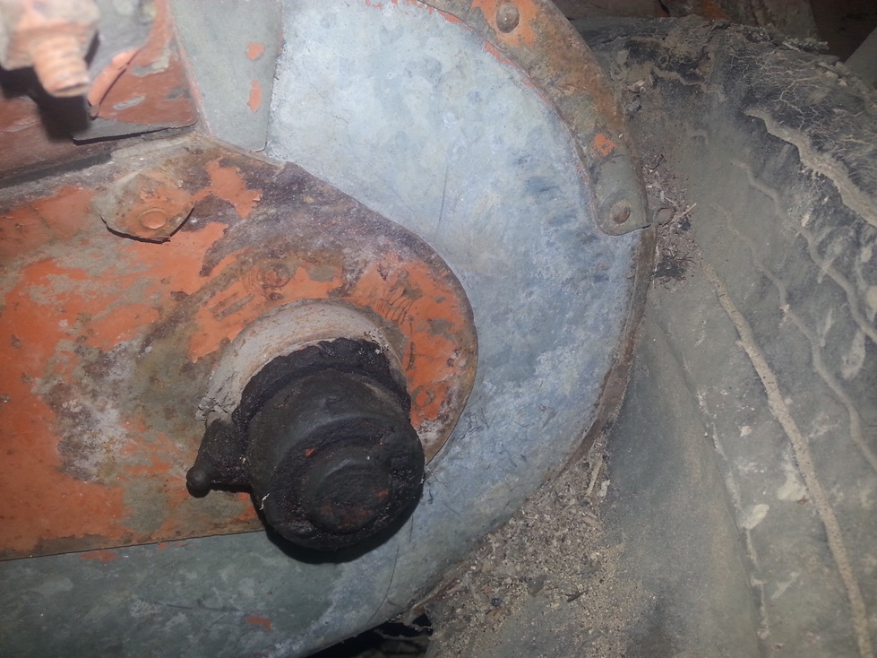

I just looked at the PA WC. Missing left side snout, and both fans. The one your looking at is in far better condition. I can see were parts would be an issue. But the PA WC has the right side snout you would be looking for.

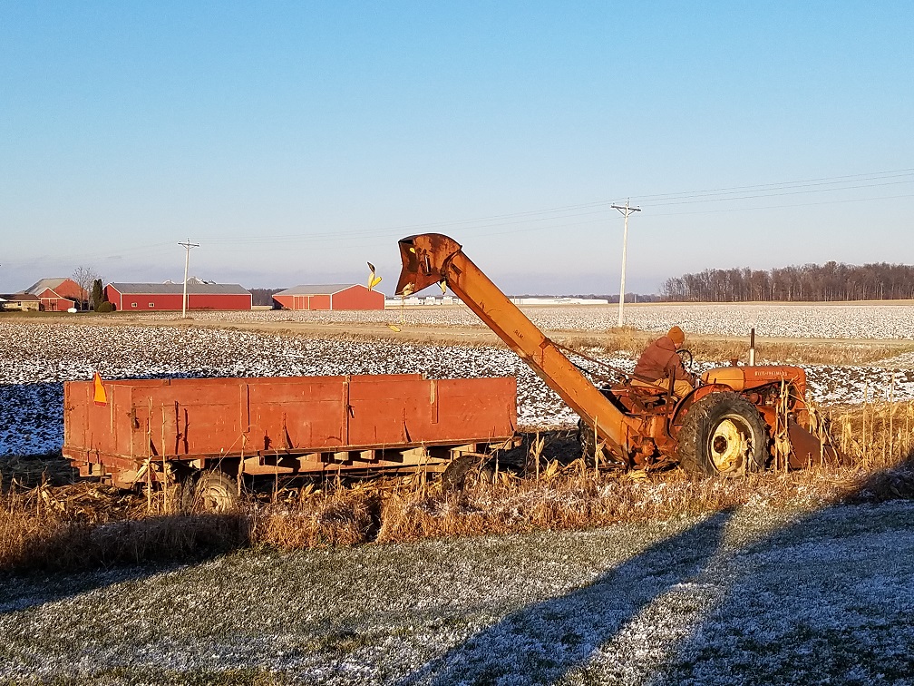

John, I believe the tires are mounted that way to get the correct width for wide-row corn planting spacing.  You would reverse mount the wheels to get the correct spacing for plowing.
It hasn't been used in many years, but here is our family's 1936 WC with the tires/wheels in the reversed position.  Someone else may correct me, but I believe that's why the tires are position as they are...

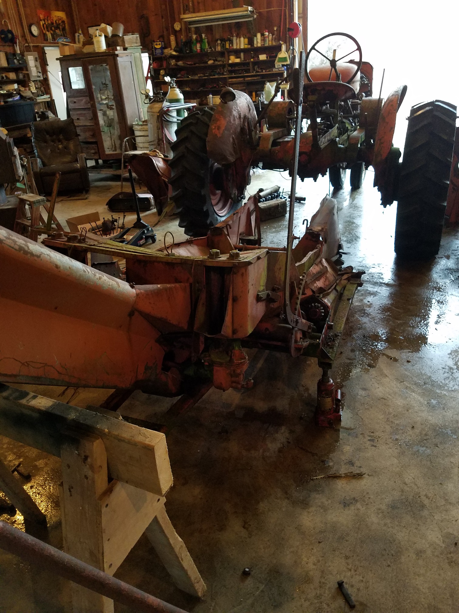

Getting ready to tow her to her new home
Pulled tractor into neighbors shop. Motor was stuck so though we'd better pull the head and see what mess we were getting into. Did not look very promising
Then we found a hole. Not sure if this was why the tractor was parked?

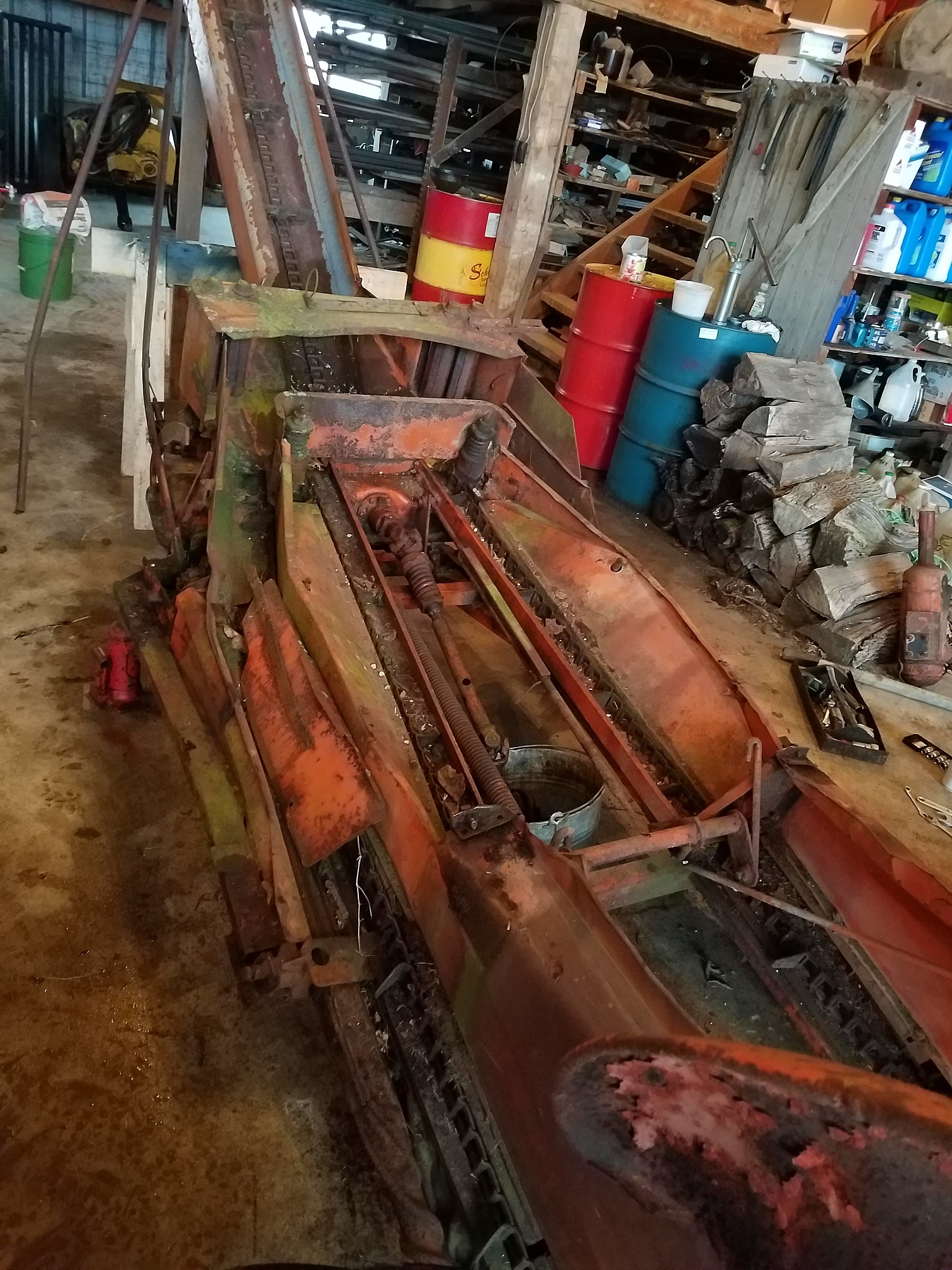

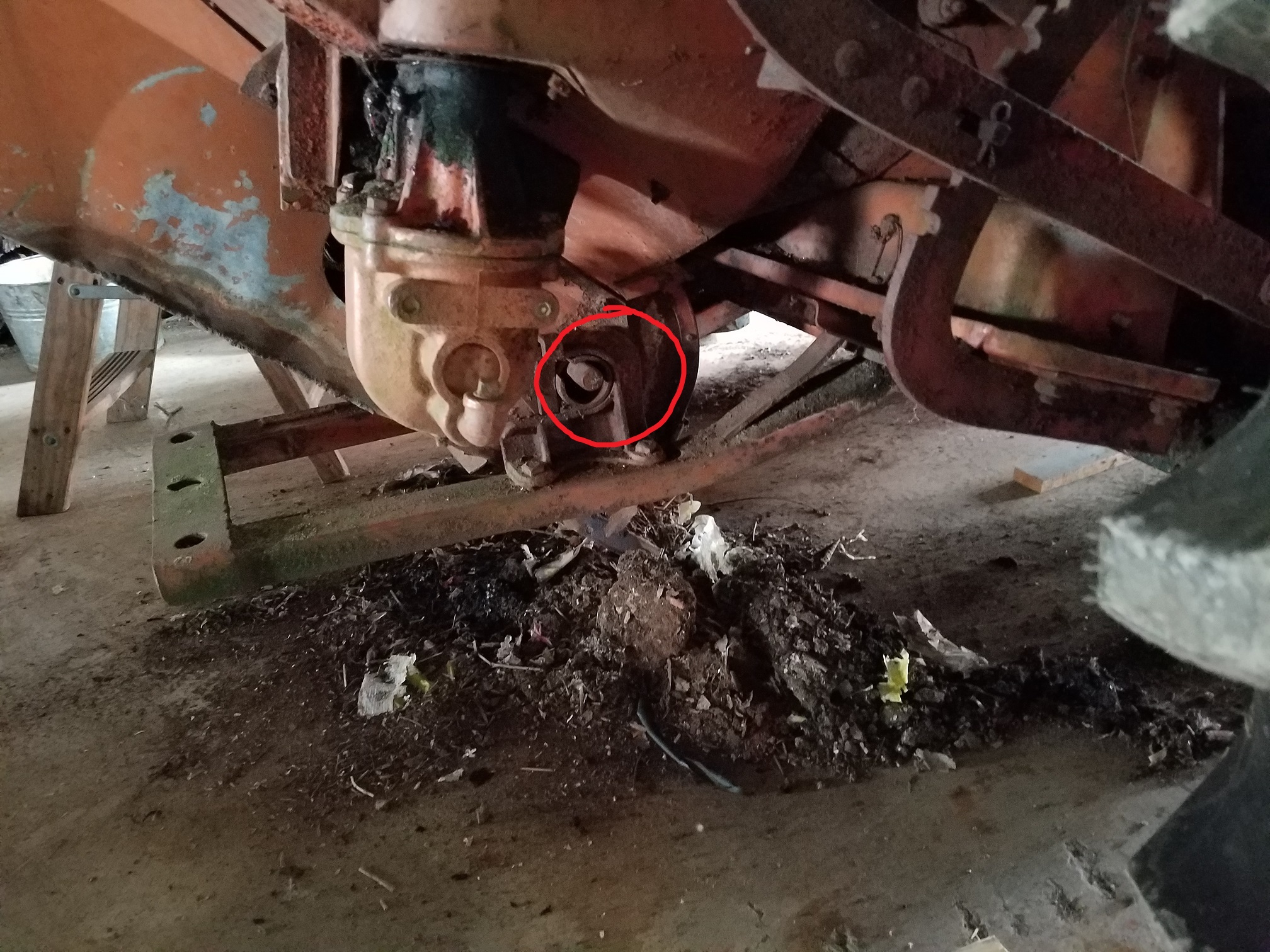

Also noticed what I believe is a transmission 'cut-out'? Believe from what I read this will allow you to cut power to rear axle on the fly and allow pto, belt pulling to continue turning, however you need to push the clutch in to reengage power to rear wheels if I am correct.
Currently I am weight for a manual so I know how to remove at least part of the picker. I've nover rebuilt a motor before and currently its hard to justify the cost of a rebuild when I have a motor setting. Plans are to drop a WD motor in as I have a good running one at home in a parts tractor. I need to make sure transmission/clutch are in workable condition before pulling motor. I will continue to update this thread as progress continues. Happy New Year to All!!!

Someone else will correct me if I am wrong, but I believe that you should have a hand clutch as well as a foot clutch... hand clutch would cut power to wheels but nothing else, foot clutch cuts out power to everything.

5.  Hope you can find the "snout".

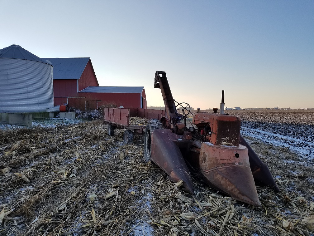

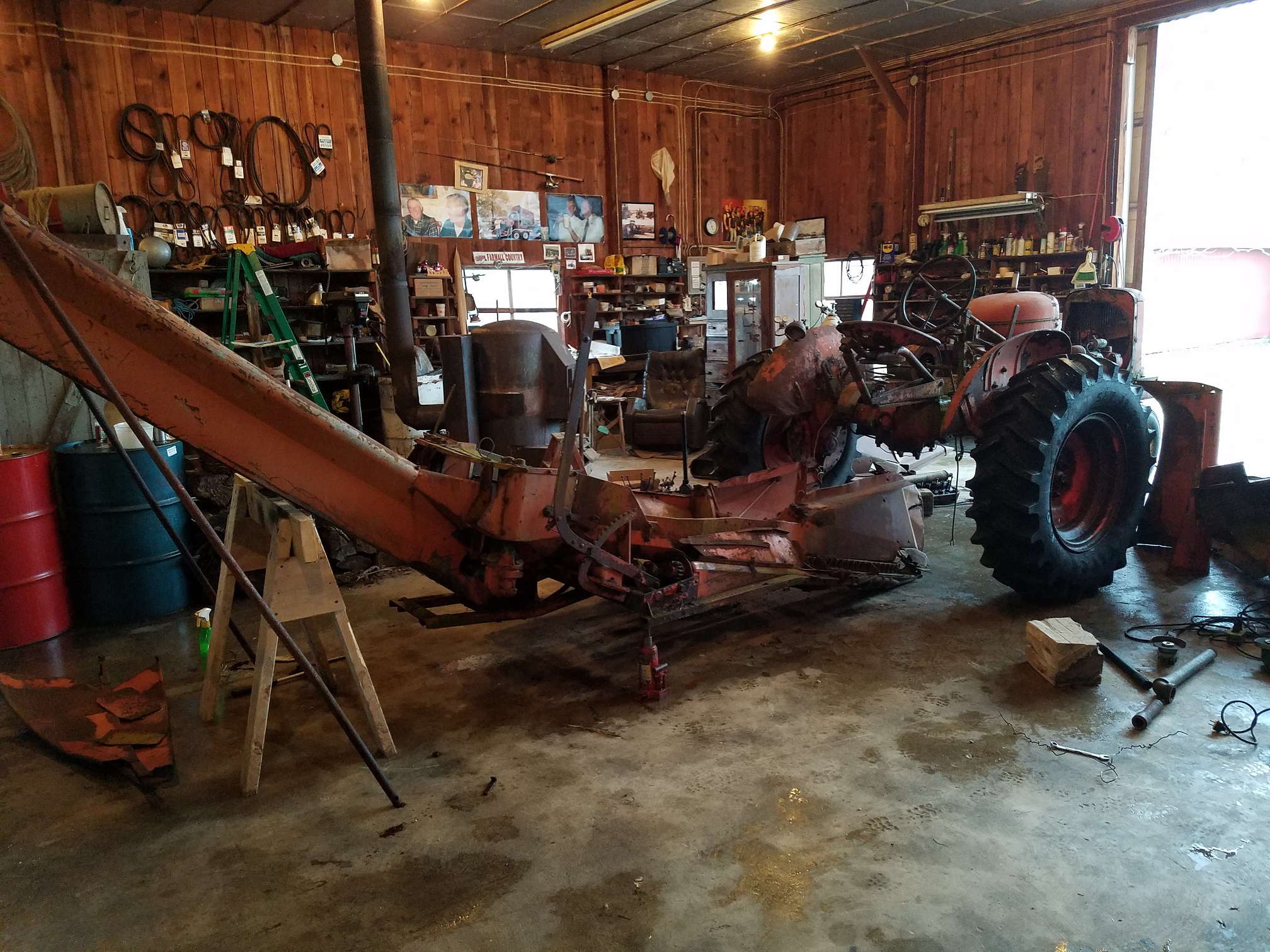

Figured I'd give an update on the tractor/corn picker salvation. Been an off/on project this winter as the Mrs. wants some remodeling work in the house done. Best time to work on the tractor is when she's at work I will try to get some photos up once the picker is 'alive' again. Many thanks to my neighbor for letting me take over his shop this winter!
For the tractor: Pulled the motor and clutch and replaced them with parts off of a donor tractor. Water pump was seized, radiator not the best. The "reverse" lockout on the shifter was seized, taking the shifter semi apart was a new learning experience to say the least, good thing for this Forum else I would have been lost! Tried to reuse as many parts/tin as I could to keep the original look. Motor is up and running. Just installed shifter last evening. Hoping to take a drive later this week
For the corn picker: think I used a gallon of both WD-40 and PB Blaster. Still had to heat/tourch/cut quite a few bolts. Made sure everything was semi loose and or moved by hand before using a pipe-wrench and bar to SLOWLY turn the input shaft. Long behold everything turns! By far the biggest pain was getting the pto shaft to telescope again. PB Blasted the shaft for a week; a chain,tree,tractor, and some heat was the key to finally getting it apart. Cleaned the shaft up and slides pretty good now. Plan is to run the picker slowly and oil/grease everything.

That is a good looking shop with cedar inside walls. Any oil and grease you get on the floor, put kerosene on it and let it soak in and then broom it real good. Throw floor dry on it and let it stand for a couple hrs. It'll clean up and look brand new.

Yeah, that's a later WC.  There's no hand clutch on the WC, it's simply a traction disconnect.  As noted, you can bump it out, and thus disengage the drivetrain, but keep the PTO running, but you do have to push in the clutch to re-engage.  The hand clutch of the WD was a substantial feature by comparison.
The coil was applied to magneto to use the mag as a distributor.  it's a 'kludge' when someone doesn't know how to fix a magneto.
Good snag, and good work so far.  Swapping the engine with a waiting spare to make it a running machine is a good starting point for a project (always good when you can power test everything for operation).  That motor looks pretty bad inside, but knock out those sleeves, dip and bead-blast the block, and you'll swear it's brand new.  If there's still coolant in the block, that's a good thing- means it hasn't been frozen.
Take a shop-vac and cordless-drill with wire brush to it, don't try to roll it over with force, you'll just bend a connecting rod.  Keep track of the shims on the connecting rods... number-stamp the rods and caps before you take it apart, put each one, with it's fasteners, shims, etc., in a shoebox, and when you get around to cleaning up the parts and get a full rebuild kit on hand, it'll go fast and easy.

There were hand clutches for the WC as an after-market thing. It went in place of the differential disconnect, but not real common from what I've seen.

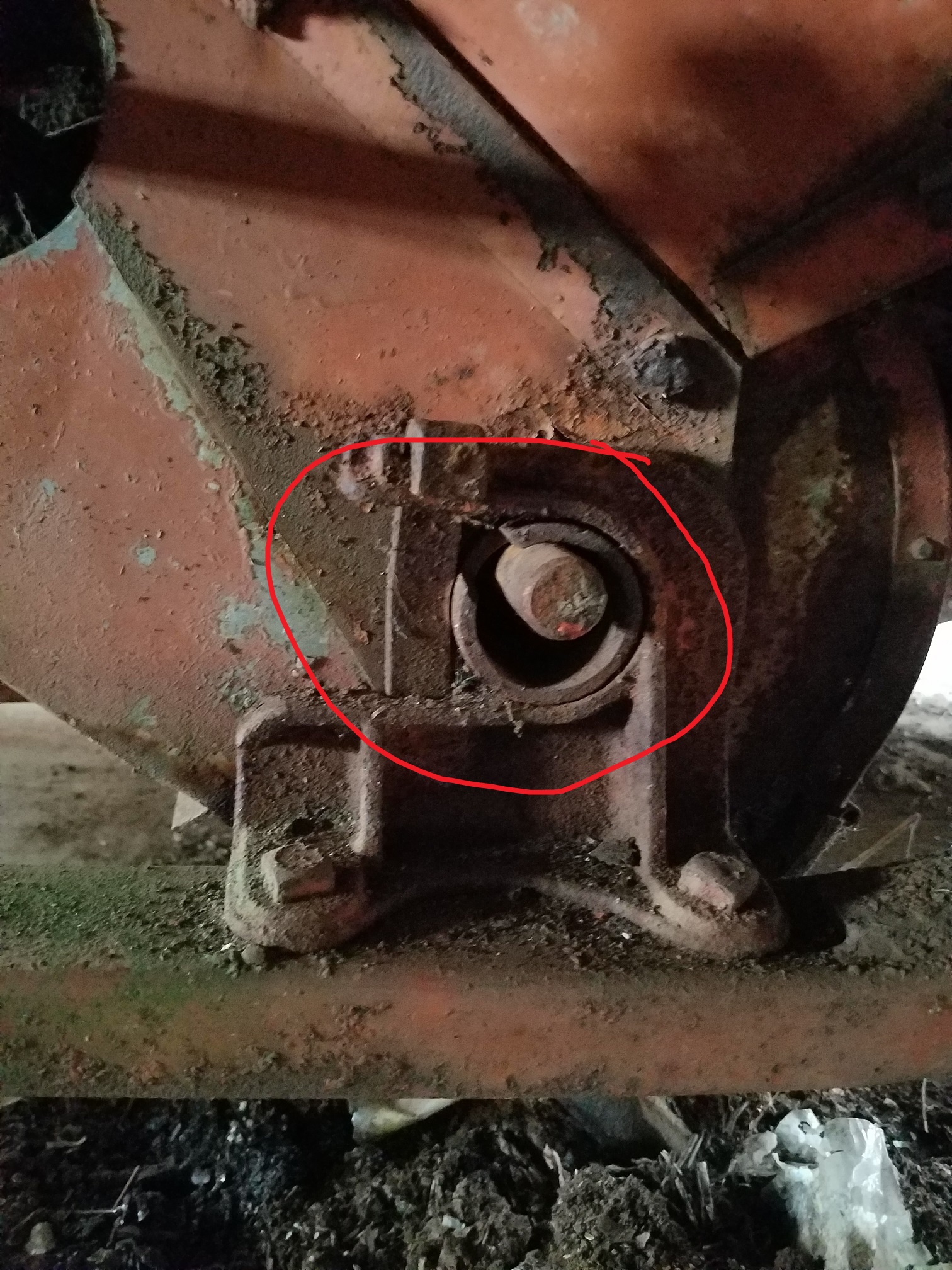

Would anyone happen to know the size and or belt number that I would need to replace the belt that goes from the v-belt pully to the picker fans? I have the old belt so I could probably measure it and get close. Was curious of anyone replaced there's recently.

I think I might have a spare set of engine shields.  I found a set I forgot I had the other day.  I have to make sure they are the correct ones if you need them.

Hey Jim. Yes I am looking to purchase a set of engine shields. Not sure how they mount in regards to needing any additional brackets. Also looking into a front cone if that would be something you'd have? You're welcome to pm some pictures else I can pm my cell number.

Good Morning everyone! Hope you all had a great St. Patricks day Wanted to give an update with a couple of questions. Filled the transmission with oil on Friday, noticed a puddle of oil Saturday morning Found a crack in the pto housing. Pretty sure water leaked in there from all the years of setting outside and froze. Fortunately I had a spare pto gearbox off of a 'donor' tractor and I was able to replace it. Hoping to have some videos later this week. Now for the question: on the rear elevator, at the bottom sprocket, I'm curious if their's suppose to be a bearing on the end of the shaft? If not a "wood block"? The shaft kinda wobbles when you're running the machine
Posted By: Allis dave
Date Posted: 19 Mar 2018 at 7:01am
Glad to hear that you're making progress. It looks like you have what's left of the outer bearing race so I'd say for sure there should be a bearing there. I have no idea what size other than to measure your shaft and pull out that race to get an OD.
Posted By: CTuckerNWIL
Date Posted: 19 Mar 2018 at 7:45am
I would guess it was a bronze bushing. I think I would find a bushing that will slip fit on the shaft and press in the existing sleeve. Then drill and tap the new one for a grease zerk, and line the grease zerk up with the slot in the existing sleeve.
Date Posted: 20 Mar 2018 at 7:29am
Charlie has a good point. Usually when the bearing goes out, the ID is still stuck on the shaft.
Posted By: JoeO(CMO)
Date Posted: 20 Mar 2018 at 8:20am
If I recall correctly, the elevator should come off the base unit for easier install and storage, pivoting where the shaft is circled in your picture.
Are there extra pieces welded in that area?
Posted By: JimIA
Date Posted: 20 Mar 2018 at 4:17pm
Your missing the entire bearing assembly.  I will try to get some pictures of what it is supposed to look like.  I should have a spare.  Most bearings I these machines were grease able caged roller bearings.  They hold up amazing.
Jim
Posted By: AC7040
Date Posted: 21 Mar 2018 at 7:20am
Sounds great Jim! I will take a look in my manual tonight when I get home to see if I can see what I'm missing as well.
Posted By: JimIA
Date Posted: 21 Mar 2018 at 5:18pm
Here you go.

Was able to get the Corn Picker out and see if it actually worked. I had a pretty good size smile to say the least. Very small patch but no break downs and worked quite well. Hoping to pick a bigger patch next year and possible bring her to the Half Century of Progress
Posted By: chaskaduo
Date Posted: 22 Dec 2018 at 5:02pm
Great going. Is that popcorn I hope for your mini rewards later.
Posted By: Don(MI)
Date Posted: 22 Dec 2018 at 5:22pm
Success! Congratulations!!!
You have a rare bird! thanks so much for the pictures and taking us down the road to get the unit operational. Happy "Pickin and a grinning" !!!
Galatians 5:22-24
Posted By: IHCfarmer
Date Posted: 22 Dec 2018 at 7:46pm
That’s AWESOME did you show it to the old fellow you got it from? Did his dad make it to see it run again? Great work!!!!
Posted By: shameless dude
Date Posted: 22 Dec 2018 at 10:16pm
that's along wagon box! congrats on the rebuild!
Posted By: Sugarmaker
Date Posted: 23 Dec 2018 at 8:26am
Great picture of "old school" corn picking! Brought back some memories! You did a great job getting this picker and the tractor working again!
Thanks for posting! You have a very nice farm too!
Posted By: JimIA
Date Posted: 23 Dec 2018 at 12:28pm
Great job! Glad you were able to run it!
Posted By: BenGiBoy
Date Posted: 23 Dec 2018 at 1:07pm
Looks great!
'39 Model B
Tractors are cheaper than girls, remember that!
Posted By: AC7040
Date Posted: 23 Dec 2018 at 8:22pm
Thanks guys! Unfortunately the previous owner was able to see the tractor and picker working in person due to being in very poor health before passing away. His boy is very happy to see it up and going and the plan is to include a sort of "In Memorial" identification on the unit for the family.
