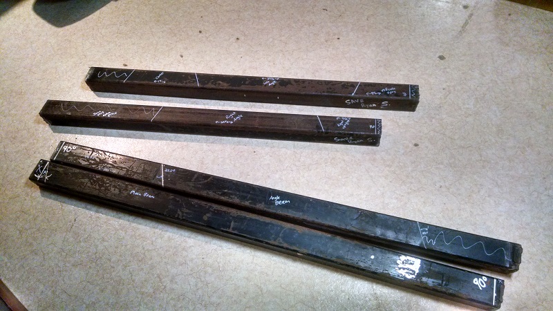

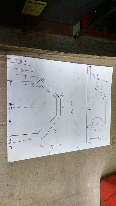

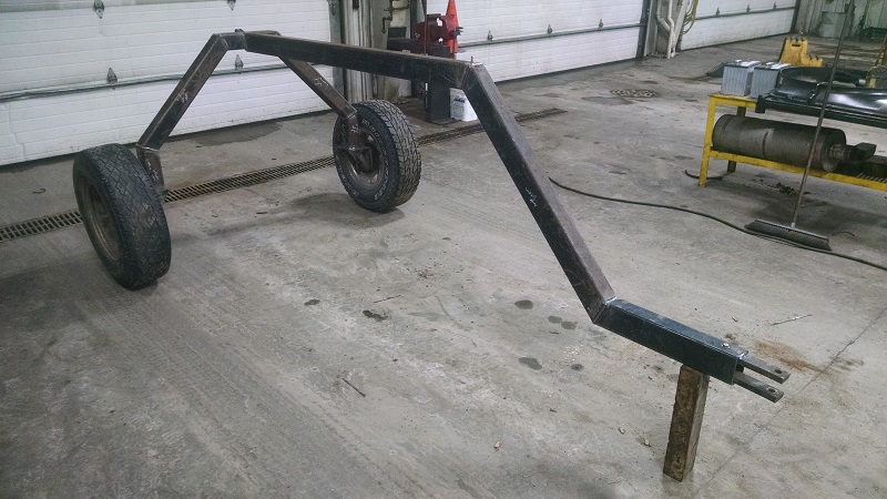

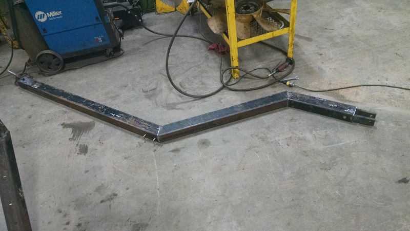

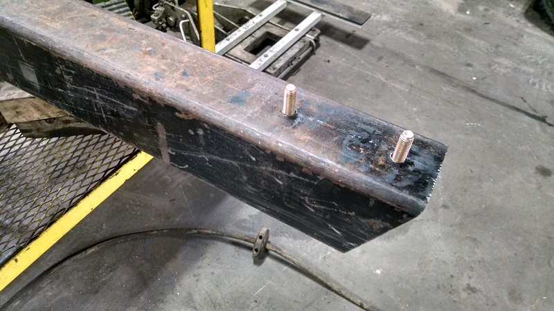

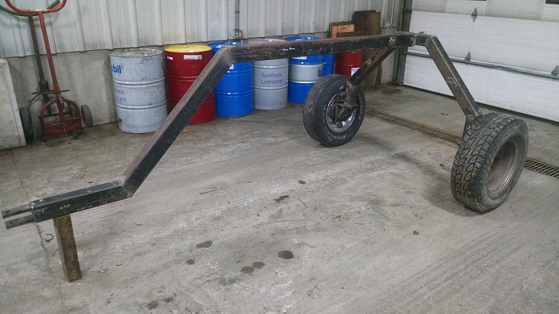

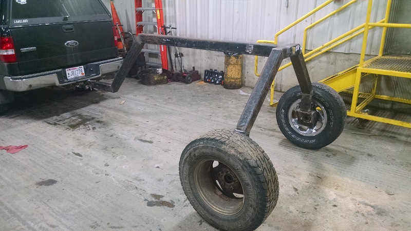

I built a farm crane for the WD a few years ago. One of the handiest attachments I have ever used. I looked it up in the WD attachment manual, the farm crane is rated to lift 1400 pounds. Surely it should handle any 8 foot popple log.
Got out the old firewood wagon. The floor and sides are made of 2X8's. As we filled it, three boards went up on each side. Made for a pretty good load. But, it will need some modifications for logging. Took all the boards off, and took the the pipes and brackets off one side.
Still has the tag on it. I guess its called a "rocker wagon?" Because the front part actually pivots a small amount. Anyone have any ideas there?
The two cross beams are 7' apart. Perfect for hauling 8'6" logs.
We had two choices for making firewood. When we needed to get in a tight spot, we took the trailer. When we were in a more open area, we used the wagon, which hauls more. If I'm going to be driving up the road in the dead of winter out in the open, you can be darn sure I am going to get as much wood per load as possible, So, I fabricated a drawbar for the back of the wagon, so I can hitch the trailer on behind.
Built a swivel to put on the end of the crane. That way I can spin the logs to be in line with the tractor so we can get them out of the woods. Its made from a thrust bearing off a kingpin on a heavy truck steer axle.
Made a toolbox for the side of the tractor. Lord knows you need accessories when you go out in the woods, so this will be a handy spot for the cant hook, straps, chains, etc.
You can see I also added some brackets for putting some weight up front, just in case.

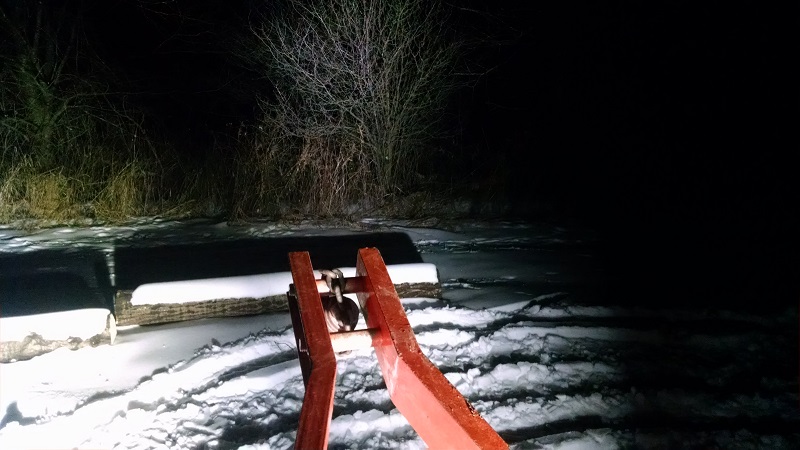

So here we are, outside,  on December 4th, at 9PM, in our t-shirts, painting. Sheesh.

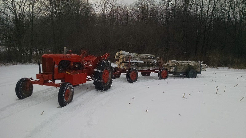

Hooked up my land train and headed out to the woods. Dropped the trailer at the clearing. I use a couple of jackstands to hold up the trailer to ease hooking it back up.

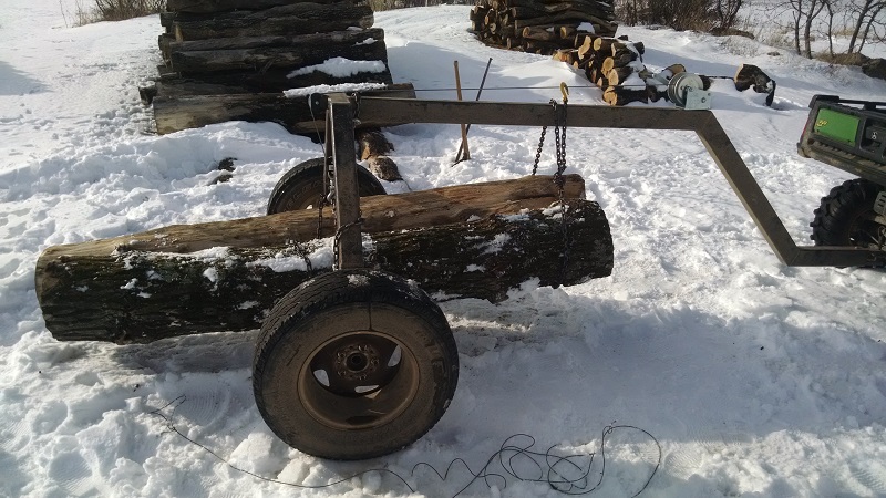

I cannot believe how well this works. Dropped the wagon in a spot where I can turn around and back up to it, and went to the first tree, probably 50 yards away.
Backed up to two smaller logs, lift them up, then chain the front to hold them in place...
And deposit them neatly on the wagon.
Repeat. Sure works slick.

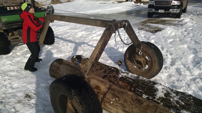

You can pick a log up from any angle,
And swing it right into position.
When you get to the wagon, spin it back and set it down.  Pin the pipes back on, and make a pretty nice load.
Next comes the trailer. Its a little handier, cause you can take it closer to the logs.
I often wondered why Pa always used the B and never got a bigger tractor. The B is 5' wide. The WD is 6'. Boy, what a difference one foot makes in the woods. Snuck her through some pretty tight spots, that for sure.
So, out to the clearing, to hook this wagon train back up.

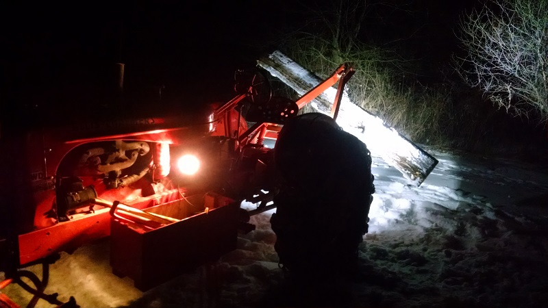

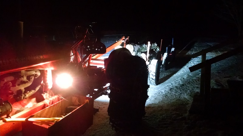

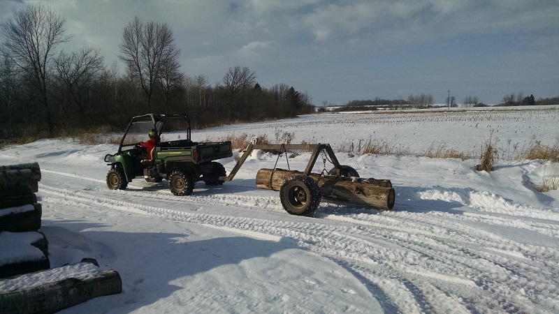

Due to the shortage of usable daylight, I broke down and bought a pair of 4" square LED lights. Hooked them up to a garden tractor battery and used them for a few hours the other night, should be good to go there.  The battery just happens to just fit in the toolbox. I don't have the time to convert the WD to 12 volt right now.
So, today Junior and I (and the dog) headed up to Grandpa Marvins for a few hours.
Got the chains on.
I went up to the end of the woods and fished out a trailer load of sticks. Uncle Eric showed up, and he and Carter got to work on laying down the next batch. With Carter running one end of the tape measure and clearing brush, they can really lay down the lumber!
Goes pretty fast when you are on the edge of the woods and drop them into the open. I have to give big brother credit, he is excellent with the saw. I will stick to tractoring.
Got the trailer load home. Carter jumped on the Gator, and we were unloaded in like 10 minutes.
They slide right off onto the pile pretty slick. We will have to improvise once the pile gets higher.
By the time this whole endeavor is finished, we will have it down to a science.
After driving up and down the road once with the chains on, hauling loads with the truck is sounding better and better.

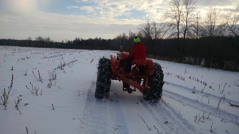

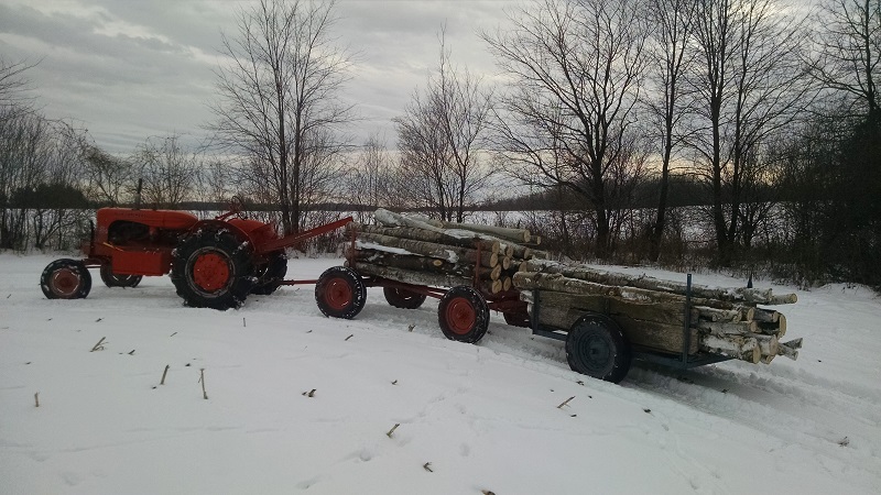

Well, the logging operation got suspended due to Christmas, New Years, and extreme cold.
Today I managed to get a couple hours to myself, and it warmed up to like 8 degrees! Time to get back to work. We had dropped a bunch and skidded them out to the field before Christmas break.  I threw the battery charger on the WD when I got up to dads, and took the Gator up to check them out. Swept all the snow off them, knocked them loose with a sledgehammer.
The WD fired right up in the cold, but snubbed off when I let the clutch out. Fired it back up, held the clutch down for a minute, and let the clutch out real slow, must have been the hydraulic pump that was dragging it down. Worked the lift arms a few cycles, everything works O.K. Wasn't sure if it would, its been below zero for the last two weeks.
Just took the wagon up today, it was late afternoon by the time I got up there.
Pretty easy to get a nice load when you are working with the big end of the tree!
I have been struggling with unloading the wagon and the trailer. When we originally started this project, we were going to make the pile in an open field near the road, where we would have plenty of room to turn around, and get at both sides of the pile. Then Pa piped up and said the pile had to go behind the old barn foundation, next to the trail, near his firewood pile.  I screeched a little bit, but, his land, his rules, I guess.
SO, I have been:
pulling the logs off by hand (back breaking, finger smashing, sweaty process)
using the gator to pull them off (only works on one end of the pile)
Using the gator and a snatch block and cable to pull the logs off using the WD as an anchor (time consuming pain in the ass that didn't work that well and conveniently didn't get pictures of)
The very first load, I used ramps, but they kept falling off. I have been thinking on this unloading process for awhile, and decided to get back to basics. Simpler is better, remember.
Put some eye bolts in my ramps, and ratchet strapped them tight to the wheels.
I think I may be on to something here. I unloaded the wagon by myself with no sweating or swearing! Now this is progress!
Once the pile gets higher, I may actually have to roll or push the logs up the ramps, but they aren't the worst to work with.
So, the pile of bolts is on the left, and the pulpwood goes on the right. We shall see how the piles progress.
Even got to take in a beautiful late afternoon sky on a cold day.

Cleaned up the rest of the field on Saturday afternoon, as we are expecting some freezing rain and snow. Got started around 2 P.M. Took one load home, stopped for supper, then out for some nighttime work!
Wish I had something more exciting to report, but here is the monotonous part, load after load. Slowly but surely.
Those 4" square LED's sure do light up the night. The garden tractor battery kept them burning brightly for over 4 hours.

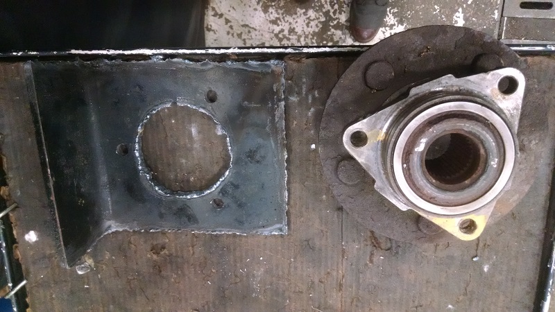

Junior has been feeling a little left out. But when I am loading logs with the crane onto the wagon and trailer, he just can't be around. One slip of the chain, one blown hydraulic hose, one slip off the clutch pedal, all spell disaster.  But he sure likes to help, and its good for him to be outside and active in the fresh air. If only there was some way he could help, and up production at the same time.............
Hmmmm. I've always wanted a log arch....
Oh great, here we go again!

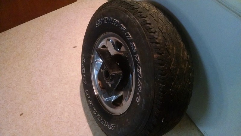

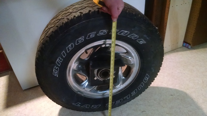

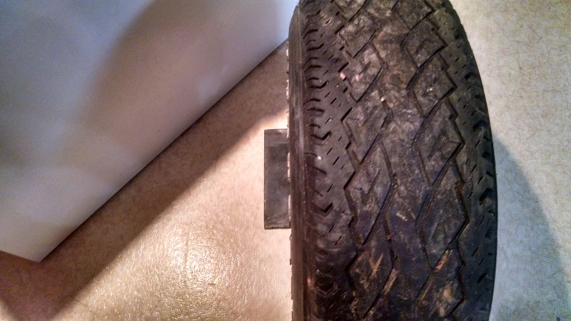

Someone at work replaced the front hubs on his pickup recently, and lucky for me, he never throws anything out either.  Talked to the scrap man at work, and after a quick dip in the steel dumpster, came out with all the steel I need for construction. Got some 4" square tubing, and some frame rail.
Got two rims and tires pretty cheap from the junkyard.
The reason I bolted the rims on backwards is for clearance on the legs. But even with them bolted on backwards, there still isn't much material sticking out to work with.
Anyways, now I can finish my calculations, now that I have the tire height.

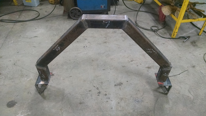

So here is my master plan.  Note: it is not to scale, the geometry is sketchy at best, and half the measurements got changed on the fly...

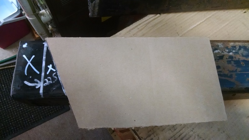

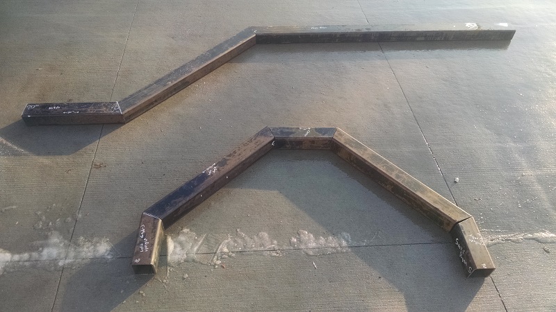

Four cuts of 22 1/2 degrees should get around a 90 degree corner, and make some 45 degree angles for strength as well. Made a pattern and laid out all the cuts.
Took the steel to a machine shop to have it cut. Laid it all out, looks like my angles are good.
Added a little material to the pieces of framerail to get it out past the tires.

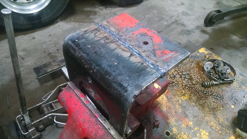

Laid the arch out on the floor, tacked it all the way around, and welded it tight. Turned out pretty good.

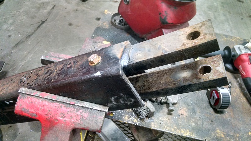

Before I welded the hitch together, I tacked a couple of 3/8" bolts into place for mounting the winch.
Fabricated a tongue.
Laid out the hitch and welded it up.
Picked up a boat winch, I had the cable and hooks and a snatchblock already. So today we went and tried it out. We don't have any popple logs laying at this exact moment, but lucky for us, Grandpa Marvin has a load of oak logs sitting in his yard.
Rolled a couple out to where we can get at them.
Works pretty slick. This arch has room for about 6' from the back to the hitch, so it should handle 12' logs.
Off he goes.
Here is a video
https://www.youtube.com/watch?v=D7EdaXykEyw" rel="nofollow - https://www.youtube.com/watch?v=D7EdaXykEyw

So, I am very pleased with how the arch turned out. Its not quite done yet, I have a few ideas to try out now that I know it works. And I need to weld on some grab hooks and some loops for attaching hooks and chains and we should be in business. Already thinking cheap electric winch too.
Fired up the WD, broke a trail down to the corner of the field, where we will be cutting next.
The rearview mirror looked like this
And, of course, we had to switch spots.

Junior has a hard time cranking the winch because its almost above his head. I suppose I would too. A guy at work wants to sell me that exact winch, he got it and never uses it. If I would mount the winch right on the back, run the cable down to the snatch block, and straight back up to a loop under the arch, I should be able to lift pretty much anything that fits under the arch. And the remote is a big plus. It doesn't look like it, but there is a lot of force involved with dead lifting logs like this. Those two oak logs gotta go 500 pounds, so a whole pile of popple should be no problem.
In the video I realize we forgot to chain up the front of the logs.  I need to add some grab hooks for chains and add them front and rear, so the logs aren't hanging from the winch during transport.

We were grabbing logs two at a time, but we just weren't getting the clearance I had imagined. My hook and loop and snatchblock and swivel all add up and take too much space.
Then I had an epiphany right out there in the snowbank. Put the high pulley back on and back up we went.
https://www.youtube.com/watch?v=YNFVjhkf4rc" rel="nofollow - https://www.youtube.com/watch?v=YNFVjhkf4rc
Boy, that sucks em up nice and tight. We string chains under the log and release the winch a bit so it doesn't get jarred when going through the woods.

Well, things have been softening up in the woods, and my dad's yard. The log pile is on his lawn, so we have to be careful not to rip it up. But, when its cold at night, its good and solid in the morning, anyways.
So, we winched some more onto the pile,
Some of the smaller ones, its just as easy to skid them over to the pile and flip them onto it.
So, we did that in the morning, then ran up to the woods and put a load on the wagon, and stacked the rest of the logs in piles of four or five to make it easy to grab them with the arch. I figured we need to get this wood out quick, spring is coming fast!
Mother nature has other ideas, I guess. We got 4" of heavy wet snow Friday night, and they are calling for 6-12" overnight into Tuesday.
The kids and I headed up yesterday to haul everything home. They sure do have fun up there, and don't even realize how much help they are, or how much they are learning.
Now that I figured out how to get the maximum lift with the arch, its time to see how much it can handle. I put the hand winch back on cause it has thicker cable. We started picking up bundles of smaller logs.
BUT, we started hooking onto bigger and bigger log piles. The high pulley attachment was designed for the cable going out to winch logs onto the pile, not straight down for heavy lifting.
This little tidbit was discovered the hard way.
We are really starting to deal with some large amounts of force here. I am stuck in town on call for the next week, so I brought the piece home with me to straighten out and re-work it a little to make it able to handle the load. Keep finding and fixing the weakest link, and eventually we will have quite the machine.
Thanks for looking.

Beefed up and ready to go again.
We are supposed to get 3 1/2" of rain, or 10" of snow, in the next 4 days, depending on temperatures. Junior and I scrambled up in the woods after supper to clean up the last of the logs, before we become swamp loggers!
He grabbed the pulp wood,
I loaded the rest of the bolts,
And we made one last trip home, for awhile anyways.
So, we got everything piled, just at dark, in the rain. Can't see it in the picture too good, but the bolts are on the left, and the pulp wood is on the right.
