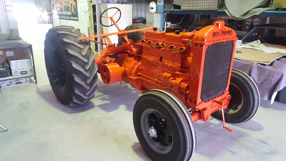

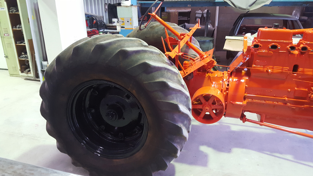

The photo below is the Model A tractor after Neil's restoration work.

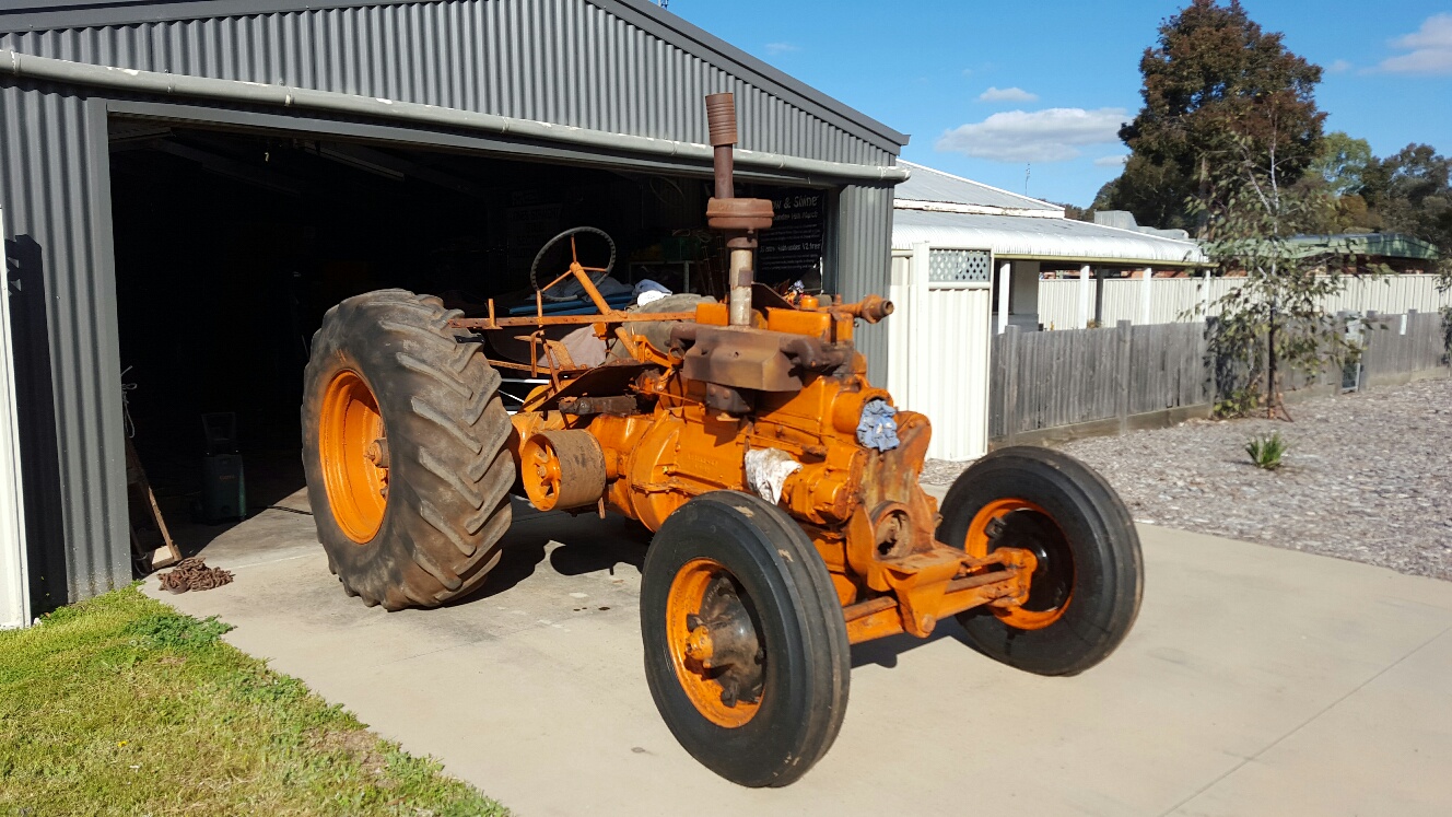

After a busy couple of weeks cleaning and replacing the front tyres the tractor was taken to the 20th Lockington Vintage Rally for a surprise reunion with my family.
https://3.bp.blogspot.com/-ilgOjt48MNI/WP8d5geViCI/AAAAAAAAAoE/qS31UO08hSQJXQTpPk_ny3-XALwVwf_PQCLcB/s1600/IMG_2011.JPG" rel="nofollow">
After a bit of work we tow started the tractor and got it moving under it's own power once again.
In the meantime the tractor will be pulled down for further maintenance and restoration work.

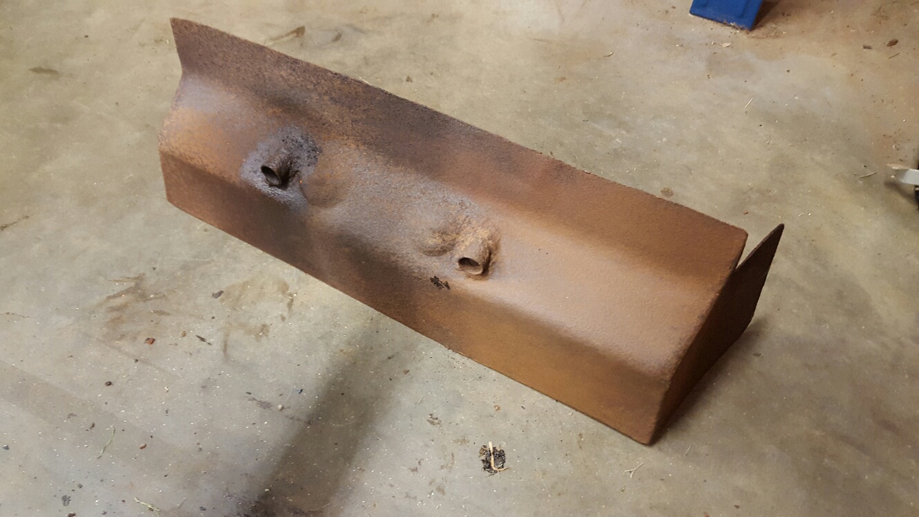

Posted By: Steve allis dozer
Date Posted: 19 May 2017 at 6:18am
Does it have two exhausts ?  looks good with the big headlights and radiator curtain

Looking again ,is the muffler and manifold shield original or was it added after being shipped? I got a sales literature and it don't show that. It is interesting that it is still there. Also welcome to this forum.
Posted By: Unit3
Date Posted: 19 May 2017 at 10:10am
Do you have a generator?
Posted By: 34 Airflow
Date Posted: 19 May 2017 at 4:55pm
In the parts book I have for the tractor the muffler is correct and as you saw was on it back in the day. The heat shield and lower exhaust was all in one piece and seems to be original too, although I will post a photo of that part which shows the exhaust stack part has been replaced at some point.
No just the one, the other is for the Air Cleaner

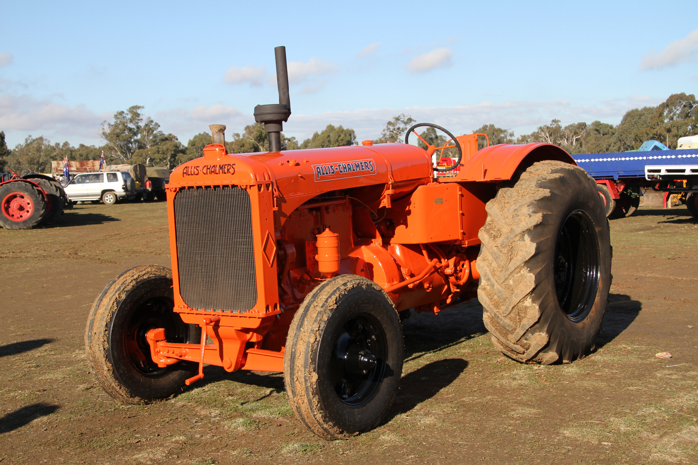

Here's the Model A with the rest of our collection.
1937 Model A, 1937 Model U, 1929 United, 1945 Model C, 1949 WF, 1948 WC, 1956 D272 and a Roto Baler
http://www.australianallischalmersregistry.com/
Posted By: JPG AUSTRALIA
Date Posted: 21 May 2017 at 6:45pm
Great photo! And great story on getting the A back,very nice collection.

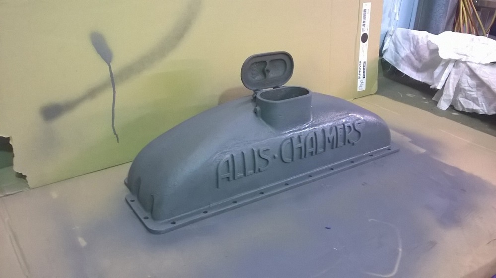

Date Posted: 01 Jun 2017 at 11:17pm

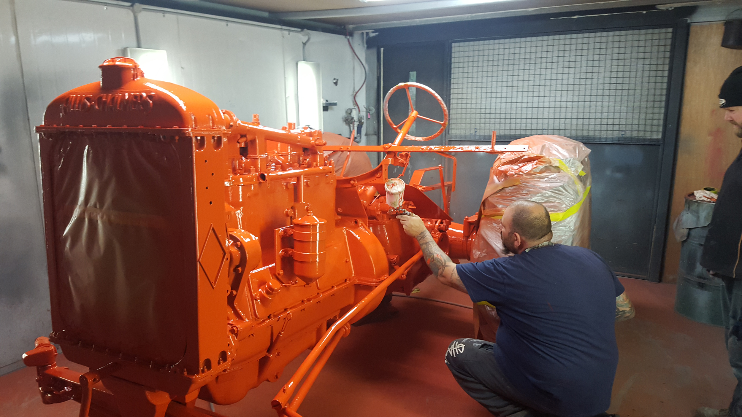

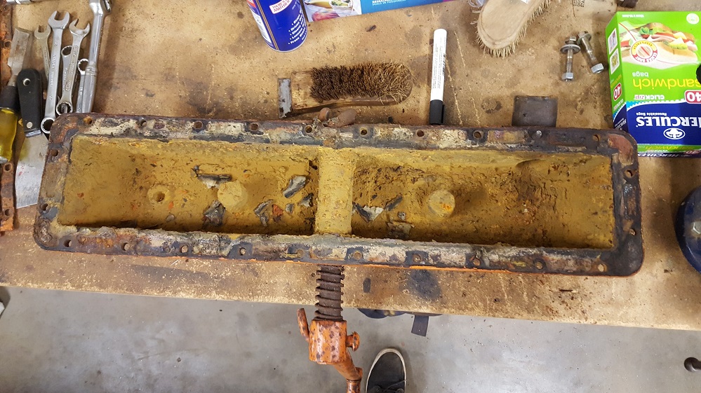

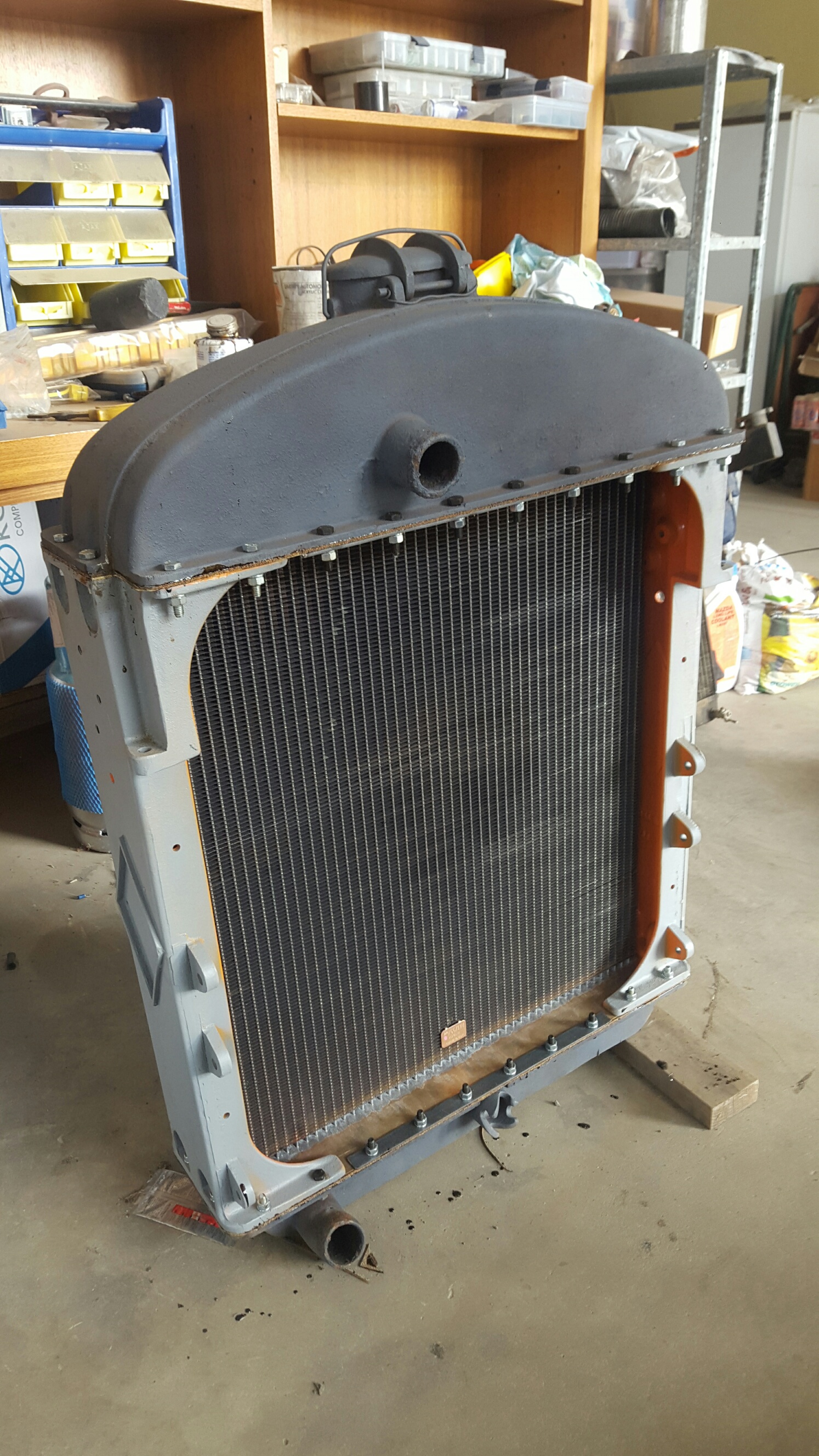

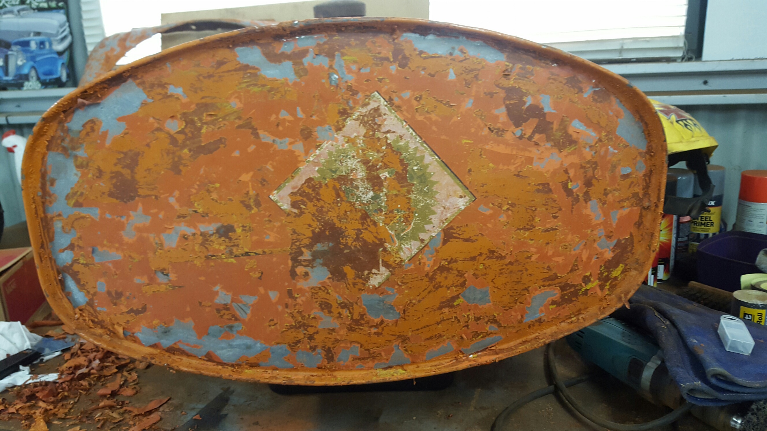

A bit of an update on the Model A, after getting the tractor running a few issues have been identified which have all of a sudden snowballed into a full restoration.
First task was the radiator which was completely blocked as it turned out so it has been removed and pulled apart to get a new Core made. Whilst off the top and bottom tanks have been sandblasted along with the side panels to get rid of the multiple layers of old paint and the barnacles from the inside.

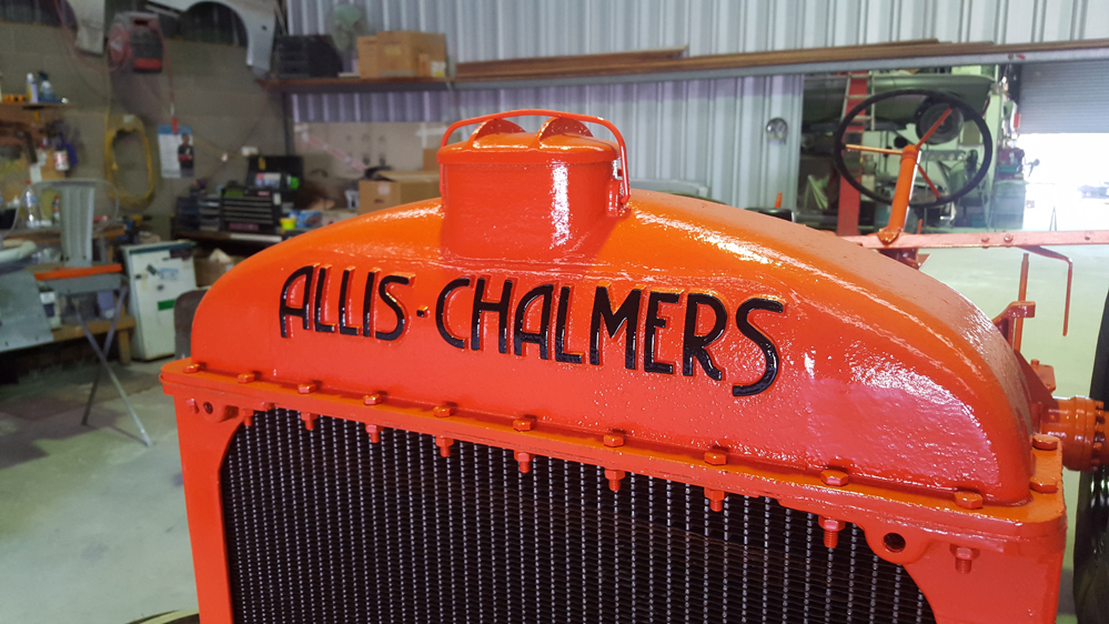

Date Posted: 01 Jun 2017 at 11:29pm
And after blasting with a quick primer job until we go the whole hog...

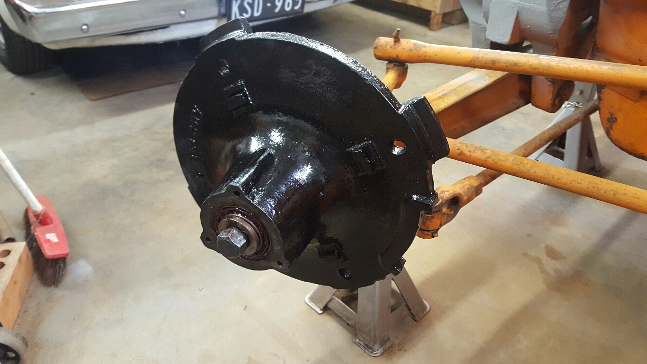

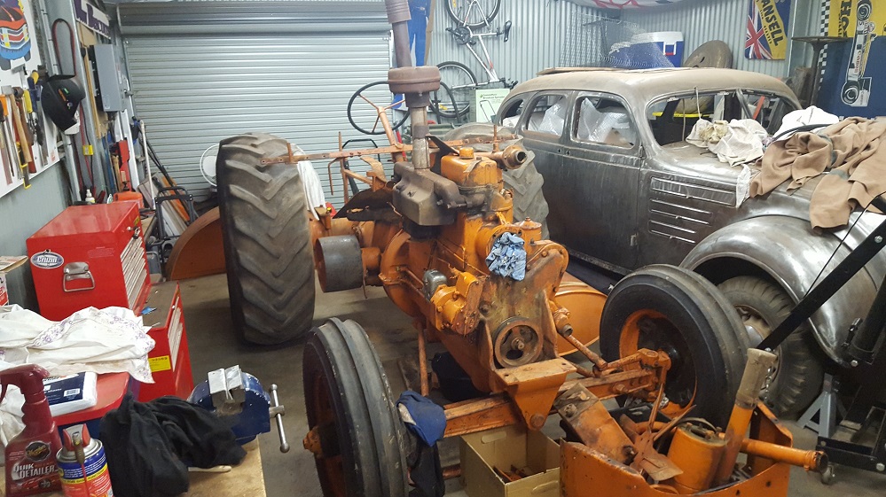

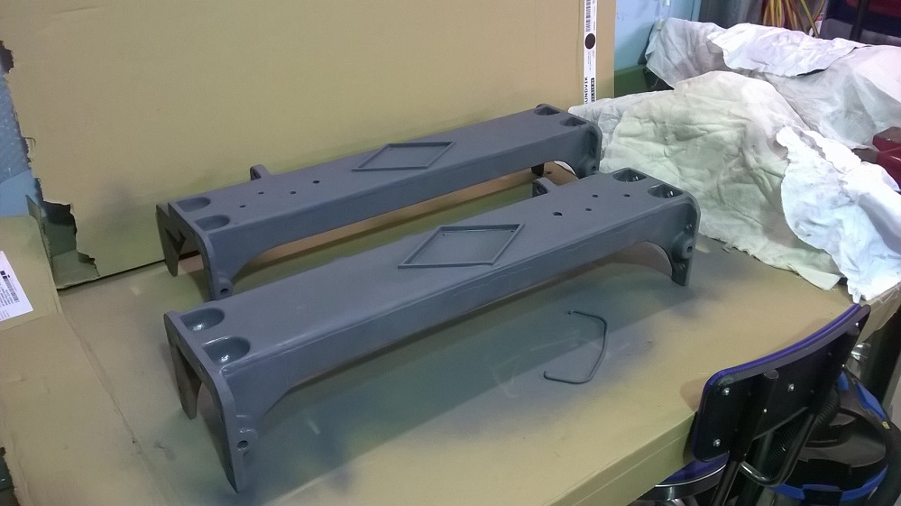

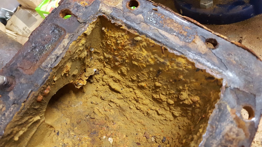

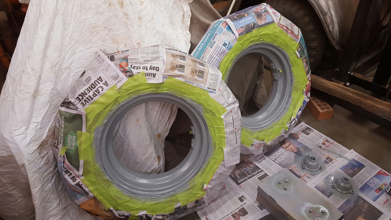

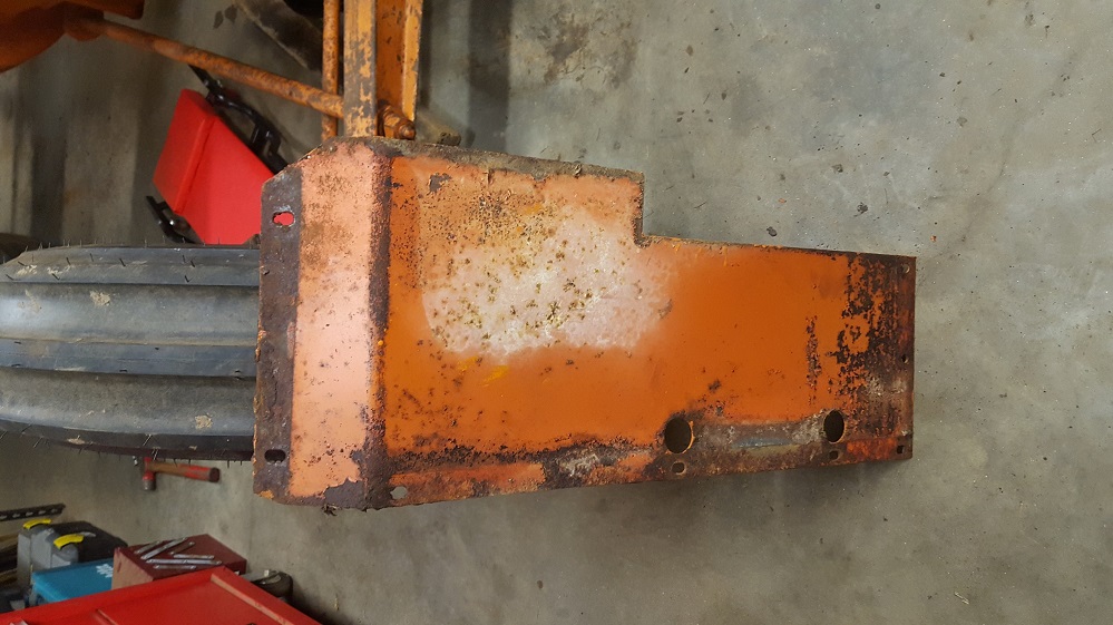

Date Posted: 01 Jun 2017 at 11:43pm

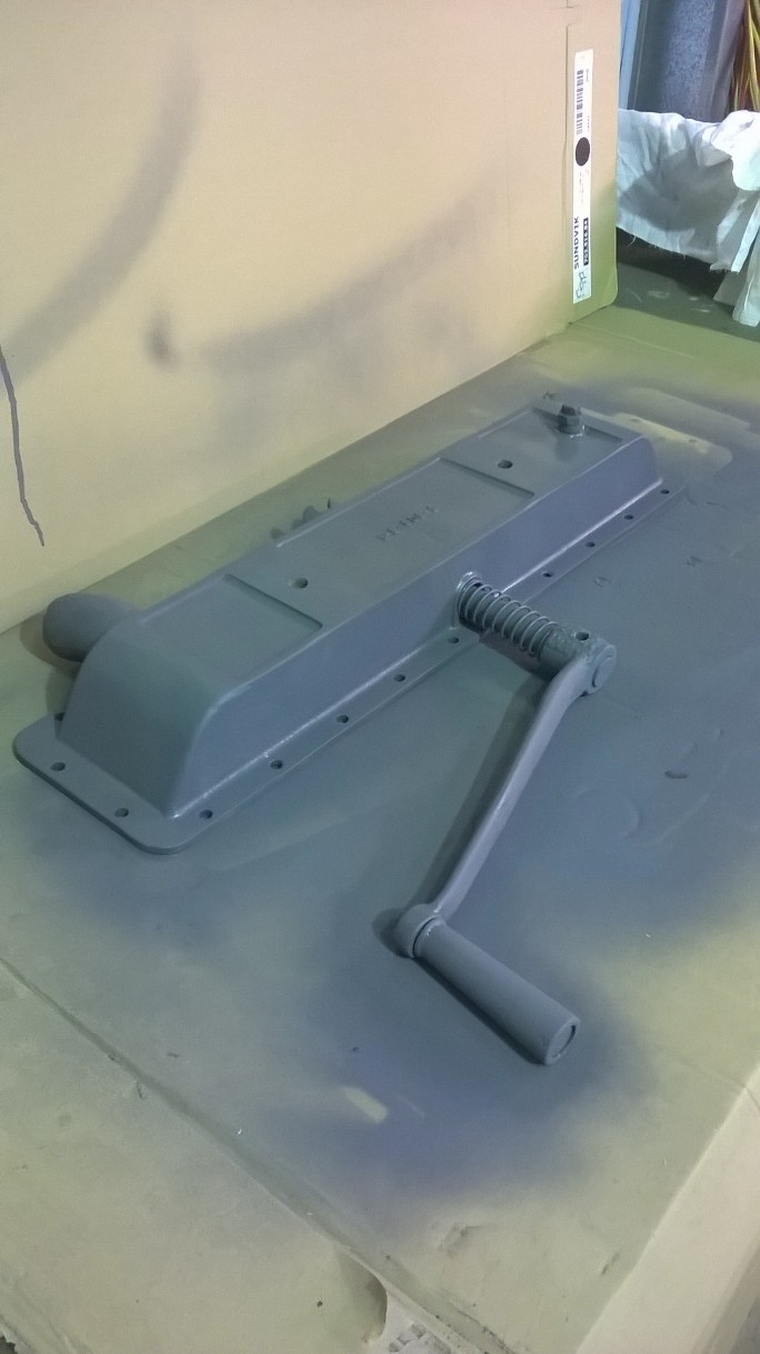

Next step was to remove the rear floor and mudguards to get in and clean everything up and sort out some small fluid leaks.
We found the underside of the floor still had some original paint hanging in there too;

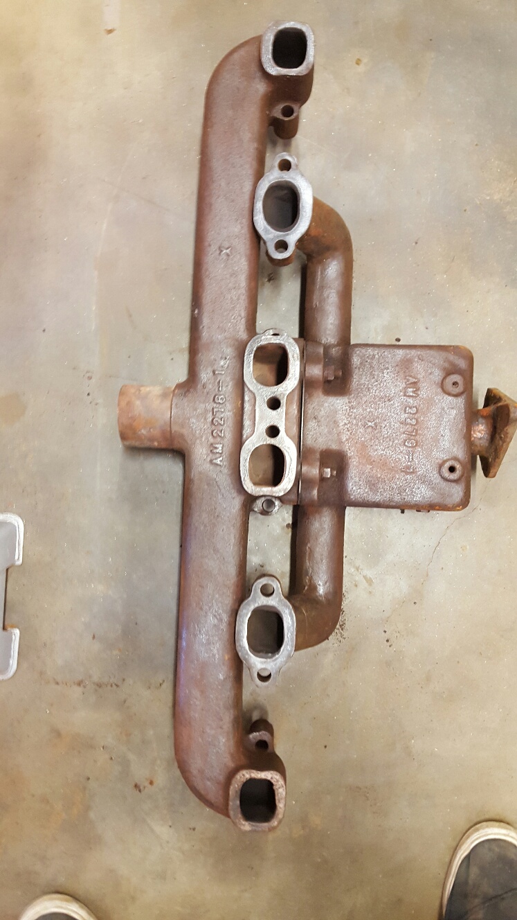

That intake manifold is a curiosity. Obviously was for low grade fuel but different than mine which is also a low grade fuel tractor.

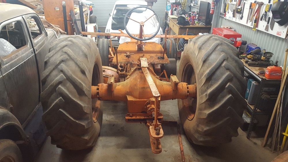

So the radiator is almost finished, we just need to run the overflow line and it's ready to go. The new core was made locally and I am very impressed with the way it has come up.

There has only been slow progress in the last couple of months, my work has been very busy leaving little free time to work on the A. However weather is now improving and motivation levels are high so hopefully there will be more updates to this thread.
One job was to remove the front wheels and fit new seals supplied by Norm's and also replace the very worn front wheel bearings. Whilst the rims were removed I sanded those back and put some primer on them ready for painting.
I also removed the manifold and heat shield to clean the surface rust off and repaint.

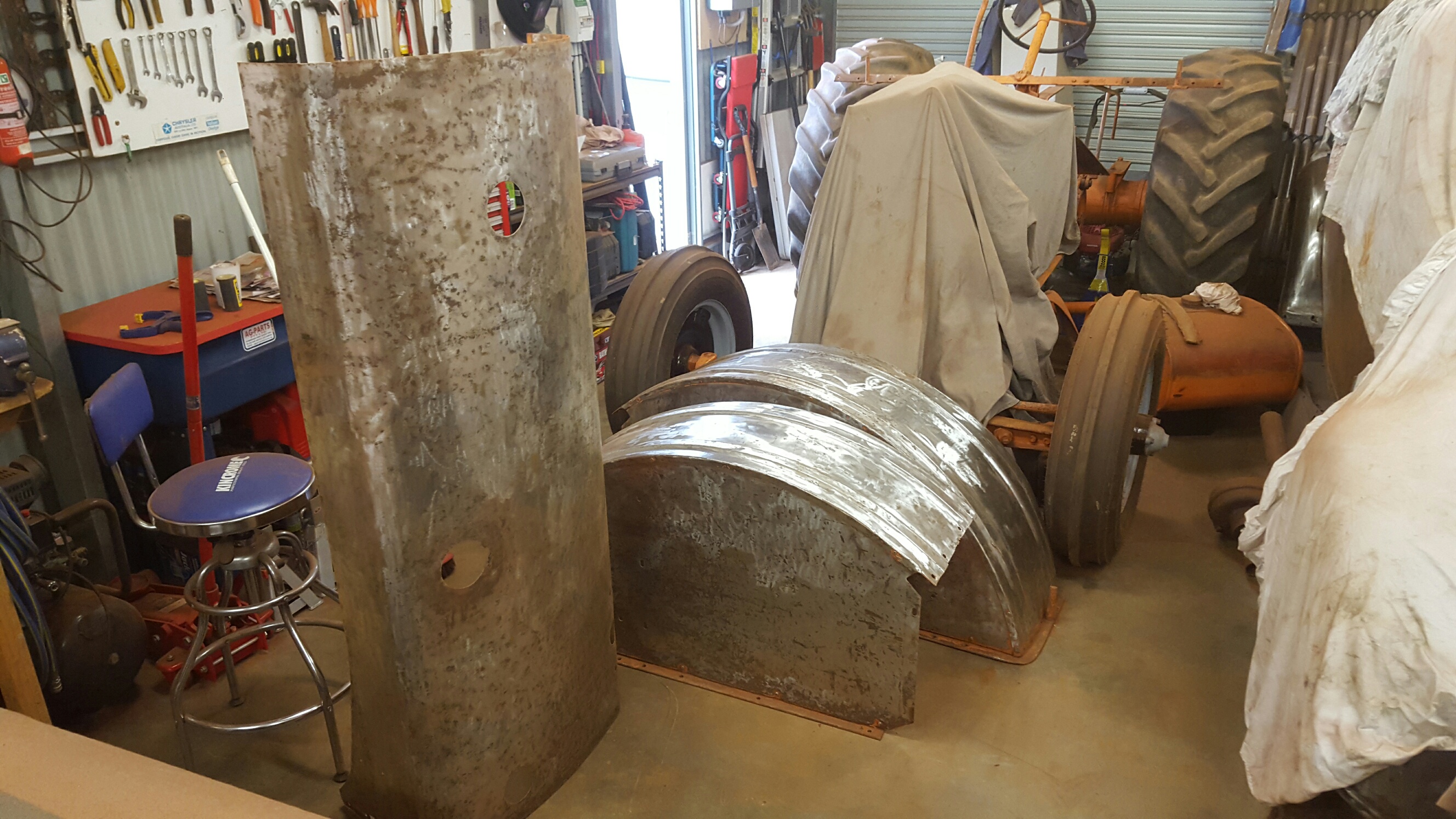

A little more progress has been made in recent weeks, mainly preparing the sheet metal for new paint, aside from a few small dents the metalwork is all quite good with rust hiding which is a bonus.
We had my 80 year old second cousin visit last week who filled in a lot of the blanks about the tractor, in particular the modifications made for farming such as the large drawbar addition, and also the small fuel can attached to the drivers compartment to allow a full 12 hour day of work. He had driven down 1,400km to see some old friends and cast his eye over the tractor he fondly remembered even though nowadays he is a collector of Green (he currently has 23 JD's). One story he did relay was that in my great uncle Neil had a pet Cockatoo that went everywhere with him, riding on his bike handlebars and on the fender of the tractor, except in the Winter when he sat up next to the Exhaust pipe to stay warm. After looking at the photos taken back in the day we noticed the bird in one of the photos as you can see below just in front of the operator!

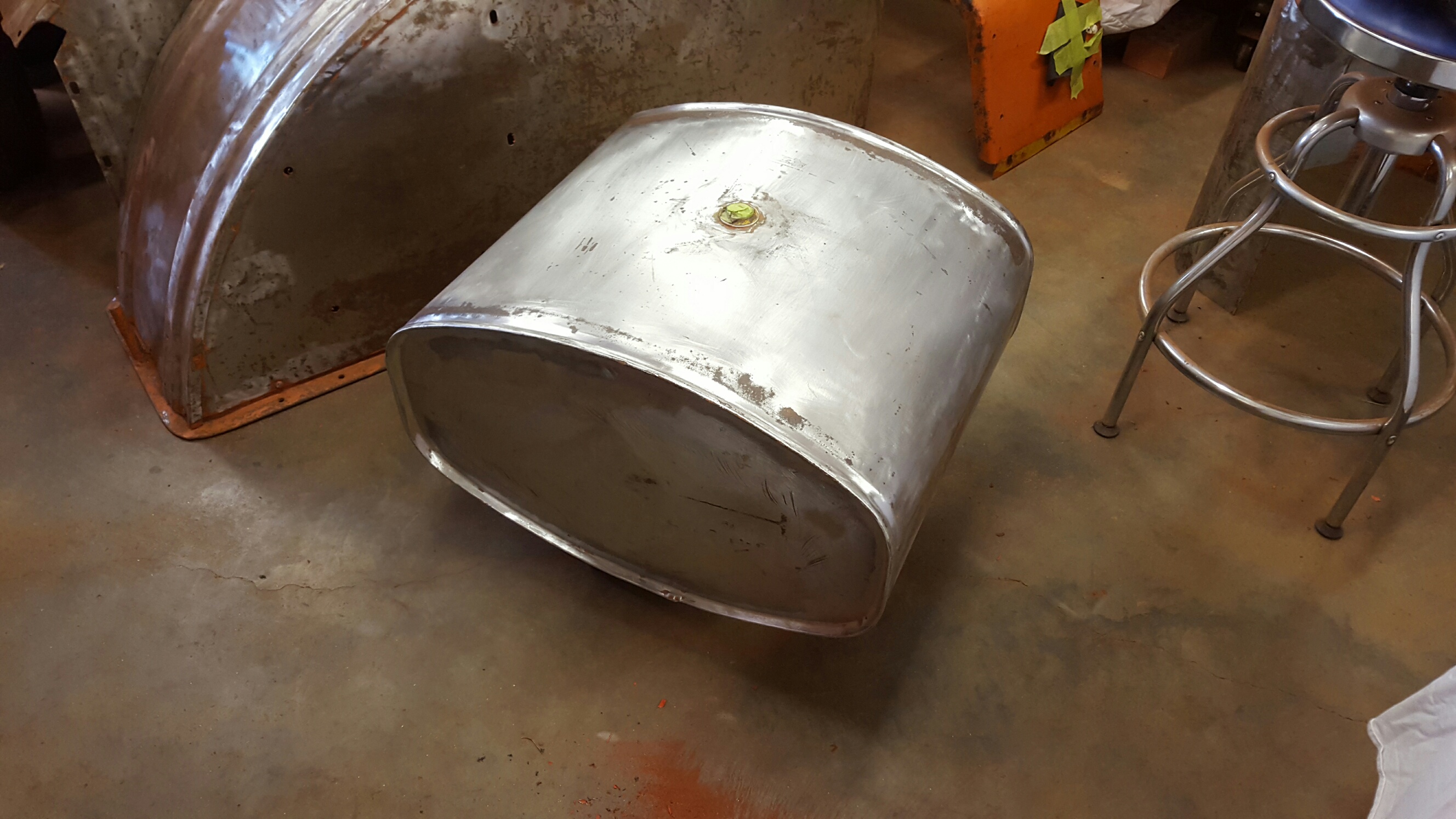

A little more progress on New Years Day getting rid of layers of paint from the fuel tank. Also found remnants of the original decal underneath, which I'm not sure whether it is intentional but was not centred in the tank, I took measurements so I know where to put the new one but it was an inch1/2 to on side and a 3/4inch higher?

I'd bet when it was built,they didn't see the importance of "precise location". Close enough was close enough.
I think you are on the money there, it certainly is just slapped on. The bonnet decals from left to right are identical, hence why I was surprised at the fuel tank. Finding the original decals has confirmed the repro ones I have to go on are the correct sizing which is a bonus.

I've been a bit slack updating this build however we have hit a big milestone with some Orange finally going on this week, more to come!

And a little more progress today;

AirFlow, A BIG WOW!!! goes out to you for the progress you have made on the heirloom.
  But do have a few questions like what size tires are on your tractor?
How are they set to miss the belt pulley? Tire size on my someday project A is 15x28 and are in the way of a belt pulley. Were your rims cut and extended?
 second question is, when you finish yours, what is your address to send mine to?LOL
 Since mine is a derelict, and the fenders and front shroud have been torched, I am not constrained to making it like factory original... thinking of making this one into an A-LPG... Definately would need a starter on it...lol

Thanks for the kind words, the rears are 18.4 28s and they do clear the pulley, the rims themselves were cut down the middle and a strip was welded in, I will get some photos to show this a bit clearer.

34 Airflow, I am glad to hear your going to make the deadline to show your tractor.
 As for the rims, Norm Meinert told me he has 15x28 rims that are offset to clear the belt pulley for the A.   mmm the 18.4x28 tires are cost more than 18.4x30 today, maybe he can get 18.4X30 offset rims?  Ermm   LOL Naw, that would probably open up another can of worms for fender clearance or something...
 Will be waiting for end results and pictures at the show too. Thanks. JC

I think you are right about fender clearance, I wonder how much there would have been on mine when the tires had full tread, the current ones are well worn so it's no problem.
The guy who helped with the paint was trying to convince me to leave the fenders off and make it a hot rod model A, that would solve all the rubber problems!

Well I finally got the tractor back together in time for the local Steam Horse and Vintage Rally. I still have a few odd jobs to do yet but it certainly looks the part!
