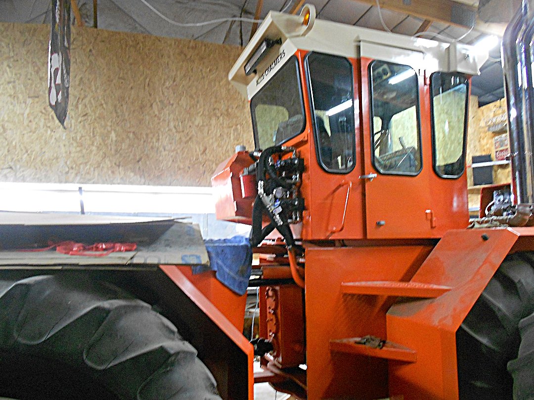

I bought this tractor about 3 years ago for a winter project, well it turned into a two year project. It is about done except for getting new outer duals put on, the inners are new. I took pics all along the way and plan to put a build thread on here some time. Here is a few pics to show it off in the mean time.
In the shed- 7020,7060, L2 X (2), CII, WD X (2), 200, 210, 611H, 440, Fiat Allis 345B

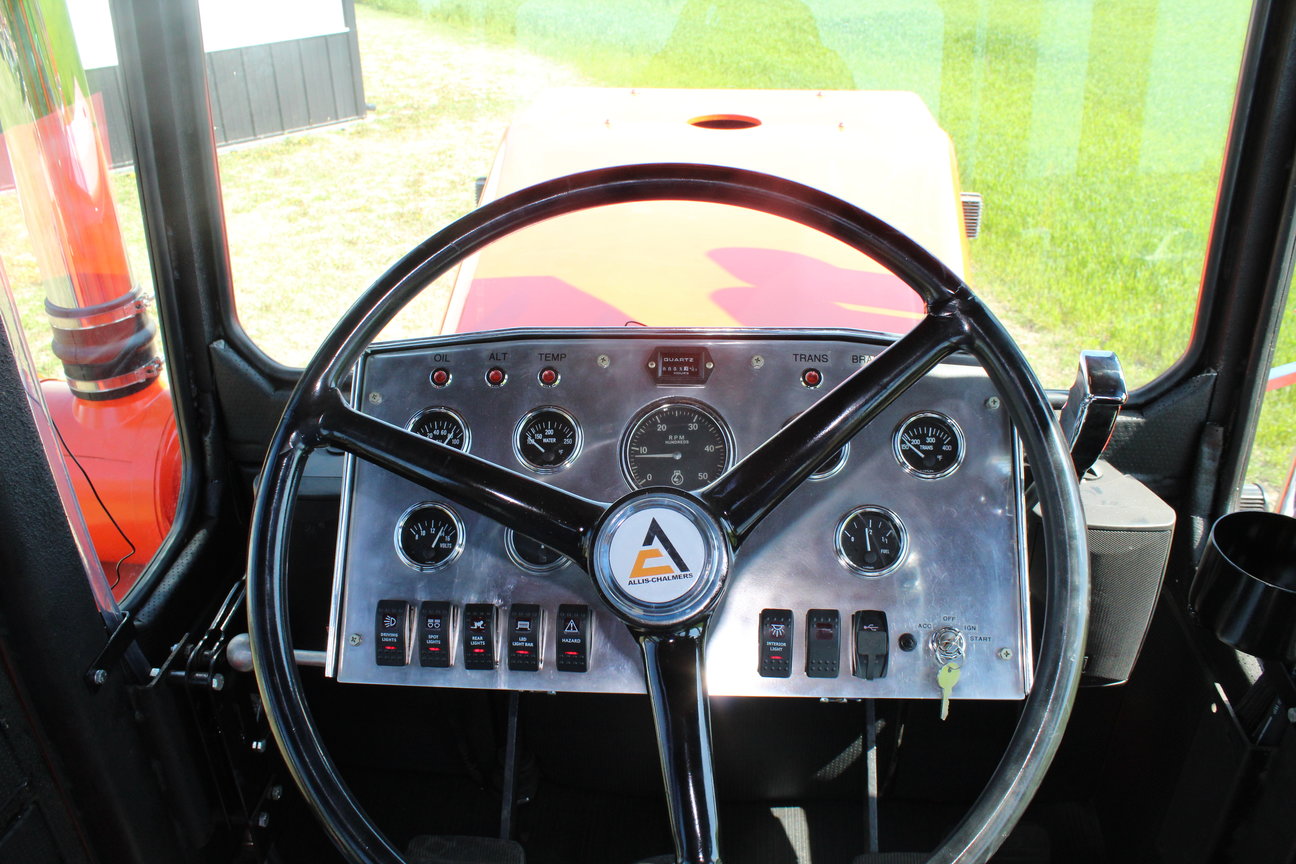

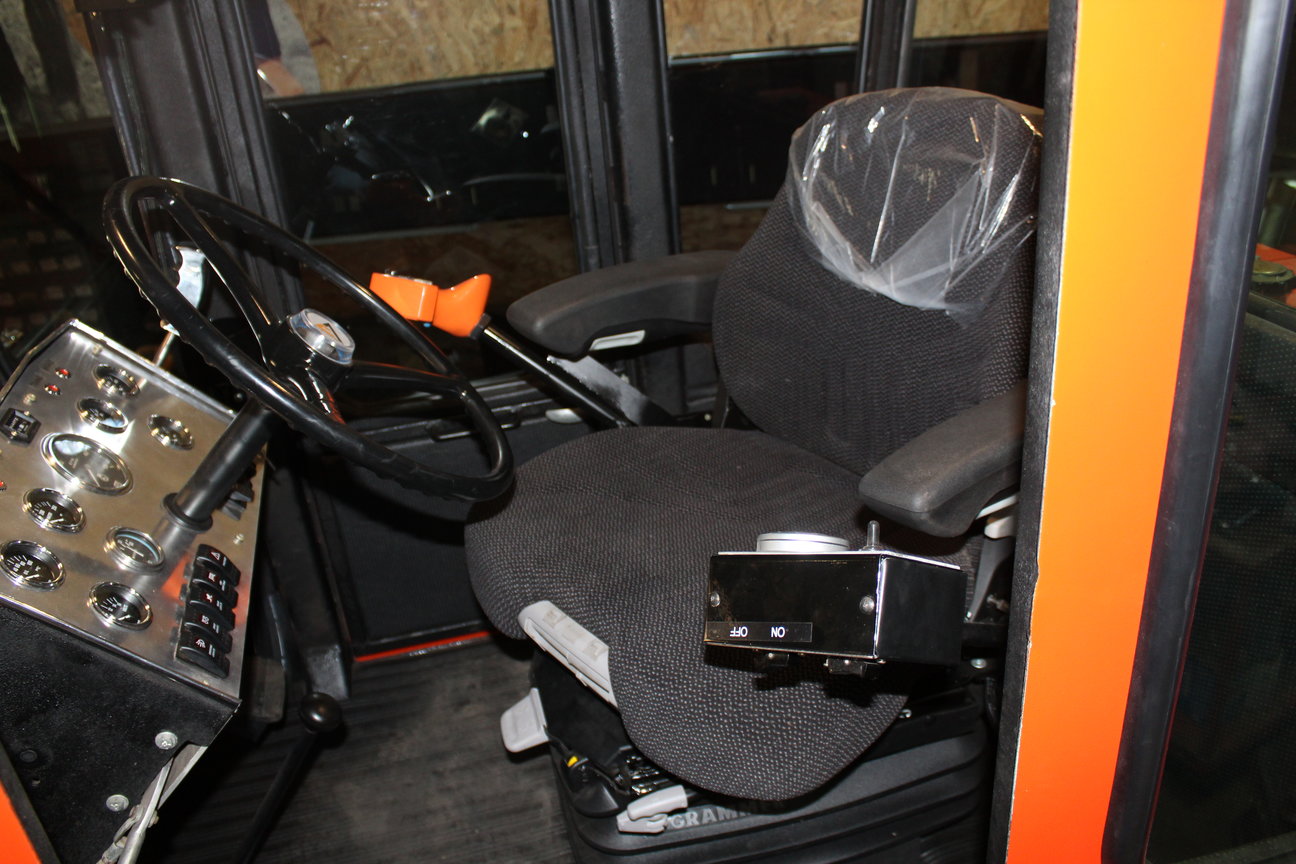

Posted By: badjeep
Date Posted: 15 Apr 2017 at 8:38am
pic of the new dash

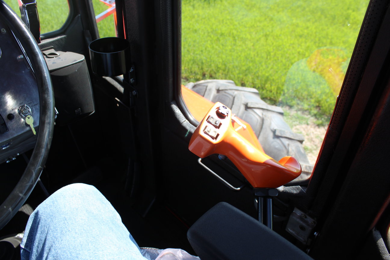

Posted By: badjeep
Date Posted: 15 Apr 2017 at 8:41am
Hydraulic controls are now a bit more ergonomically friendly than the originals
Posted By: badjeep
Date Posted: 15 Apr 2017 at 8:51am
New Grammer Air Seat

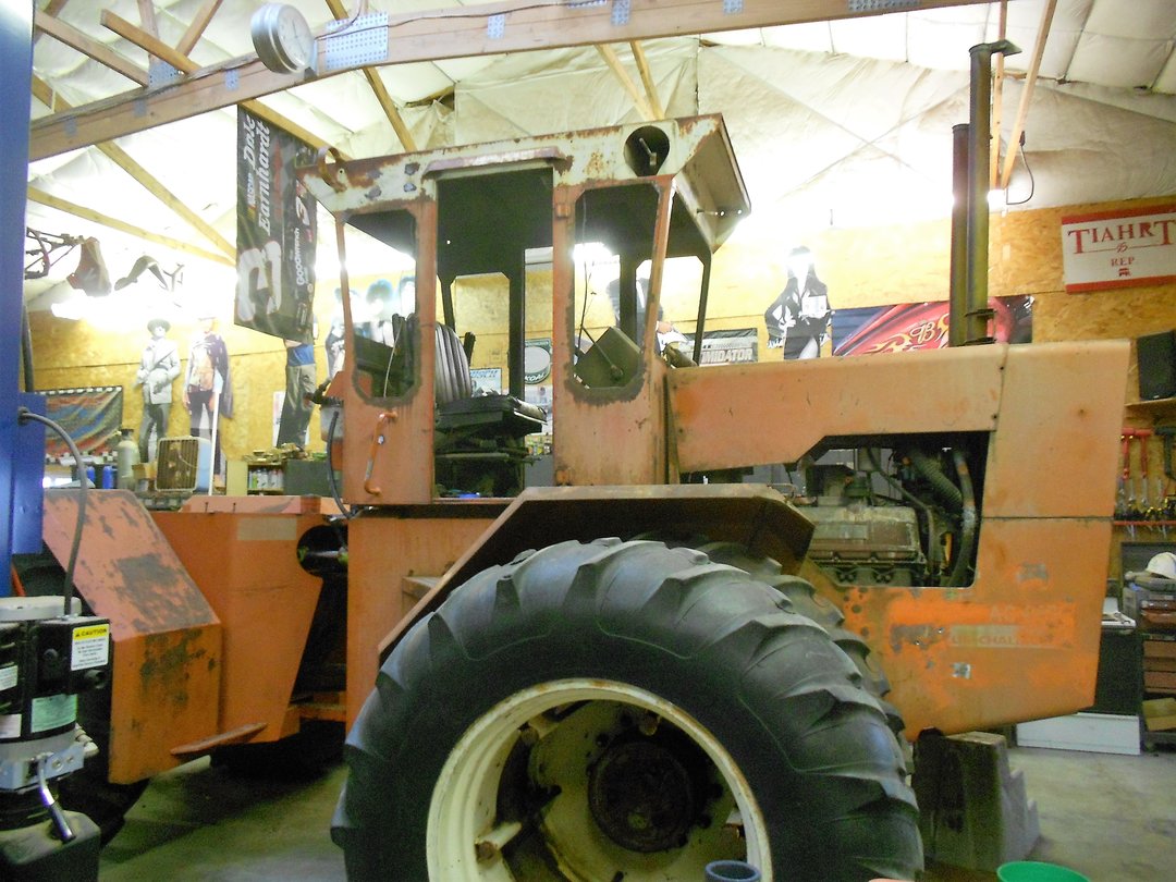

Posted By: badjeep
Date Posted: 15 Apr 2017 at 9:30am
Here is one from when I started tearing it apart

Originally posted by darrel in ND darrel in ND wrote:
Have to jump on the band wagon with Victory Allis and ask about the hydraulics. Where did you get the orange part of the handle with the switches, and such. ..? And are they strictly electric hydraulics, or do you have to activate one of the switches, and then move the lever. It looks good. May be a system I could use to run the loader on my XT. Thanks, Darrel
Hydraulics are electric now, the orange handle is actually a Gleaner combine hydro lever. Here is a pic of the hydraulics before I got the cover built.

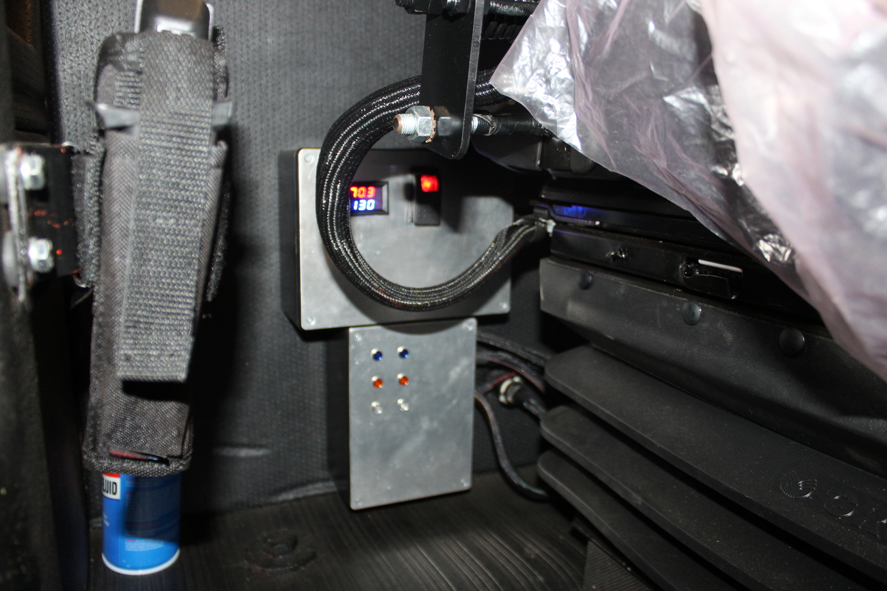

Posted By: badjeep
Date Posted: 16 Apr 2017 at 8:36am
This is the behind the seat junction for all the hydraulic and seat controls, the digital display is the hydraulic fans controller

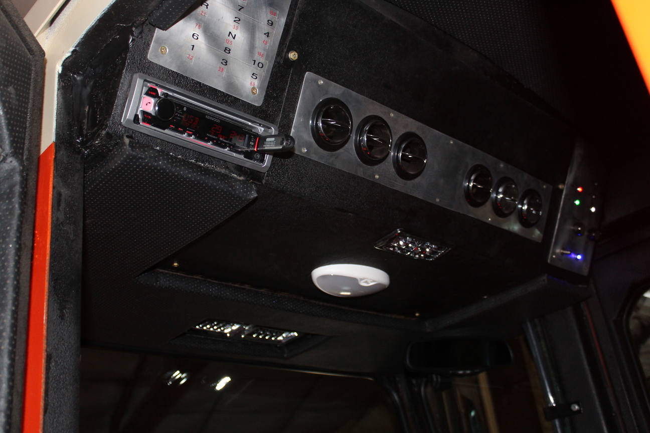

Posted By: badjeep
Date Posted: 16 Apr 2017 at 8:40am
Not a great pic, but his the overhead now

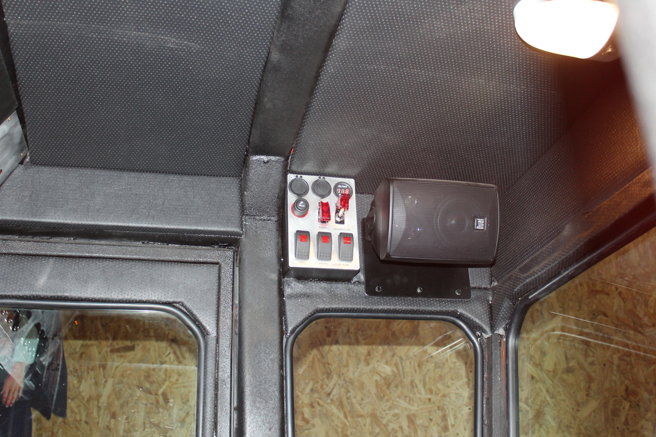

Posted By: badjeep
Date Posted: 16 Apr 2017 at 8:43am
Overhead control and power outlets

Posted By: badjeep
Date Posted: 19 Apr 2017 at 3:28pm
Originally posted by joe joe wrote:
Been watching this post from the get go. Beautiful work on this. Looks absolutely immaculate. Did you do anything as far a isolating the cab?
Entire inside of cab was Dynomatted before I started fitting interior pieces, floor got two layers of Dynomat

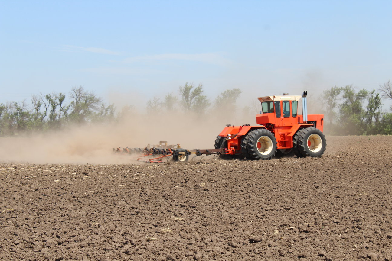

Posted By: badjeep
Date Posted: 13 Jun 2017 at 5:22pm
Couple of action pics with the cultivator

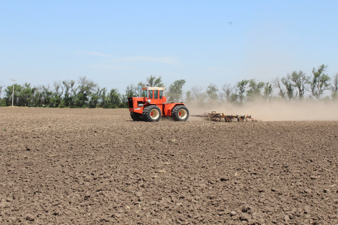

Posted By: badjeep
Date Posted: 13 Jun 2017 at 5:23pm
Posted By: Mosin9130
Date Posted: 13 Jun 2017 at 6:42pm
I don't know how I've missed this thread up to now but all I can say is WOW!...I mean just WOW, WOW, WOW!!!
'56 WD 45...'63 D15 II...'66 D17 IV
Posted By: 210Postin
Date Posted: 13 Jun 2017 at 7:28pm
Very nice looks like you need rain

Posted By: badjeep
Date Posted: 18 Jun 2017 at 12:46pm
Originally posted by GM Guy GM Guy wrote:
awesome job, very cool, and I love all the custom touches. :)
After harvest, or this winter if you have more time, could we talk you into starting a new thread on what all you did for the hydraulics?
I have a 7580 with a few shot remote cables, and dad has quite a few salvage Gleaners, so I was pondering electro-hydraulics on one. :) we wouldnt need pulse width modulation for variable flow, as we are just tillage use, so we dont need to be able to feather it.
As far as open and closed center, the old N and early R were closed center, and to my understanding all others were open center, so this may come into play on what to use for a donor...
When I get a chance I will pull the cover and take some pics and show what I did, when I originally decided to go electro hydraulic I was also going to use salvage combine valves also but decided against it because i didnt think they would flow enough volume when they were on standby, this tractor is open center and I didnt want any restriction on the pump. I ended up going with aftermarket high flow big port valves, I researched them for a month before i ordered some. There is a LOT of different valves out there.

Posted By: badjeep
Date Posted: 01 Jul 2017 at 5:18pm
Originally posted by coggonobrien coggonobrien wrote:
do you have part #'s/links for the hydraulics?
Northern tool part #
Model# SWH-G03-C6-D12-10
