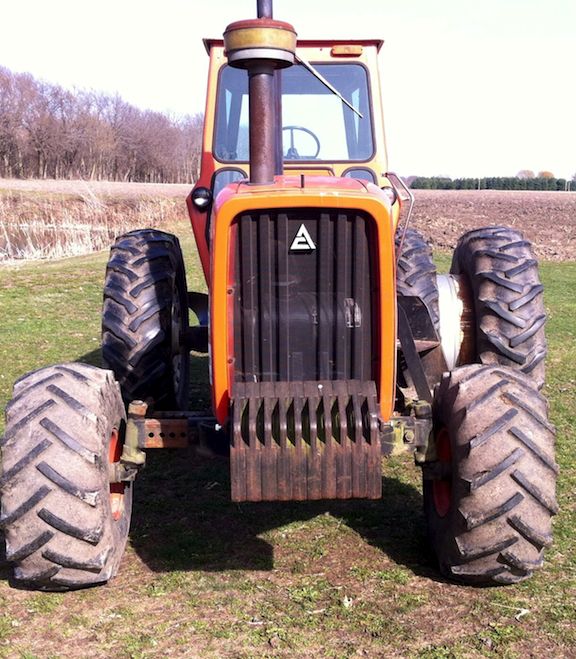

Someone the other day was asking about how to set up tractor for plowing with an AC 2000 plow, so I thought I'd share a few photos.
This photo shows the tractor's right wheels moved out so they will run in the furrow & rear duals on land side. AC's rear power shift rims make this job easy.

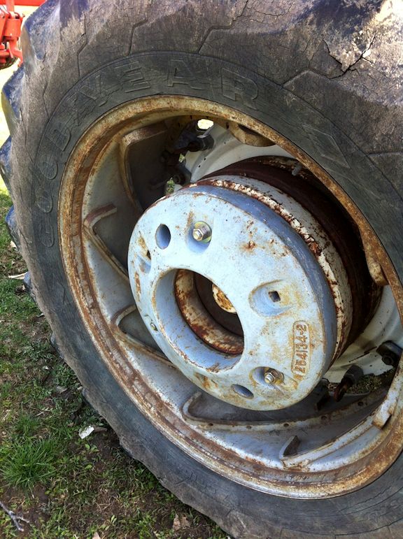

This photo shows the tractor's rear power shift rim slid out & its weights. Those are 4 - 300 lb weights. The 18.4-38's do not have any fluid in them.

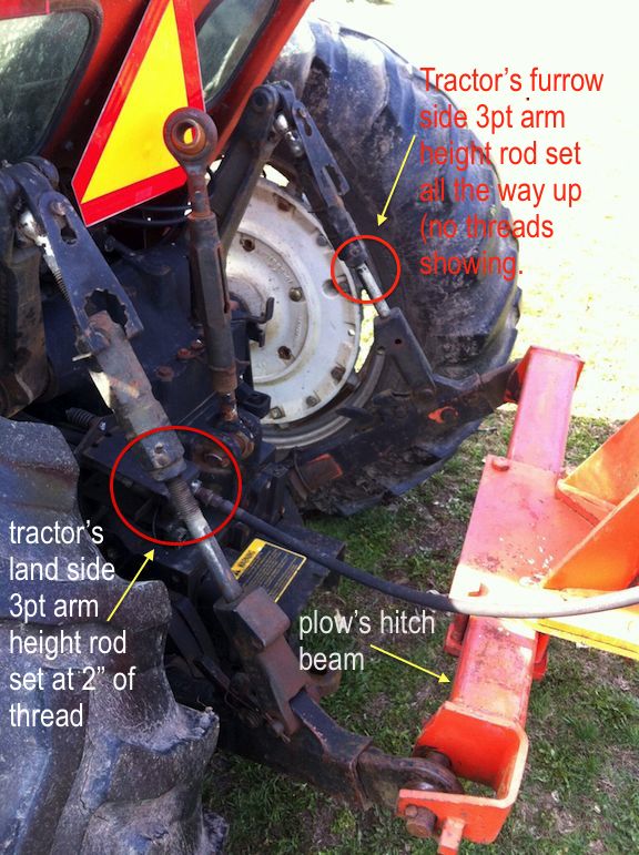

This photo shows the AC 2000 plow's lower 3pt adjustable hitch beam. Please note how the plow's hitch beam bolts can be loosened and it can be slid either way, then retightened. It is positioned nearer to the furrow side. That setting allows the plow's centerline of draft to align more closely to the centerline of the tractor. In addition, when you move the tractor's right wheels into the furrow, it aids in keeping both centerlines nearer to alignment. It's not perfect, but close.
Also, note the adjustable rod heights of the tractor's lower 3pt arms. The arm (near the furrow) has been screwed all the way up (no threads showing on height rod). The other arm (on land side) is set about 2" lower (has 2" of threads showing on height rod). These height rods are used to level the plow once the tractor's right wheels enters furrow. The tractor will set on a slight angle with half it's wheels in furrow & the other half on land side. Once plow is level, adjust the plow's height gauge wheel to accommodate it while running.
Posted By: Tbone95
Date Posted: 21 Mar 2017 at 12:42pm
I always am baffled at how 2" on the lift linkage levels a plow when you're sitting 8" or more in a furrow. I do it too, I see it in the manuals, it's just "weird", that's all.

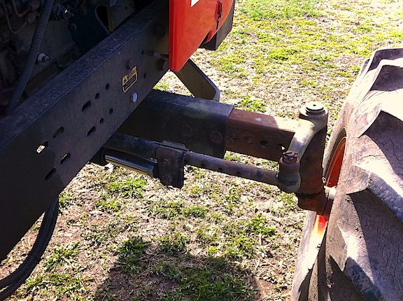

This photo shows the tractor's front axle (furrow side) has been moved out. Please note that both the axle & tie-rod get repositioned. The axle will usually move easily. The tie-rod can be a bear to move if it has not been moved in a few years. For a stubborn tie-rod, I discovered that heating the outer tie-rod tube with a torch & spraying a mix of ATF/WD40 lube it's ends helps free up it's inside rust. Once freed up, apply grease or anti-seize to tie-rod before moving in back to it's narrow position.
Posted By: Dans 7080
Date Posted: 21 Mar 2017 at 1:10pm
Tbone take an 8ft straight edge and make one end 8" lower than the other. Measure the drop in the center 3ft. It will be a lot less than the 8".
True, not a bad analogy. Just seems like the furrow, lift arm, and connection to the plow aren't all that far apart, but apparently it works out.
In your example, it's an inch per foot, so at 3 feet, 3 inches of drop.
When I got my 7045, stuff hadn't been moved in a very long time obviously. No powershift rims, torque and beat was the method. Wow what a bunch of work! Like you said, the front axel moves a bit easier than the tie rod, but they were plenty stubborn as well. The last thing I tried to move was the left front wheel out. Doesn't have a plowing function per se, but just to get it more centered to the rear wheel and for, well, cosmetic purposes even. I heated it, beat on it, beat on it with an air hammer, at one time I had almost the whole thing cherry read and submersed it in an old creamer can full of oil. Twice. Boy that was a stinky smokey mess. But it never did move. So if you ever see a 7045 coming at you and the front tires appear a bit oddly positioned.....It could be me!
Date Posted: 21 Mar 2017 at 1:25pm
In the 8' 8" analogy, any 1' of the straight edge would have a 1" drop. Any 3',3" and 2',2" and so on.

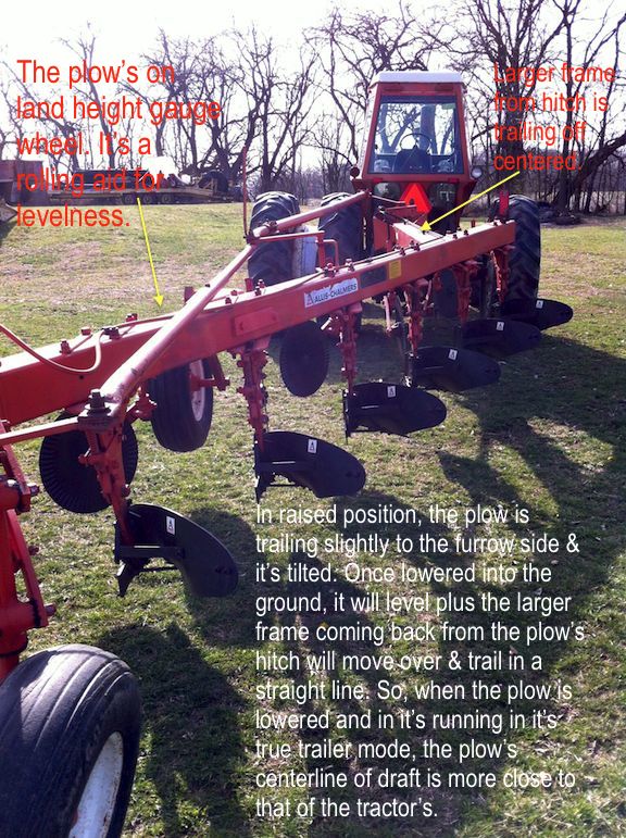

Posted By: AC7060IL
Date Posted: 21 Mar 2017 at 1:28pm
This photo shows the AC 2000 plow's tilt & trailering angle when it's out of the ground.
Posted By: Tbone95
Date Posted: 21 Mar 2017 at 1:38pm
That's another chunk of math that doesn't work out to me....You have an in-furrow plow. So the RH tires are in the furrow that bottom #1 is going to cover. So within a couple inches of clearance (for lack of a better word) the inside of the RH rear tire would have to be about 54 inches from the center of the tractor in order to be centered, no? Is that even possible? On my 7045 it is not possible.
Of course center of draft is an interesting concept. Tractor isn't level, so the lower tire gets more weight. Lower tire often times is on more firm ground for better traction, except when it's not like in greasy clay and the on land tire has some sod to hang on to, oh, and put duals up there for kicks! Hahaha. Just a lot going on setting up a plow.
Posted By: Tbone95
Date Posted: 21 Mar 2017 at 1:44pm
I can see it becoming parallel to the line of draft, but not at the center of draft, or even all that close....I have a 6 bottom in furrow plow, not an AC. I don't remember the exact dimension the plow book called for to the CENTER of the rear tire, but I think it was 34 inches? Something very close to that anyway.
