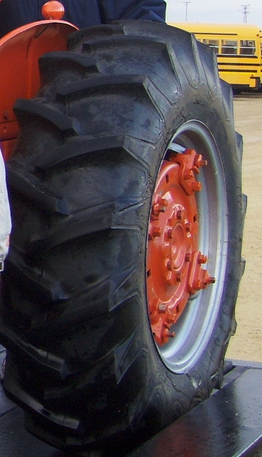

You could prolly fit a 14.9X24, easy, if you can afford them...Wink
Posted By: DSpears N IL
Date Posted: 22 Oct 2016 at 6:36pm
hubnut, the standard rim width for the CA is 10" with a 11.2 x 24 tire.
You should be able to fit a 12.4 x 24 tire on that same rim.
I have installed a 12" rim width with a 13.6 X 24 tire on my CA.
Hope ths helps you!
