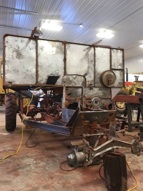

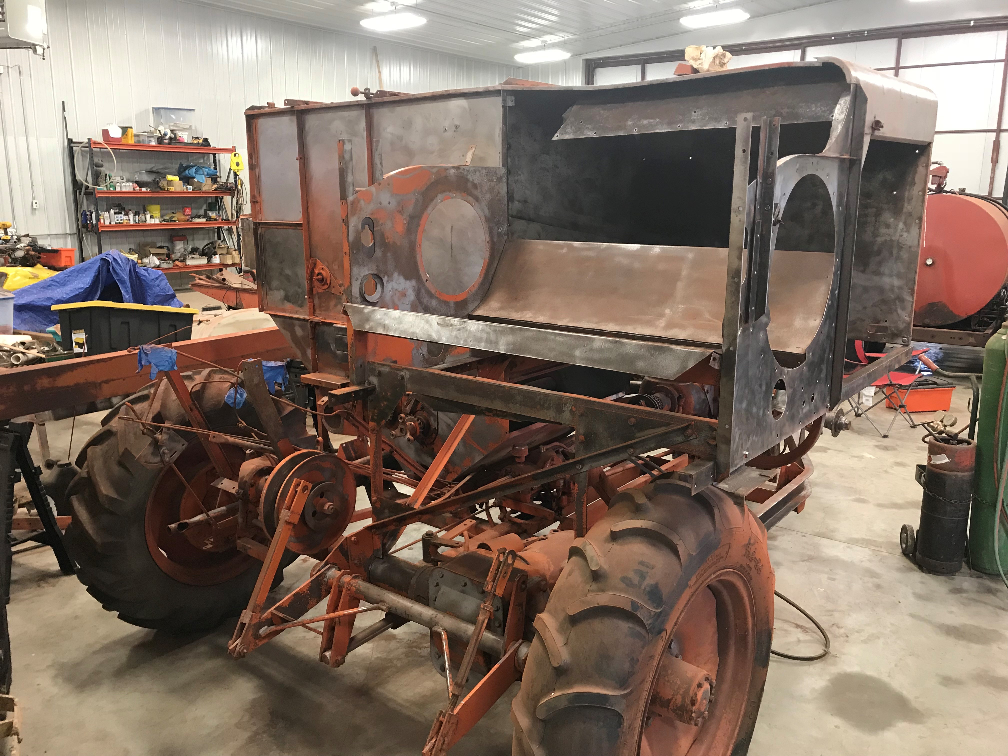

Progress on dismantling the SP 100.
Posted By: CrestonM
Date Posted: 09 Aug 2016 at 8:26pm
GIT 'R DONE!!!!! Whoo hoo!!
I still think what you're doing is great. I might advise carefully checking all the bearings (especially the ones that will be hard to access when everything is back together!!) That will make your life much easier once you get out in the field. You won't have to worry about a bearing going out that is a bear to access.
Of course, you're restoring it, so I know you know that! Big smile
Take care of my favorite!! Looks like you're doing great!! I'm hope someday I can find a nice Super 100 and do the same.

Posted By: rlee1
Date Posted: 12 Feb 2018 at 3:00pm
Hey Everyone. Roger wanted me to throw a picture on of where we are at with the combine. Last fall we got a lot of the smaller pieces primed and painted. Now we are finally getting back after the project and are planning on getting the frame painted in the next couple weeks.  I know he has a bunch of different pictures from last fall that i will try to get from him and get put on here. Unfortunately it has been a busy year and the combine project has been slow. Thanks for your patience!
Posted By: CrestonM
Date Posted: 12 Feb 2018 at 3:17pm
Wow, that's impressive. Can't wait to see the rest!

Posted By: rlee1
Date Posted: 22 Feb 2018 at 8:58am
The project continues... Figured 1 more weekend with the sanders and we will have it.

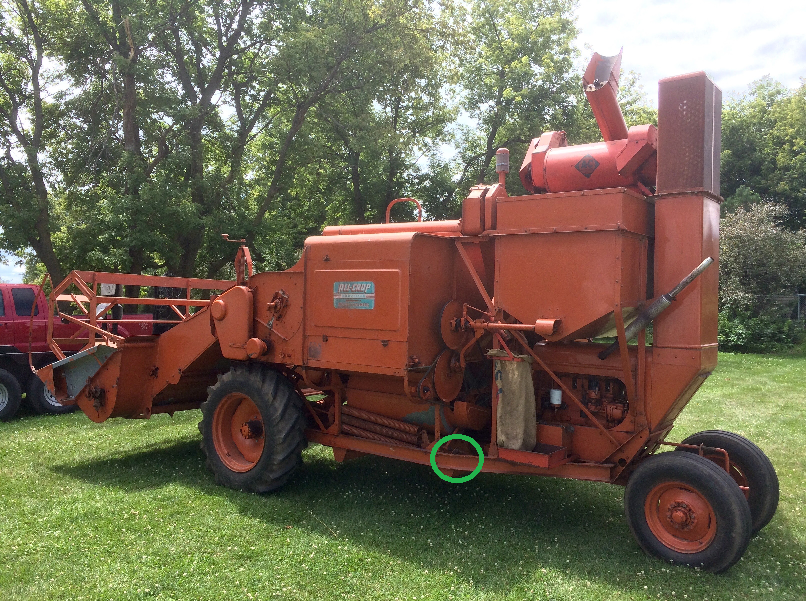

Where is the serial number located on the super sp 100? How much do one of these sell for in good running condition?
Posted By: CrestonM
Date Posted: 03 Mar 2018 at 11:42pm
Serial number on a SP-100 and a Super 100 are in the same place. Stamped on top of the frame, on the left rear side. The draw bolt for the header counter balance spring usually points right at it.
The green circle in the photo below shows the location.
As far as worth...do you have any photos? The cheapest 100 I've seen was $10, and the most expensive was a restored machine (Super 100) for $8,000. Most I've seen are in the $1,000-$3,000 range, although I have seen a couple bring $4,000.
