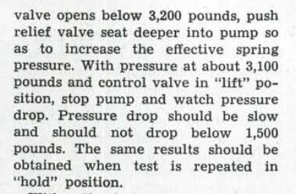

When the pressure ot 3200 PSI is correct. But the implement on the lift doesn't stay on the hold position.
Does it means that the Relief valve is leaking?
What is the symptom of a Discharge valve leakage?
The manual says : pressure is 3100 lbs. on properly functionning pump , .... there will be a slow dropping of pressure ....  the pressure become stationary at 1500 lbs.
Does this means that the normal hold pressure for the implement up is 1500 lbs, for example during transport or everything else.
So to be clear and well understand. The lifting force would be at 3200 lbs, and then the load holding force would be lower at only 1500 lbs.  Is it correct?

Does this correct understanding ? The lifting force would be at 3200 lbs, and then the load holding force would be lower at only 1500 lbs.  Is it correct?

Yes Steve. I understand that. My trouble is that the manual says hold pressure 1500PSi.
If i take your example if the implement is 600pounds, need 2000PSI to hold for the transport. Does the system will able to maintien up the implement? This compare to the 1500PSI hold pressure ?

i have never heard of the 1500 psi hold pressure.. I thought the valve would hold any pressure under 3200 psi... depending on the WEIGHT of the implement.. All of my implements will stay FIXED and not drop in the hold position.. Of course none of them weights more than about 400 pounds.
Points: 89039
Post Options Post Options   Thanks (0) Thanks(0)   Quote steve(ill) Quote  Post ReplyReply Direct Link To This Post Posted: 2 hours 7 minutes ago at 9:00pm
the valve does not have a 1500 psi set point or hold pressure. I think what the book is saying is the valve has some INTERNAL CLEARANCES and the pressure will leak off slowly from 3200 psi.. If the weight of the implement causes the pressure to continue to fall below 1500 ( after a period of time), then the internal clearances on the check balls and spools is getting out of SPEC.... How "FAST" it leaks off and if that is "OK" is determined by the operator... Most of my implements weigh less than 400 pounds and will stay up  ovoer an hour ( some several  hours)... if it leaks off in 2-3 minutes that might be a problem for some..
