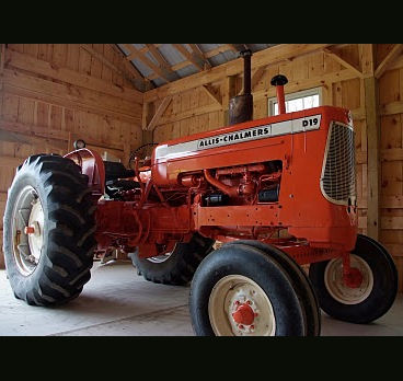

Okay, here's a very basic question from a new member, me.  I have a D19 from 1960. It runs great and I only use it to pull a 6 foot brush hog and mow my 3 acre field.  I have to change the oil. Can you recommend the best place to get an oil filter?  I would also love to change the air filter. Is that available from reliable retailers?  Thanks in advance for good information. I appreciate it.
