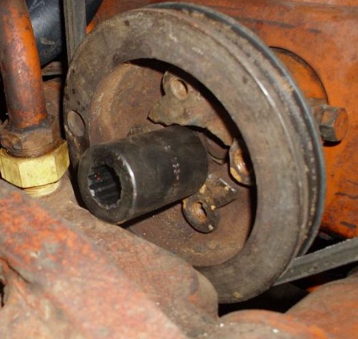

Okay, got a little done yesterday afternoon and last night:

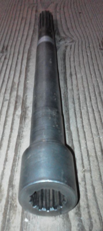

Got the coupler... this fits a 7/8" x 13 spline shaft.  It's a little bit long, but I've got a shortener in here somewhere...

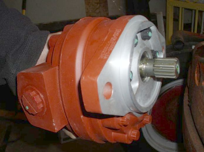

Here's the pump.  It's an EATON / Cessna, about 2.6gpm... I posted this, and the coupler part number and source in previous post.
The form-factor of this pump... actually the standard mounting face, is an SAE B 2-bolt mount.  The distance between bolt and pilot centers is standardized, as well as hole sizes.  There's several different shaft styles that are common to the SAE B, I selected 7/8-13 spline for two reasons-
FIRST... it's a common size also used in SAE A pumps (which, for someone wanting less volume, you can simply substitute a smaller pump, and use the SAE A bracket sizing)... and
Second, because I"m making this setup so that I can easily pull the pump off, either for service, or to pull the shaft out, thus, removing the engine load when I'm not in need of live hydraulic power.
FINALLY, I'm not using a 'soft' coupling or flexible, because I'll be making the mounting arrangement so that the pump is free to 'float', thus, it will WANT to maintain alignment with the crankshaft centerline.  There's enough play in the splines (not lots, but enough) so that they'll slip together, and the weight of the pump and plumbing is well within the pump bearings' support capacity, the only thing the bracket will have to do is 1) keep the pump from falling off, and 2) keep it from spinning.
Many live hydraulic kits rigidly mount the pump to the frame, and then use flexible couplings at both ends of the shaft.  This means the coupling becomes compliant, subject to wear and stress over time, hence, contributory to failure.  One of the worst things I can think of here, is having the coupler bolts break off, and having three more in there that I can't back out without taking the bolster off, or worse yet, pulling the engine.  Next, I'd hate to hafta try to dismantle it with the pump and plumbing in the way... it'd almost certainly involve applying a cutting torch or sawzall to the shaft to get it out.
An IDEAL mounting situation, would be nothing more than sliding the pump onto a coupler right at the crankshaft pulley... and then putting a torque-arm on the pump that keeps the pump from sliding out.  Bolster is in the way here, so I gotta 'stretch' it out a bit, which means I'll hafta keep the splined shaft straight, so the pump doesn't 'wobble', but if it does, the mount will allow it... it'll just vibrate alot.  Luckily, my coupler-shortner is also a shaft-straightener...

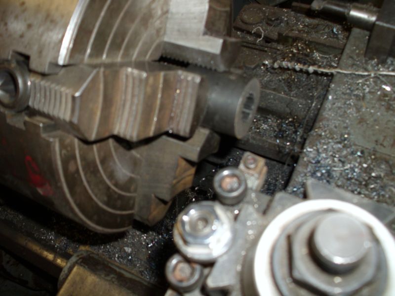

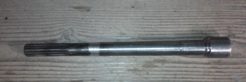

So here, I've used the coupler-shortener/shaft-straightener (also square and oblong roundener, and if I so desire, cam-lobe-maker:
First, I sawed it off with a bandsaw, then I put it in the lathe, and cut it down to appropriate length (trued up the end, 'cause bandsaws ain't known for precision)... then I cut a shoulder in it.  I'll cut a plate that fits the hole pattern and fit the coupler in there.
Now, for those of you that are machinists, the rest is elementary, but most folks don't have a lathe in their workshop (much less five), so bear with me while I put a little explanation here...
The mother of ALL machine tools is the lathe.  A lathe holds and rotates a workpiece, while a cutter is put against it.
The basic concept is making something round out of something that isn't, but what's REALLY happening, is that you're establishing an AXIS, and then making CONCENTRIC CUTS around it.  This is important to remember, and when I make the rest of the coupler, I'll explain not only how I do it, but WHY I do it that way.  With ANYTHING, there's always more than one way to get something done... when making precision parts, there's advantages and benefits to every method... but also costs and challenges.  Operating machine tools is only a small part operating, and the rest is about thinking ahead so that you do things in an order that make your workpiece more accurate at each step, rather than compound an inaccuracy at each step.  In the case of this collar, I put it in the lathe chuck, and used a dial indicator against the OUTSIDE of the collar to get it roughly centered... then I took a piece of shaft material, polished it, and slid it into the splined center, and put the indicator against IT... and adjusted the chuck again.  This is because the collar's hole and splines MAY NOT have been concentric to the OUTSIDE in manufacture.  These collars are clearly US-made, by a reputable manufacturer, because it was within 0.0004" of concentric.  I also checked the amount of 'wobble' at the far end of the shaft, and found that 18" out, it was still under 0.0007", so really danged true.
Many (like the imported sheaves and collars found at farm stores and import-tool outlets) are off by lots... 0.004" or more... and they're frequently way out'a square (they'll wobble like crazy 18" out) so if you trust the OD, you're screwed- it never runs true.
More on this later!

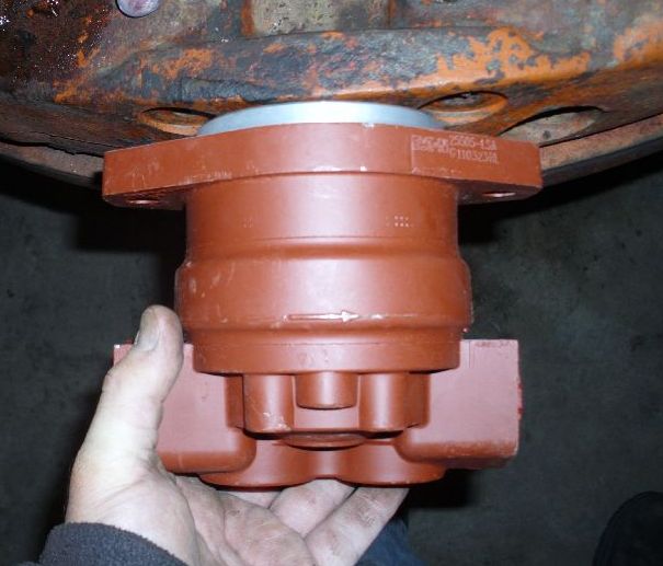

Here's a quick look at how the pump fits the front of the bolster.  In finished form, I probably won't have it recessed that deep, but we'll see what I can do to get it close.  I don't like big things hangin' out the front, to get tangled up in stuff.
Notice the direction arrow on the pump?  Handy!!!  Yes, the crankshaft, when viewed from this end, is spinning clockwise.  The pump, since it's FACING the engine, must be the CLOCKWISE type.  SOME pumps are reversible... if you're willing to disassemble them and re-orient some components, but many aren't.  IF you look in a dismantled pump, you'll see that there's little passages at each end... they go from one side cavity (the high pressure side) to the bearing shell.  Then there's oftentimes a passage that goes from the far end of the bearing, to the LOW pressure side.  When operating, the pump's output pressure forces oil into the bearing space, to hydraulically 'float' the shaft between bearing and shaft, just like the crank mains and rods of an engine.  There's also high-pressure oil forced along the edges of the pump's gears to minimize surface contact force against the sealing face 'wear plates', cooling the gears and minimizing wear.  This is one of the first reasons why it is so important to keep hydraulic fluid clean, and level proper to prevent aereation (bubbles).
This pump ain't exactly cheap, but it should last my lifetime's worth of abuse with minimal care.  There's cheaper pumps out there, and different shapes.  I selected it for it's shorter length, side-ports, and robustness.  One could use a longer pump, with end-mounted plumbing, but it'd require additional plumbing fittings to reach, and would be very susceptable to pump and plumbing damage.

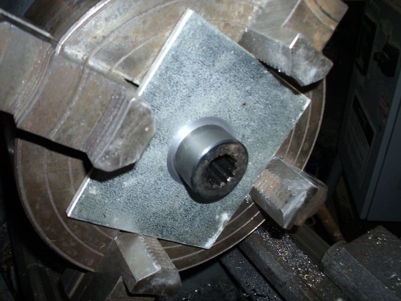

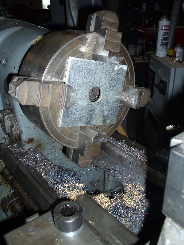

Busy with lots of things today, but I got this far...

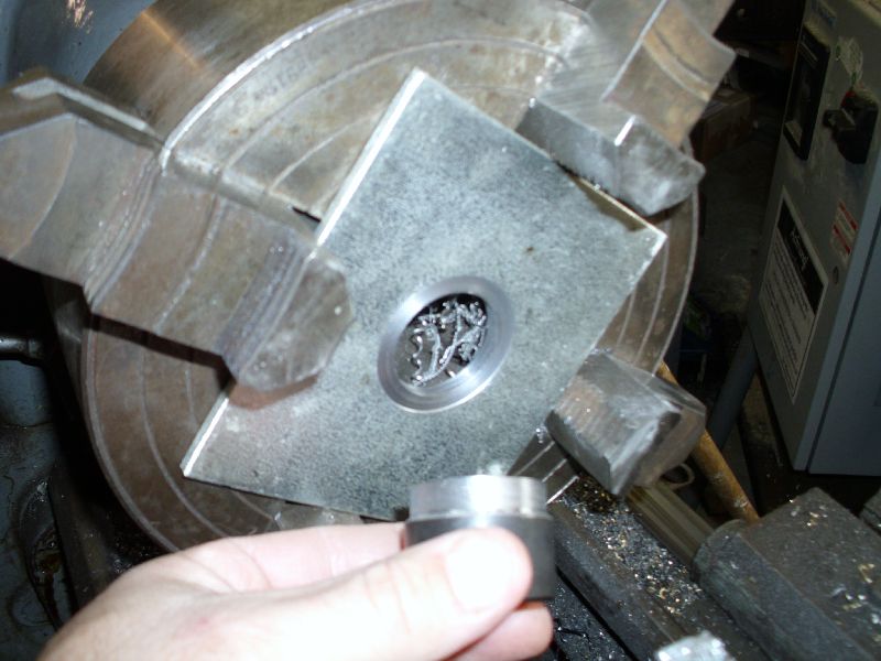

Found a perfect-sized piece of scrap... had a hole in the middle, so I roughly centered it...
There's the coupler piece down on the apron...
So I opened up the hole to proper diameter, and cut a flat area in the face to make the coupler's shaft axis WANT to be perpendicular to the plate...
And here it is, installed in plate.
Next, I gotta weld it in.  When making precision parts, one often times has to machine parts, then weld them together.  Best precision is attained by doing all welding FIRST, and all machining LAST... because welding always results in some type of distortion.  IN this case, I had to do first-operation... Fitting up parts that will be welded.
Once welded, I'll chuck it back in the lathe, make sure it registers on-center, and then do the final machine-work.  This way, I can negate any distortion of the plate or hub alignment by making a skim-cut to correct.  I'll also assure that the coupler is round, centered, balanced, and that the hole pattern is properly located.

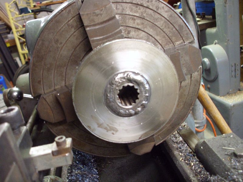

Post Options Post Options   Thanks (0) Thanks(0)   Quote DaveKamp Quote  Post ReplyReply Direct Link To This Post Posted: 14 May 2011 at 11:13pm

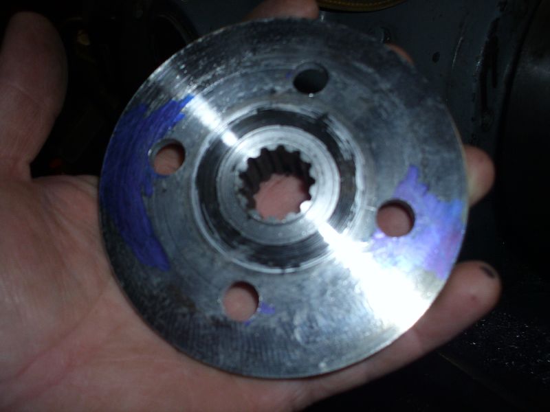

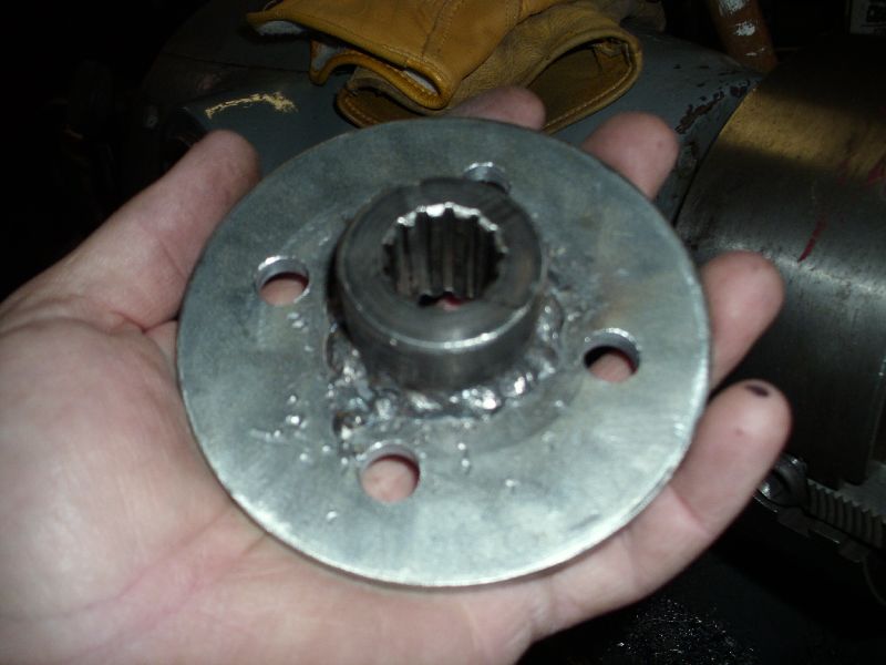

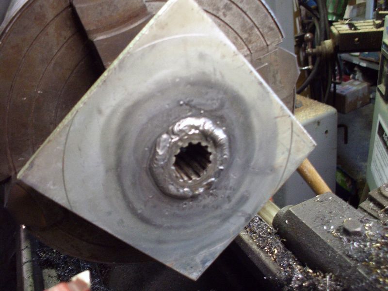

Okay, so I had to take a couple of weeks off of shop-time to drive down to Tennessee to install some machines... then race back and bury my grandmother... and things are now getting back to normal, so I spent about half of today in the workshop.
So I welded the turned coupler section into the piece of scrap plate.  Welding quality, from a cosmetic point of view, was miserable... humidity has been really high, and that box of E7018 soaked it up pretty good... didn't help that my mask needs a new glass, and my right arm is still pretty lame from neck surgery a few weeks ago, but it IS improving:
Now, important to note that you always do weldments first, followed by machine work.  This way, thermal distortion that occurs, can be corrected by making appropriate skim cuts in machining process.  The only exception here, is when you need to use machine tools to FIT UP the parts being welded... which is exactly what I did.
Next thing to note-  I clamped these pieces together, and tack-welded the BACK side together first... then I allowed it to cool, and checked to make sure that it was actually welded in flush.  Typically, when welding, the weld will either PUSH or PULL the parts.  In this case, I welded the back, knowing that my tack-welds will PUSH the components together tighter, rather than pull them apart (and not spin true).  After tacking from the rear, I welded the front (in 4 beads... two opposites, cool, then two opposites), and then put a bead around the back.
Chucked it in the lathe, cut the excess off (to make a round plate, and skimmed the back (where it'll bolt to the sheave) to be totally flat.  I used a piece of carefully fitted rod against a dial indicator to make sure that the HUB centerline was concentric to the spindle axis, so that the coupler face would make the splined shaft run true.
Then I located and drilled holes appropriate for studs into the front sheave...
Yep, that's a shameful-lookin' bead, but can't turn back now or re-weld, it'll destroy the work.  Plenty strong, so not worried about failure.
Back side shows the flush/smooth mounting surface, as well as some blue ink left over from locating holes for a-drillin'.  Typically, a machinist will use blue dye to make scribe marks very easy to see... but I find that in most cases, all I need is a blue Sharpie... ink the area a little, and hit it with the scribe...

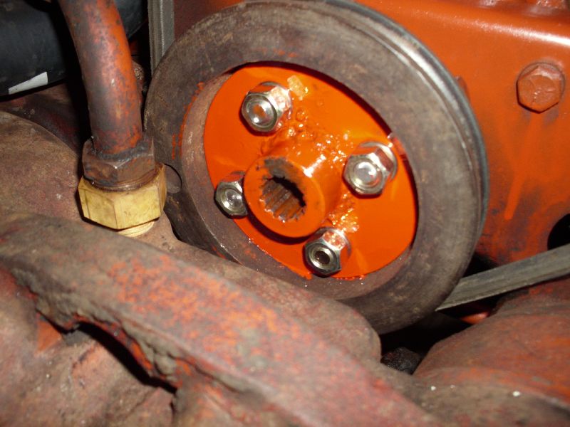

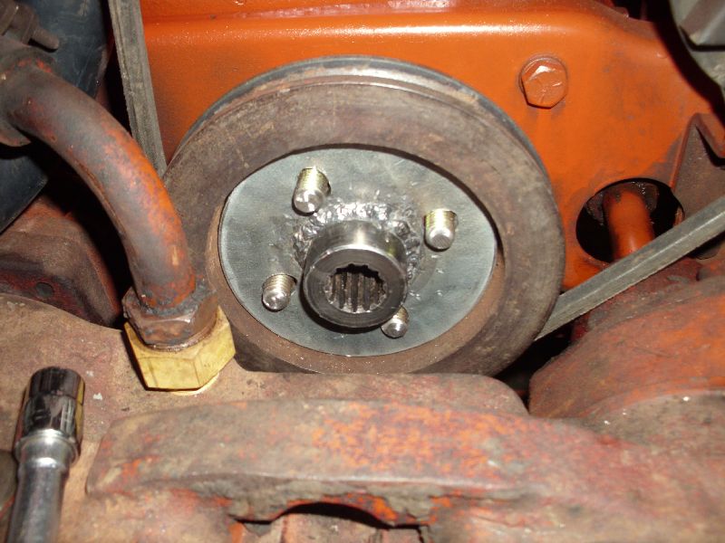

Next, is to cut some studs suitable for this setup...
I cut some Grade 5 full-thread bolts to appropriate length...
Test fitted everything... then yanked it back out, hit it with some orange paint... then slid back in (and got a grease-smudge on the new paint!)
Then I fired it up, and looked at everything spin...  and it spun nice and true!!!
Reinstalled the radiator shell, 'cause I need to move some stuff around tomorrow, and make a wire-installation plow... then make the front pump mount bracket system...

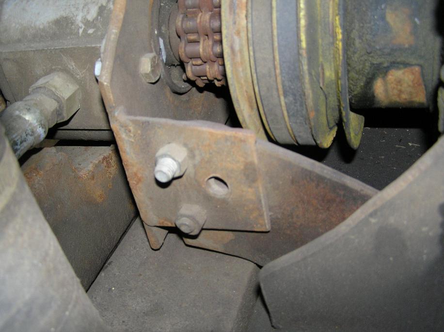

Jack(Ky) View Drop Down
Location: Ky
Points: 1153
Post Options Post Options   Thanks (0) Thanks(0)   Quote Jack(Ky) Quote  Post ReplyReply Direct Link To This Post Posted: 15 May 2011 at 7:38am
I made one like this for Herb (Ga) a couple years ago. I used the 7/8" splined coupling and welded it to a plate and trued it up good on the lathe. The splines seem to have plenty of room to allow for misalignment. His loader had the pump mounted to it so I made the shaft with splines so he could just unbolt the loader and back out of it and the shaft would slip out of the bolster and stay with the pump.JP

DaveKamp View Drop Down
Joined: 12 Apr 2010
Location: LeClaire, Ia
Points: 6089
Post Options Post Options   Thanks (0) Thanks(0)   Quote DaveKamp Quote  Post ReplyReply Direct Link To This Post Posted: 15 May 2011 at 10:26am
Cool idea, Jack!
One of the things I wanted to accomplish here, was make the coupler so that a guy wouldn't hafta take the radiator and front bolster off to install or change it... and while I installed this with that all off, there is clearance aplenty to do so.  The only thing a guy MIGHT run into, is if the sheave bolt-holes were full of crud... he'd have a cussing-circus of cleaning 'em out, but it can be done with patience.
Obviously, this coupler layout won't work for an early-style sheave, and I'll dig into that later, but for now, I gotta get this system goin' and get the backhoe mounted and operational.
The splines DO tolerate a little malignment... albeit with spline wear.  The more-true it runs, the less the splines 'scrub' on the couplers, hence, the longer everything lasts.
And there's really two aspects of alignment to focus on... first, making sure that the engine-side coupler runs true to the axis of the crankshaft... you want the centerline of the splined-coupler to be dead true to the crankshaft's axis... you don't want it to be too high, or too low... and you don't want it pointed out at an angle... you want it to be centered and concentric, so that when it spins, you can't see any sort of wobble, even if there's a 1' long shaft sticking out of it.  The second aspect, is having the pump lined up with that same axis.  The second is fairly easy to obtain once the first has been established... the splined shaft points the way... I'll be getting to that piece next.

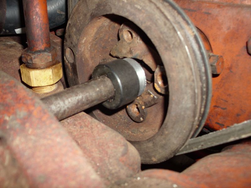

Dave, I have made several of those couplings by making the plate with the bolt holes for the crank pulley and the center hole. Then, fasten it to the crank, mark the position, so it always goes back on the same. Then, weld a stick of threaded bar to something on the tractor so I can fasten the die grinder to the threaded bar and have the cutter in the center hole. Start the engine at idle. With the die grinder "on", move the cutter to the edge of the hole. Grind til it is a perfect circle. Then, make a short piece of shaft in the lathe to just fit in the hole in the plate on one end and the sprocket hub on the other end. Take plate off and put shaft in for welding. After welding, discard piece of shaft. I use a double roller chain for couplings.
Edited by E7018 - 15 May 2011 at 4:23pm

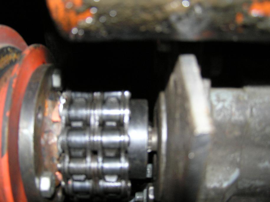

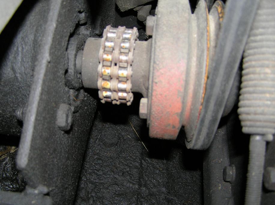

Although they're frequently used outside of the range, chain couplers are frequently recommended for use only under 1000rpm or so.  Nice thing is that they have a little compliance, easy to make (as long as you have some double roller chain and two sprockets) but they do take up precious space in comparison to a splined-sleeve.

That first drive is on my D8 Cat with the 8V71Turbo. Some day, you will have to get by here and drive it in a couple circles.
The welding is a bugger with a bad arm. Sometimes, I have to do way out of position welding with my left hand. Way up on something high. I can get it but not well.
My daughter is a physical therapist, do your exercises, they work.
There isn't room to use a chain coupling on a D17. Even getting the connector link in can be a challenge. Worse than it looks. I try to keep a roll of 60 2 cottered chain around to make couplings. Those couplings seem to stand more misalignment and angle than Lovejoy couplings.

Yep, and they tend not to break apart as readily as the tabs of a LoveJoy when the rubber isolator spits out.

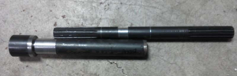

MACK View Drop Down
Joined: 17 Nov 2009
Points: 7664
Post Options Post Options   Thanks (0) Thanks(0)   Quote MACK Quote  Post ReplyReply Direct Link To This Post Posted: 15 May 2011 at 10:08pm
Easy way to make a front drive for D17 is to make a shaft same size as crankshaft, mount front pulley on shaft anm make it all on the lathe. Made mine from a D17 steering shaft and couppler. Couppler and end of steering shaft are hardened and will last almost for ever. Mine has been on there for 20 years, had it out last winter to rebuild engine. could not see any wear.   MACK

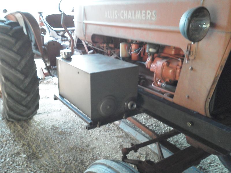

Okay, well, things seem to happen this way... but when I was in there changing everything, I took the time to flush out the engine, change the thermostat (stuck tight!), and rinse out the radiator... and it was pretty yukky inside.
After getting the coupler finished, I put it all back together, filled it with water, and run it a bit (to check for leaks).  All fine, so I drained and flushed it a little more... drained again... then refilled with a 60/40 mix of ethylene glycol and water.

Yeah, it's been a while, but I HAVE been nippin' away at this project.  I got the shaft made... here's what it looked like halfway-done...
Joined: 12 Apr 2010
Points: 6089
Post Options Post Options   Thanks (0) Thanks(0)   Quote DaveKamp Quote  Post ReplyReply Direct Link To This Post Posted: 25 Nov 2011 at 1:56pm
What I did, in the previous picture...
I obtained a PAIR of splined-shaft couplers, and a splined shaft to match the hydraulic pump.  These are fairly standard, but apparently not standard enough for a 'stock'
 shaft length long enough to make the reach from my crankshaft drive to the pump bracket up front.
So I took a piece of shaft stock, squared it up in the 4-jaw, and skim-cut one end, then I cut a segment down a bit.
Then I cut the coupler a little shorter (short enough so that it would fully engage the pump, of course), and centered it up in the 4-jaw.  Gotta note here- the splined hole was NOT concentric to the OD of the coupler, so instead, I put the splined SHAFT in the chuck, adjusted it to run true, then put the COUPLER on the shaft (held it in with the live-center), and skimmed the OD to be concentric with ID.  Then I cut a recess in the coupler to be about a thou SMALLER than the OD of the shaft stock.  I then put the shaft stock in the freezer, warmed up the coupler, then dropped the two together.  Upon cooling, they were not only very, very snug, they were dead-on true.  Then I applied a fillet-weld around the outside (with a MIG), and a rosette weld on the inside (with a stick).  Chipped out the sl*g and knocked the spatter away, chucked the SHAFT in the lathe, adjusted to run true, then stuck the splined shaft in, put live-center on the far end, and checked to see if it all STAYED true.
Rule is, always do all weldments FIRSt, and do machining LATER... well, sometimes 'ya can't... in which case, you always get the welding done, and leave yourself a way to CHECK out the results, and in the event something DOES get stressed out-of-true, you can always SKIM it back into a true state.
Next thing I did, was cut the splined shafting to appropriate length, and I turned it to leave about a 3/8" stub out the end 1" or so.  I cut the OTHER piece to proper length, and bored a similiar hole, about a thou too small, and shrunk, then welded the two together, then skimmed the whole works down to make a complete unit.  Don't see the photo here, so I'll post it later.

In the meantime... I found a hydraulic tank... about 18 gallons or so.  This one has baffles in it, and cleanouts... but interestingly enough, no suction strainer... instead, it had some sort of clamp-in bulkhead fitting that was long-gone when I got the tank.
I ordered a weld-in flange 2" NPT, and a suction strainer 2" NPT outside, and 1.5" ID.  I used a hole-saw to open up the original hole, then welded in the flange and installed suction filter.  Notice, it's located in a really nice spot-  suction line can come forward along the frame rail, into the proper side of the pump (yes, I thought about that beforehand).  I made a bracket and tack-welded it to a removable rail (made rails for both sides).
I'm still contemplating position here.  From a convenience standpoint, this is great- I can reach all the engine service points without removing the tank, and the tank is easily accessable.  On the back side of the tank (facing driver) is a combination level and temperature gauge, so perfect.  Problem is, it obstructs view to the right-front wheel.  I'm not row-cropping, so it probably isn't a big deal, but I DO maneuver into areas where being able to see that front wheel is important.  I can stand up in the op position and see the tire, just not while seated.  Moving it to the rear will make it so that anything being thrown off the front or rear tires will land ON the tank.  Moving it lower will cause it to be hit by the tire when the axle is all the way up (on that side) and tire is turned.  I haven't found any other places that are 'better', so without going to a different tank shape, this will probably be it... and I'll probably be mounting an 8D battery on rails on the other side of the tractor to match...  we'll see.

Here's the shaft.
Cool illusion on the second pic- taper in the shaft, and angle makes the image look like it's wider at the top!
Pretty simple assembly, really... all it does, is extend the engine's coupler from the engine, to a point in front of the front bolster.
When I machined this, I did what any wise machinist would do, and that is, use the splined shaft center as the reference for runout, to make it run true.  I used the unused portion of the splined shaft and couplers to MAKE it run true in the lathe, then I made cuts across the OD to yield a 'reference surface' that was concentric to the shaft centerline.  This is very important, because these parts frequently aren't  concentric... that coupler was clearly a couple thou out on the OD, and the splined shaft was mebbie half that.  Get 'em 'phased' right, and the net runout will be very small, but phase 'em wrong, and it's alot of wobble over a foot's span.  Now, it doesn't matter which way I install it, it runs dead-true.
There's more than enough coupler depth to fully engage the pump's splines, and still leave plenty of room for motion.  Need to leave enough slack so that things can flex a bit, even though they really shouldn't.
Next, I'll make a bracket to hold the pump that 'floats' with the shaft, but restrains the shaft against torque load, and finally, allows easy removal and installation of this shaft for those times when I don't want the added mechanical load on the engine.  Stay tuned!
JK in Pa View Drop Down
Location: Dushore, Pa.
Points: 164
Post Options Post Options   Thanks (0) Thanks(0)   Quote JK in Pa Quote  Post ReplyReply Direct Link To This Post Posted: 27 Nov 2011 at 8:58am
Some nice looking machine work there, Dave.  I am curious why you are using such a small pump.  I installed a vane pump in my WD about Twenty years ago when I built my Backhoe.  I used a 12 GPM@ 1200 RPM.  Worked out to be the perfect fit.  Good Luck.
