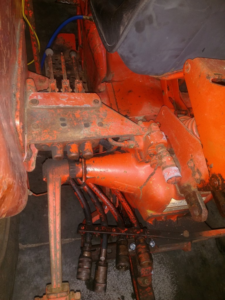

The remote hydraulic connections are a project as well.   Have to come up with a way to support them better, as they have just about pulled the PTO shield into a pretzel.
Anyone have a good idea on how to support them, without interfering with everything else going on at the back of the tractor? Pictures please if you have made a working support.

Do yourself a favor and pull the loader brackets off and save them vs. retrofitting an anti- sway device. Your best bet is an OEM 3-pt. adaptor that was an option for the tractor. Even without the center sliding support, sway is far less than you might imagine with only the top light duty sway control that mounts on the bail supports where the drawbar usually mounts (small chains for each side). The uprights on the adaptor that latch into each claw are made to allow side to side "swing" to an extent. I have run a heavy Bush Hog 6' unit for years on a D15II, just check the bushing spacers at the swivel points as they will oblong out over time.
There has been posts showing the OEM adaptors and they are out there if you look around. I swapped back over to my 3-pt. adaptor just this afternoon as I had been pulling a trailer with a ball in the drawbar the last two weeks clearing limbs. Rarely do I use the drawbar and I have an aluminum bread cart to drop/store my 3-pt. adaptor when I use the SC blade or drawbar.
Bread cart works nice as just the right height, adaptor off or on in 2-3 minutes for an old man. BTW, if that unit has the OEM multi-spool hydraulic valves, it is pretty rare.
Additional single spool units are not that common either but the multi-spool is far less common from what I have seen over the years.

I would be very happy to find an OEM AC adapter, as Tim suggests.   Unfortunately, this area is fairly thin for AC equipment, and it commands quite a premium.  Snap coupler 3 btm plow advertised for 600$ Canadian, about 500 US.  Did not last long.  And the supply is pretty limited. Most tractors here were used with drawbars, and trail type implements.
I took a pic of the hydraulic controls and connections.  Looks a lot like the valves on my 170.  Except for the single acting coupler next the seat.  No idea how common this many valves were, but given there was a loader on this tractor at some point, probably was bought with it.
I ordered a owners manual for the tractor but have not received it yet.  Would be interesting to see what every thing does.  The lever next the seat is for the snap coupler, and the next two levers are for the remote quick couplers, but next the fender is a peculiar looking "valve".  Perhaps a diverter for the remote single acting cylinder?

From what I see I'd take a piece of 1x1 angle, and mount the remotes to the PTO guards bolts.  Of course, the thicker the angle, the better, and you'll have to notch a leg off, to mount the PTO guard.
Also, don't use that upper 3 point bracket, welded to the seat bracket, unless you want a toplink enema...  Most of the good 3PH kits come with a 1/2" thick toplink bracket, that bolts under the seat bracket, in the same holes...

I had a look at the seat bracket with the 3 pt center link and came to the same conclusion. Cut it off. Already bought one of the heavy adapters that bolt under the seat, just waiting for it to get here. I'm thinking that the new center link bracket that will be put on might be the better attachment for the hydraulic quick connectors.
The PTO guard has taken a beating already from the quick connects. Will get it straightened out. May use the bolts as the attachment for the quick connect angle iron support as opposed to the bracket itself if I don't come off the center link bracket.
Dug through the service manual and found a good explanation for the hydraulic controls. Still will have to hook up a cylinder and experiment to clarify exactly how the transport valve works. That is the one closest to the seat. Somehow limited to 1000 PSI and allows the cylinder to work at the low pressure but defaults to the Snap Coupler as soon as the pressure is above 1000 PSI?
