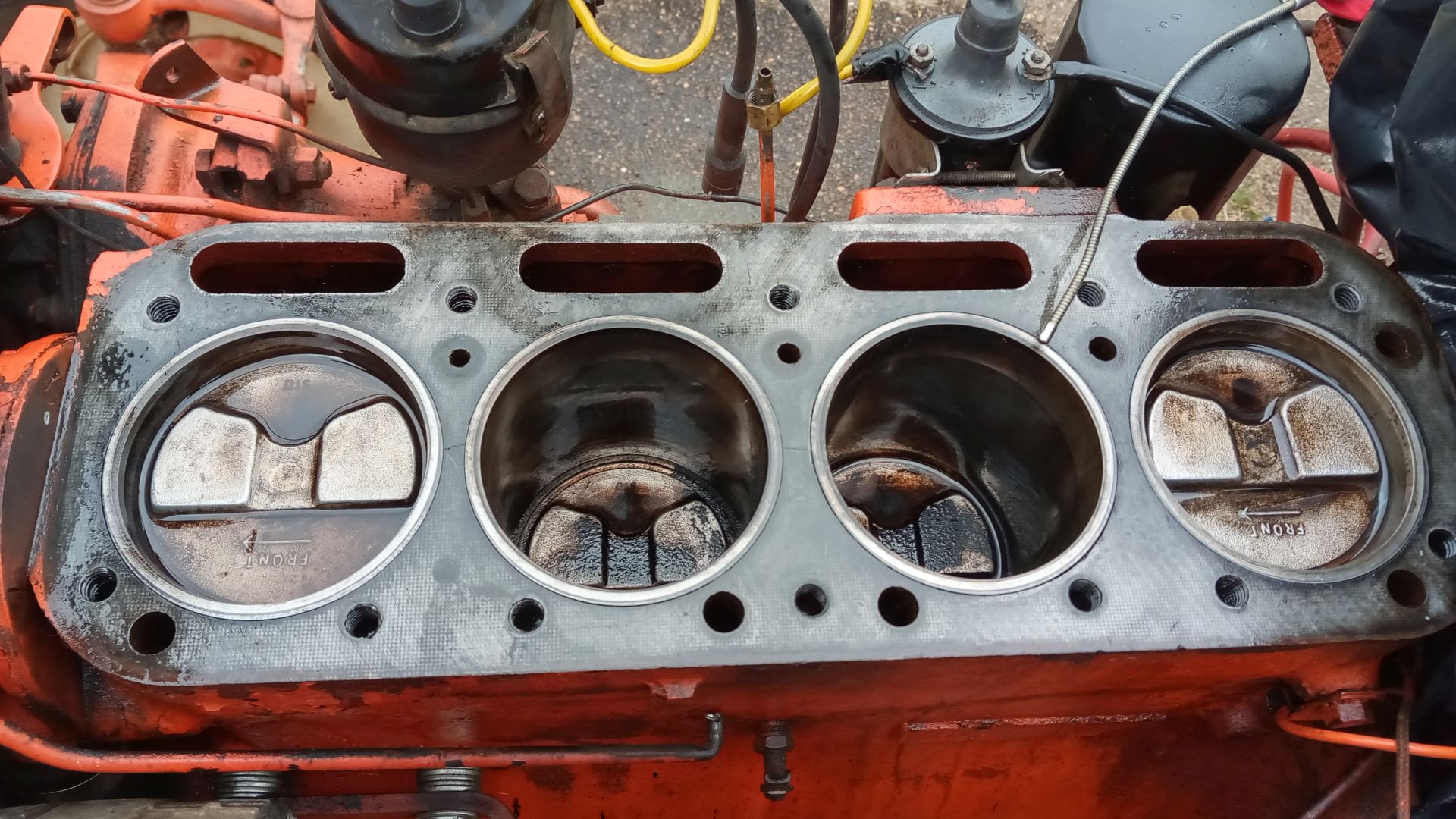

I think I seized it a few weeks ago.  Right now, I'm chalking it up as overheated seized and cracked due to lack of coolant, but with a 20% chance of something else.
The first start of the year, I let it idle for 2-5 minutes until I heard a weird sound and before I could get back to it to shut it down the RPM had gone lower and lower until it stopped, over about 5 seconds.  I forgot to check the coolant and it was down a half of a jug.
I let it soak for 2 weeks full of 50/50 acetone/ATF for 2 weeks, it all went down, every cylinder was dry when we looked at it 2 weeks later.
When in high 4th gear we can rock it forward and back and the fan blades turn 2-5 inches on a good budge (but the pistons don't seem to move unless it's a very small amount that can barely be seen).  When rocking it when the fan spins a couple inches there's a "bad bearing" sound.  Kroil + dead blow hammering says piston 1 is in a different state than 4 but it's too subtle and I'm too inexperienced to be sure or speculate why. We tried pull starting it but it's far too seized (or jammed?) to turn.  I still don't know what the bottom end looks like so I'm not ruling out the idea that something broke down there and is jamming it.

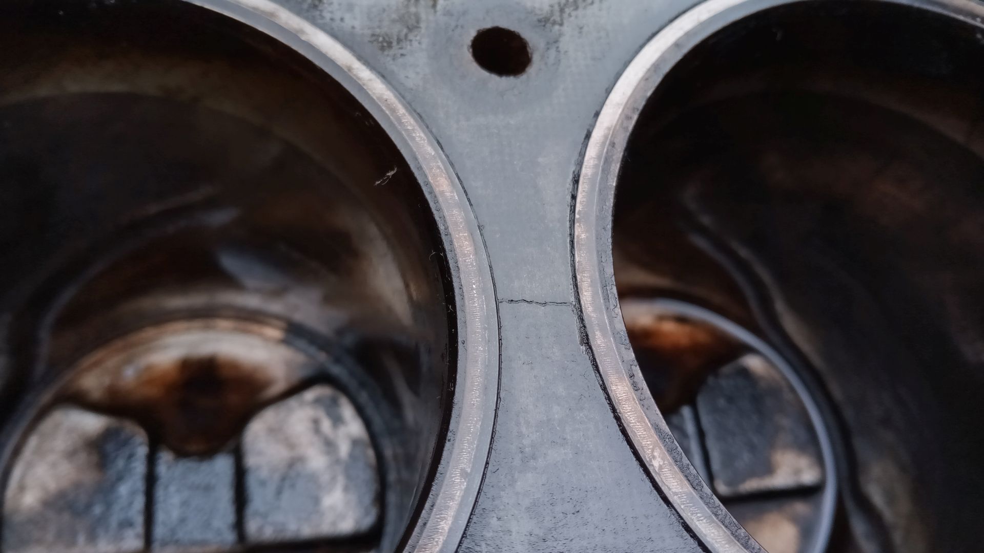

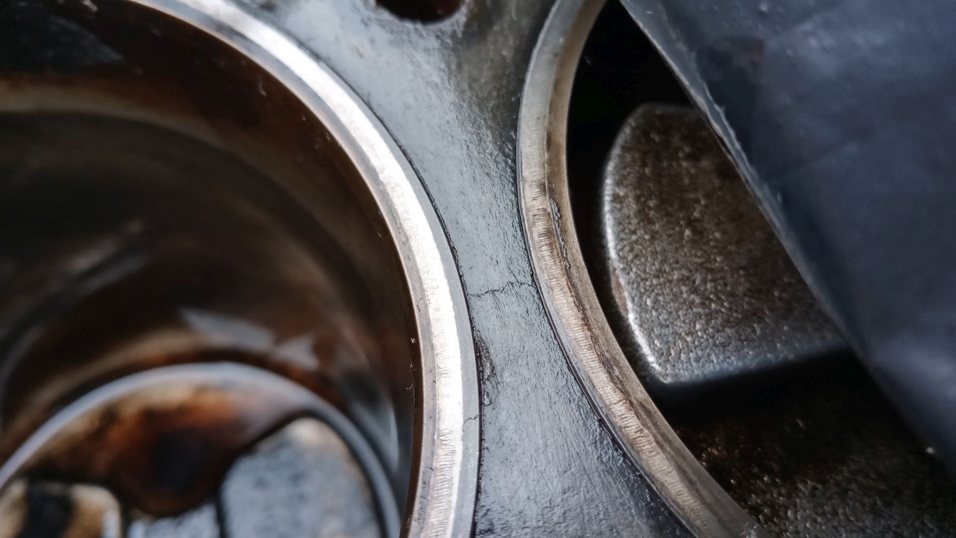

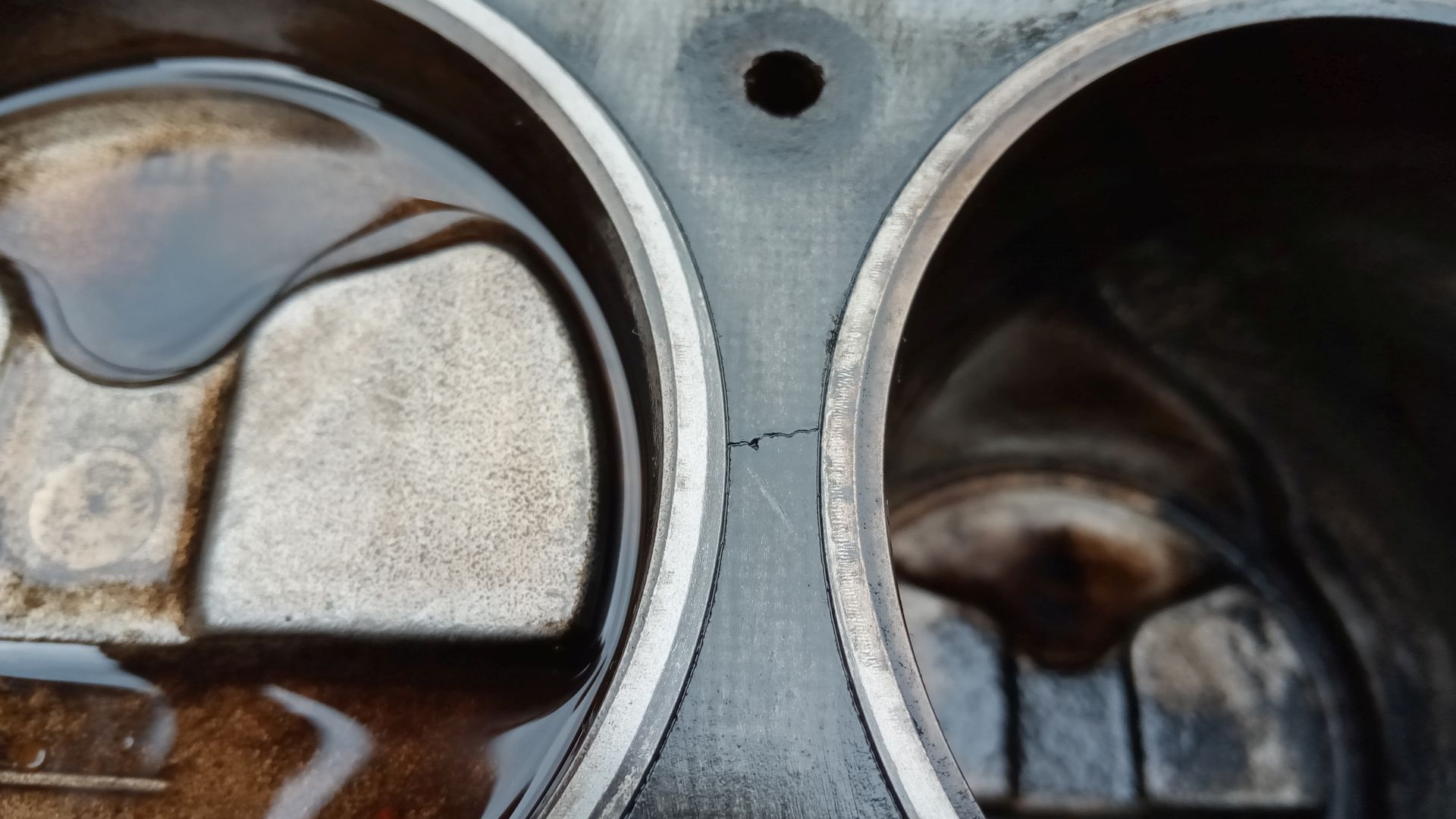

About the cracks, is it possible that it was like this before?  Is this totally defunct, unusable, or this is perhaps common to find in a running capable effective D15?  Is there a possibility it was already cracked like this before?  I'm trying to hold onto the hope that I can fix it restoring last year's performance, and if I do that it won't be crippled by being cracked because if it already was cracked last year then I didn't even notice it.  They are cracks, right? - this is my first 4-cylinder teardown so I can't be sure that it's just hopeful ignorance that they're not cracks or that it runs fine that way.

The cracks are probably not a big deal. They normally seal with the head gasket. If the bottom web is cracked then that's a issue. I would drop the oil pan and see if there's anything obvious going on. I don't think being only that low on coolant for less then five minutes would be an issue

I'll bet the oil pump lost it's prime and you didn't notice the oil pressure was zero. Low on coolant 2 quarts under no load was not the problem.

I ran a B motor low on coolant ( about a gallon) and it "slowed down and locked up" as you said... The liners got hot and the rings  "STUCK" and froze the motor...... Since you said you put penetrant into the bores and it ran past the rings into the crankcase, you COULD have the same problem i had..
Your oil system may be OK if you just overheated the liners / rings and they STUCK... Cracks in the block are OK in the top.. I would pull the connecting rod bolts and lift the crank shaft out... then smack each piston on the top and see if they will pop loose from the liner...  I got by with honing the cylinders, same piston , new rings...  If you can get it apart without breaking a piston or liner, that would be good...
When liners are out, check the bottom o-ring seal in the block as mentioned to see that this area does not have a CRACK that could leak coolant later on..
Points: 88661
Post Options Post Options   Thanks (1) Thanks(1)   Quote steve(ill) Quote  Post ReplyReply Direct Link To This Post Posted: 18 Jun 2023 at 9:51pm
Either way, your not going to know anything until your remove the crank, look at the bearings, and get the piston out of the liners...... but YES.. those cracks will be OK.
