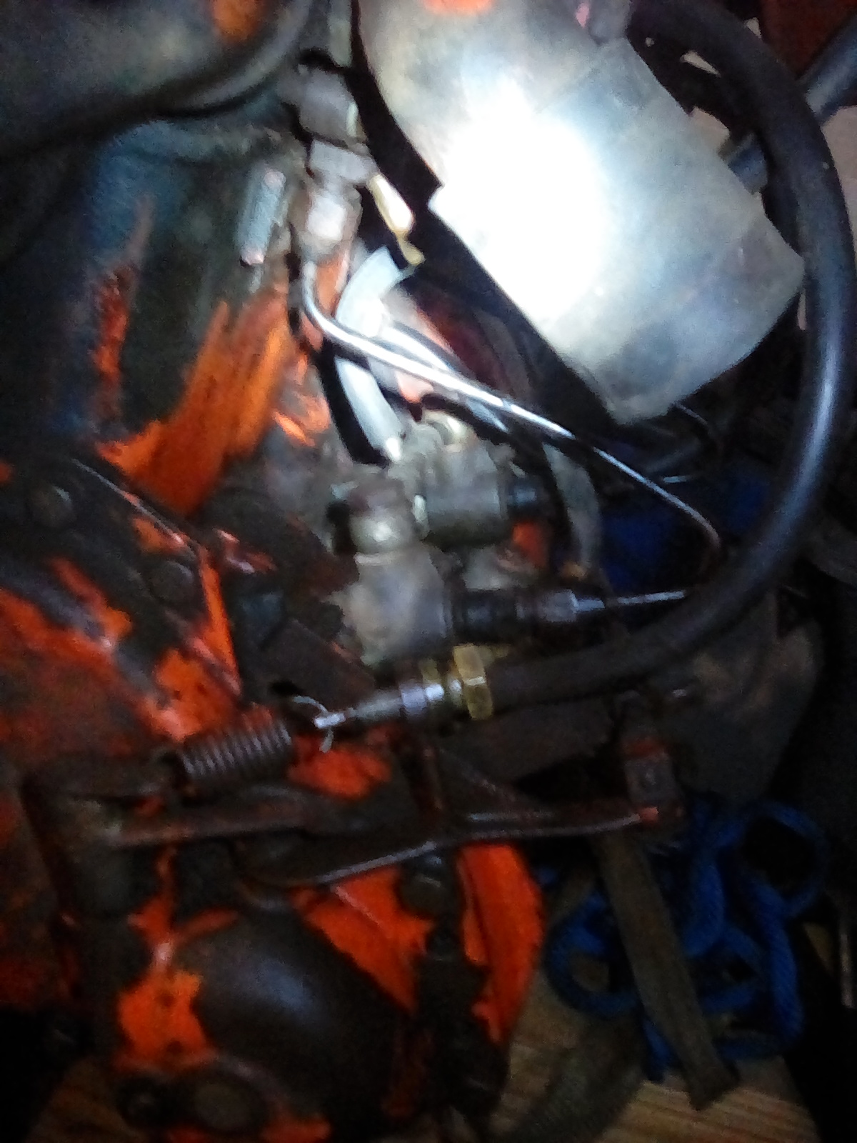

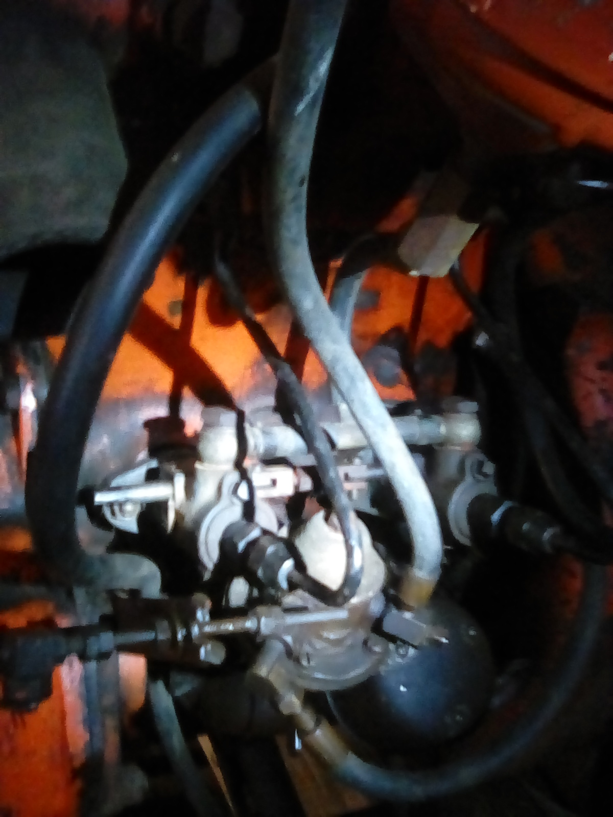

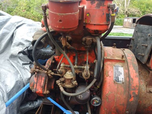

Well it's actually a Buda generator (2bdg77). If anyone has info on these pumps, please feel free to share!!!!
They are inline Bosch pumps. The camera-phone is older than the engine lol

Post Options Post Options   Thanks (0) Thanks(0)   Quote PizzaMan5000 Quote  Post ReplyReply Direct Link To This Post Posted: 14 Mar 2021 at 1:31pm
Note: missing linkage from injection pump (rail?) And fuel return lines are missing.
I have yet to find any info on this fuel system other than they are Bosch "bryce style" fuel pumps.
