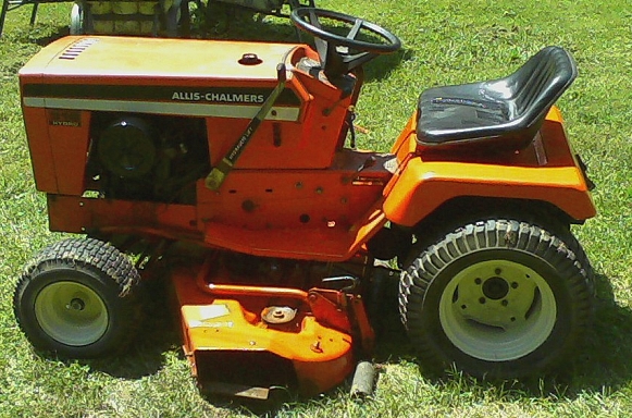

Good Morning . . !
I have owned My Tractor since 1982
I recently did a small rebuild on the engine on my 916 H . .
New Piston..rings..rod..seals..ponts..plug...gaskets etc..
Muffler..not OEM cuz I couldn't find one anywhere.
We turned the key..and nothing..! Starter works good..turns over only after
connecting straight to "positive". Having an OEM Ignition switch..I replaced
every wire with new connectors. I have a New battery..new cables.
I went by the Wiring diagram from my OEM Book..and re-verified
with everything I could find online.
I have 12.96 volts at:
the Battery side of the solenoid.
the Ignition switch.
the both sides of the Ammeter
the coil..points..etc.
the center post of the start solenoid when I turn the key
( which my guess is the blue wire that connects all the safeties
together..according to the wiring diagram )
....But NOT the side of the solenoid that connects to the starter..
Trying a new solenoid from a 94 ford explorer..I get the same result..
...Am I overlooking something...? Or is the Solenoid Bad..?
Like the screwed op saying goes...
"It worked when I shut it OFF . . . ! "
Any Help would be Wonderful . . .!
. . . Rodney . . .
