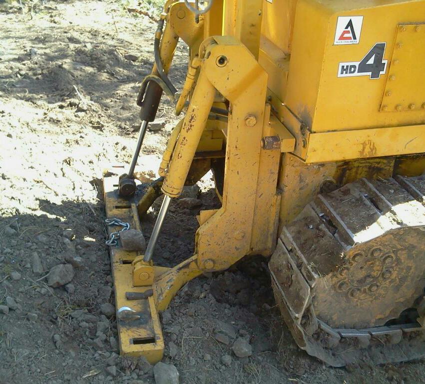

I would guess the shuttle pack on reverse gear is not holding. The shuttle changes the direction of driven gears in torque tube housing. I would first start there. Probably the cylinder that activates is is losing pressure on reverse side. I don't have my manual here at home. I would like pics of your ripper and the cylinders.I wonder which variation you have. Thanks Tracy Martin
Posted By: sweetlogs
Date Posted: 22 Mar 2013 at 9:16am
Tracy here is the ripper set up. Tore the side cover off the converter resevior and only had 1 out of 3 o-rings on the lines there and a glob of blue silicone. Thought i might have found my problem. Put it back together and it worked for a second the no more reverse again. guess i will be back at it when it stops snowing.
 Check the fluid level in all the compartments. If reverse worked for a second, did the hydraulic fail or did it come out of gear? Could be reverser pack isn't holding. With the missing Orings and blue stuff, someone has had the problem before. How strong did it move in reverse when you fixed the oring issue? Do you hear a gear grind of any sort? Tracy Martin

Posted By: Coke-in-MN
Date Posted: 24 Mar 2013 at 10:34am
am I seeing something like the the track is on wrong direction - grouser on back side of track and open side of track is forward. ????
