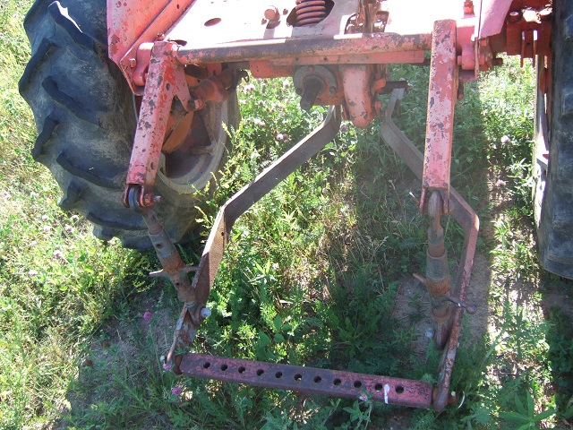

Recently acquired a 52 CA.  It has what I believe to be a 2-point hitch.  Is it possible, "standard", to mount the new style top-link bracket to the Rockshaft to make it a 3-point hitch.  I am hoping to avoid the cost of finding an old drawbar and new 3 point hitch system.

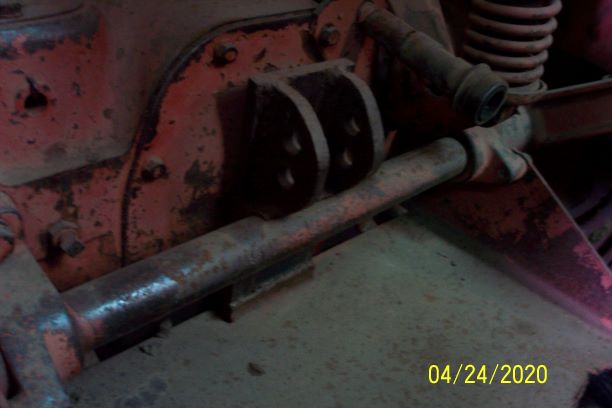

Here is a picture of how my top link is welded on. When I use a 3pt mower on it I just don't use the top link. You can just run a chain from the top link mount down to each lower pin and use it as both a lower stop and sway at the same time. I don't have any pictures of my 3pt installed, but you can see how the factory drawbar would be setup.

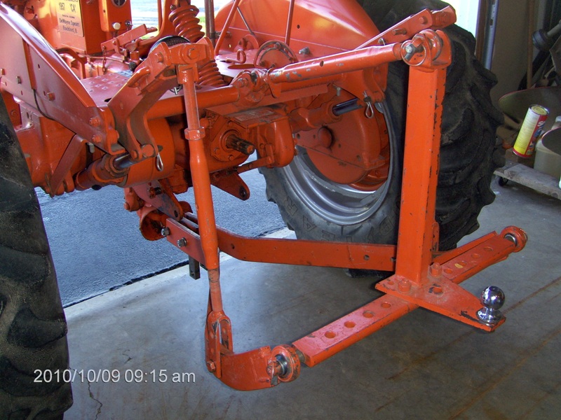

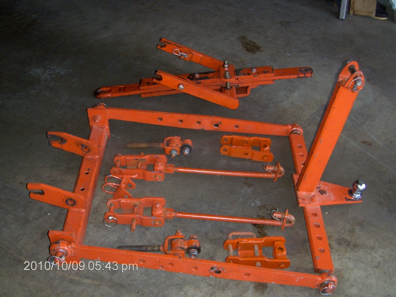

I fabricated my on snap coupler to 3 point adapter to use my rototiller with my CA!
I have an earlier version that was more like a conventional 3 point with pinned lift arms.
I use the snap coupler adapter most of the time!

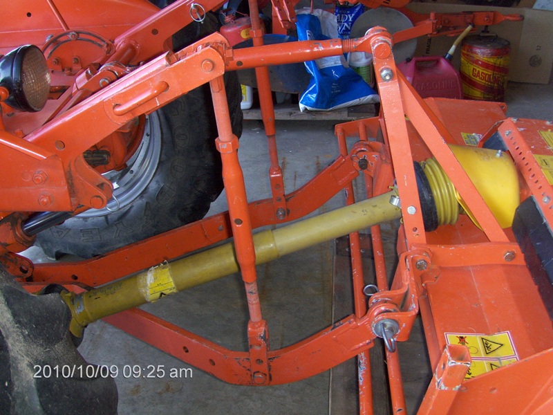

You can just weld on the top link brackets to the rock shaft or buy a bolt on one. I have a 52 CA also and I have the standard 3 point conversion that resembles the AC one, kinda looks like a Y in my opinion. I have a bolt on top link bracket that works great and doesn’t move on me.
As far as lifting the finish mower, I use a Woods 5’ 3 point mower and it lifts it with no problem, doesn’t seem to make front end light at all, however I can’t pick up my 3 point disc without having weight on the front.
