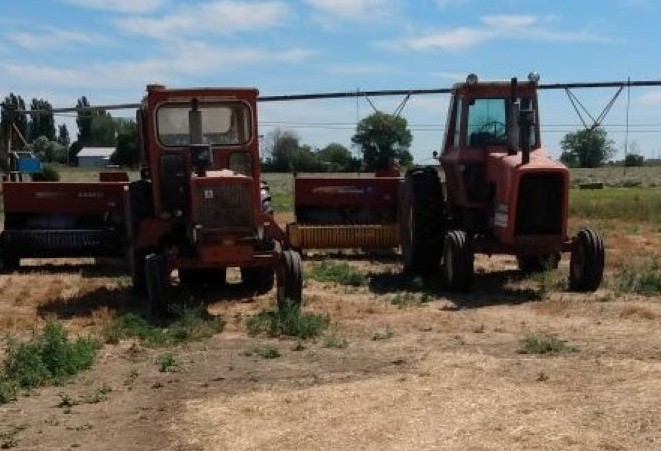

I have a picture of the two muffler options , one on the seriesIII and one on the 7000.
I think you will be happy with the smaller one.
Ted
