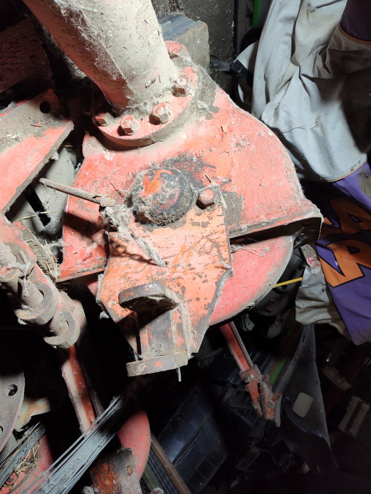

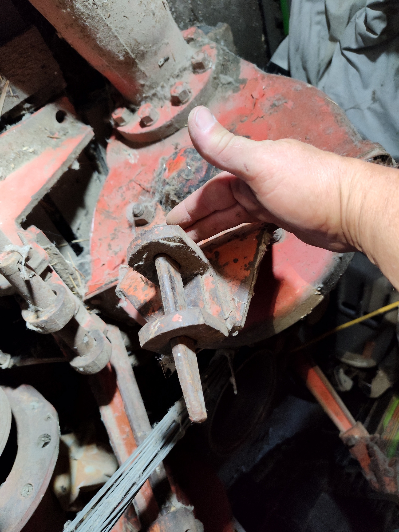

Can someone tell me what the brackets that go a WD 45 are called/part number. They go on the final drive and have a wedge pin to lock the mower attachment in.

Posted By: 55allis
Date Posted: 21 Jul 2026 at 12:27am
Might be a picker or cultivator mounts..
If no one else knows for sure I’ll look at my wd and 33 picker.

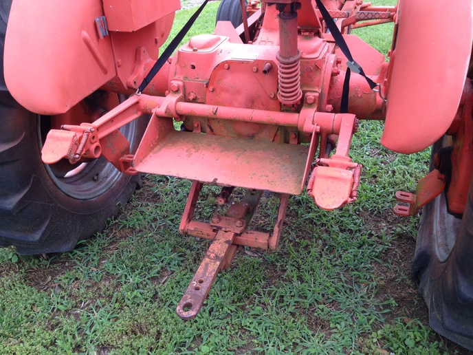

Here is a picture I found on a Tractor. Its for the pull behind sickle bar mower.
Posted By: Mikez
Date Posted: 28 Jul 2026 at 5:48am
Which model mower are you thinking.
Don’t think those are for mower.
Posted By: PaulB
Date Posted: 28 Jul 2026 at 6:45am
They are mounts for the #3 sickle mower
Posted By: automaticdave
Date Posted: 28 Jul 2026 at 8:10am
^^^^^^^^^^^^ Yes and leave the OEM draw bar on the tractor! you will need it! Dave
Posted By: Brian G. NY
Date Posted: 28 Jul 2026 at 4:15pm
Allis called it a Bracket Ass'y for #3 Mower on a WD eff. Feb 1952
Part #803527
Posted By: Mikez
Date Posted: 29 Jul 2026 at 7:44am
Thanks Paul I hadn’t thought of #3 mower
