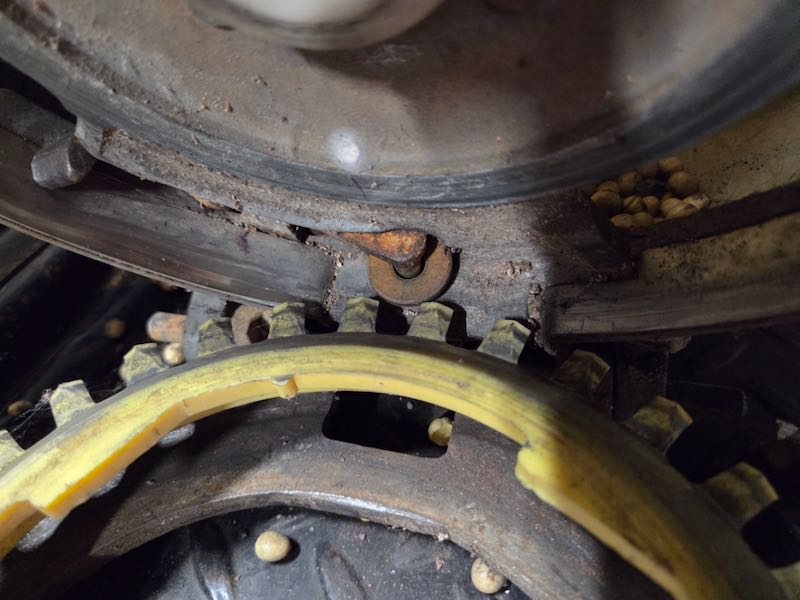

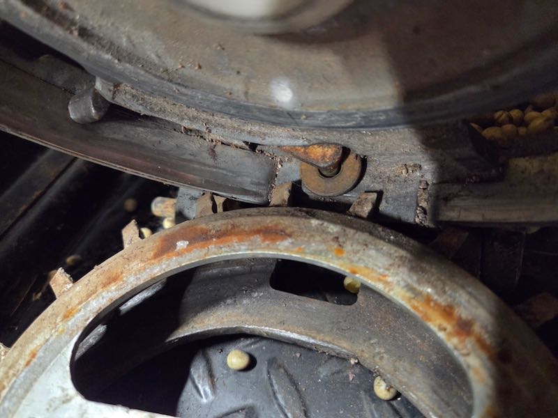

Let me start by saying this is my first time trying to work with AC row units, and plate-type planters in general. I'm fairly used to newer-ish finger pickup and vac planters. Bear with me on this long post. It's going to be the 4th of July and I'm still trying to get soybeans in after 15" of rain over the last month... And I've never planted beans before, all the equipment is new to me, so there's a lot of learning going on. Maybe this thread will end up helping someone else in the future, too.
I have been doing all of my population testing by turning the planter drive wheel one revolution, taking the circumference of the tire, and getting seeds per foot out of what has been dropped during that one revolution. Drops are fairly consistent and I got the sprockets I needed to dial it in for my target.
When I go out to the field, it's dropping about half of what it should be. I don't think I'm missing half the seeds when I dig a 10' strip to count seeds. There are noticeable gaps in the drops (typically 3-5 beans per drop) so I assume it's skipping during say that 10" distance with zero seeds in the ground.
First thing I did was rule out tire slippage. The drive wheels are covering the distance I would expect during one revolution (~66-67"), so not the issue. Chains and sprockets are new. I replaced the pinion gears that drive the big gear under the seed plate. Also replaced the pinion shaft bushings and the bearings for the big gear. I'm fairly confident that is all in better shape than 90% of 74 row units in existence.
I think that leaves me with something in the plate/hopper itself. Two things I can think of:
1. In my "1 revolution in the air drop test" I am not replicating the exact speed of the drive wheel. I'm probably not that much slower, since I'm planting in 2nd gear half throttle, but no way am I exactly matching that. Was there any kind of "speed limit" for the plate provided by AC? I didn't find anything in the 74 row unit manual I have.
2. I am using a B-SOY 3X plate from Lincoln Ag. This is about the smallest cell bean plate I could find. I am doing 20" rows so I needed to really back off on the in-row spacing since I have more rows, to keep my population per acre the same. I noticed the knocker doesn't hardly get into the cell since they are so small. It mostly rides on top of the plate. Is it possible this is my issue? Pictures below showing it, as well as an original AC soybean plate where you can see how the knocker would enter the cells pretty deeply. Maybe the knocker isn't doing much, and when there is a cell with the soybeans fairly well wedged in, they aren't getting knocked out and never drop out of the cell. It's almost like I need a different knocker. I have one that was used with the milo plates I have, but it wouldn't ride well on the Lincoln Ag soybean plate.
Also... I'm all ears if anyone thinks of something else that could be the issue!

i MAY BE WRONG, but your hopper bottoms look like they have the stainless steel wear ring. this means the latest style - I don't know what units they were originally on - only the first have the cast iron cap. Every thing from the 72 units have the pastic cap with setscrew. Sorry for the omission of identification. I will have to go ot the farm and look - seems my plates were white? - I had better go look.
Posted By: wjohn
Date Posted: 11 Jul 2026 at 4:12pm
The white plates are probably the B-SOY 2:  https://lincolnagproducts.com/product/b-soy-2/" rel="nofollow - https://lincolnagproducts.com/product/b-soy-2/
I think I will try those next year if this stand ends up looking to clumpy. I bet they would give better seed spacing/fewer dumped together than the 310992 plates, and those cells would fill/knock out (or whatever my issue was with the 3X plates) better than the smaller cells on the 3X.
Your hunch is correct on the caps... The cast iron caps (340469 cast into them) and 310992 plates I pulled out of an older planter with 50-series (?) row units. Those are the caps that don't have any provision for an adjustment screw.
When I bought these 74 units, they had different cast iron caps (343448 cast into them), which do have an adjustment screw but also had a very thin metal cutoff tongue. This setup appeared to be for milo/grain sorghum or other small seeds (there were filler rings, star knocker wheels, and Lincoln milo plates of one kind or another in there), so I had removed all of that from the row units when I set it up for soybeans.
Sounds like I should buy some of the new plastic caps so I can adjust the cast cutoff tongues for next year, although I didn't have contact issues with the plates this year.
