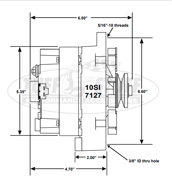

nothing is going to be a plug and play FIT... Your going to have to modify the mounting braket to get the pulley / belt to align and a tightening bracket... The most common  "1 wire" is the old DELCO 10SI that has been modified internal to work on 1 wire... here are a couple versions on AMAZON..
Posted By: steve(ill)
Date Posted: 26 Jun 2026 at 8:40pm
here are some dimensions if you want to see how it will fit...
