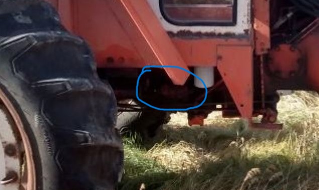

I looked through my pictures to see if I could get a picture of the valve. I found one. It isn't clear, but it does show valve location.
If it has the hydraulic valve try spraying WD40 or similar into the console and waiting a day to see if the detent loosens up. I usually just fog some in around the remote levers. I learned recently(from this forum) that all 190XTs with a PTO have the disconnect lever on the left side, but on hydraulic control models nothing was hooked to it. It sounds like yours may have been modified since it left the factory.

Posted By: DrAllis
Date Posted: 10 Jun 2026 at 8:18am
That blue circle is the Power Director valve. The hydraulic PTO clutch valve (an option) is 16 inches to the rear of that blue circle, if it has one.

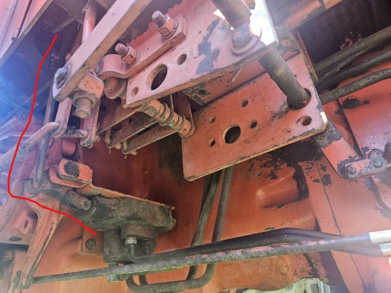

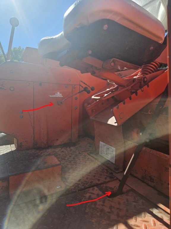

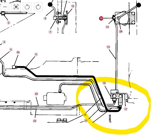

Posted By: calico190xt68
Date Posted: 11 Jun 2026 at 9:03am
I took pictures of it and compared to AGCO Parts diagram.  I believe it is still there and lines going to it but not totally sure what I am looking at just yet.  I need to remove the cover.
Picture showing both levers.
I believe this is the valve showing linkage and lines connected.
Here is the parts diagram for the PTO Valve.  I see 3 lines connected as in the diagram.
Posted By: DrAllis
Date Posted: 11 Jun 2026 at 9:30am
It appears the PTO hyd valve was added on after the tractor was built. There's no paint on it or the lines going to it.
