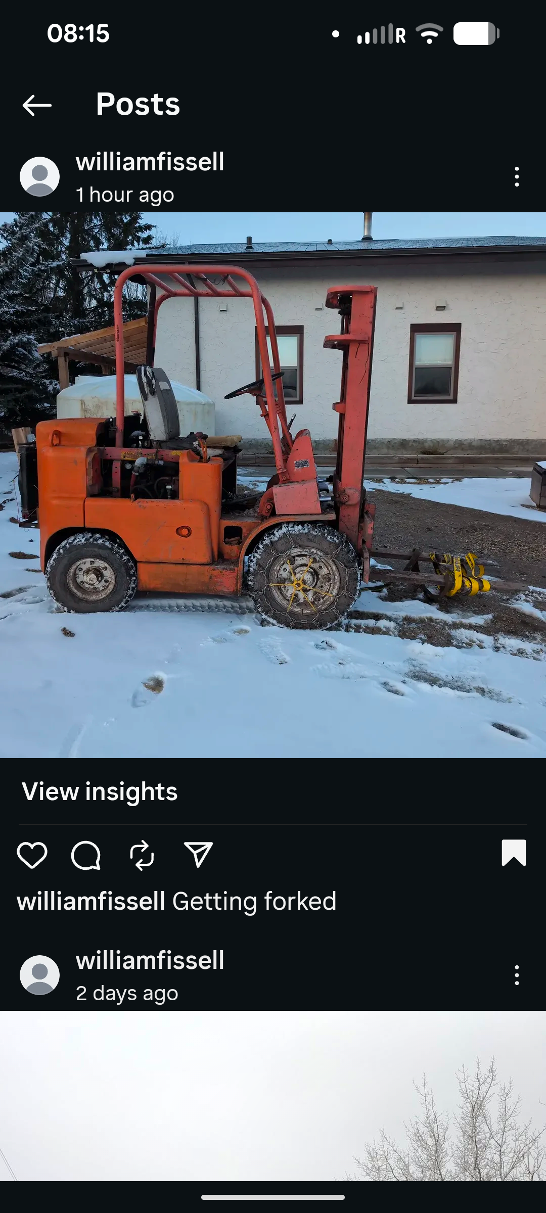

So, I bought an Allis forklift. 6-cyl gas motor, runs, drives, but a lil janky. Looks like pics I have seen of fp-40 but not sure. Im attaching some pics.

If it has a 6 cylinder engine it's likely a 60 series rather than 40. Service manuals are hard to come by, a while back a good manual was advertised on Kijiji, it seemed to be a slow sale, I don't see it there anymore. Of course on this forum you can ask specific questions as well and you may get some answers you need. Best wishes on your new toy/tool Smile

It sounds like some aftermarket tinkering has taken place, oh well, if it works then very well. If it is a 60 series I would expect it to be about a 6000 lbs. capacity fork lift. There is usually a plate riveted on somewhere that gives measurements and capacities, of course it could be missing with the passage of time.

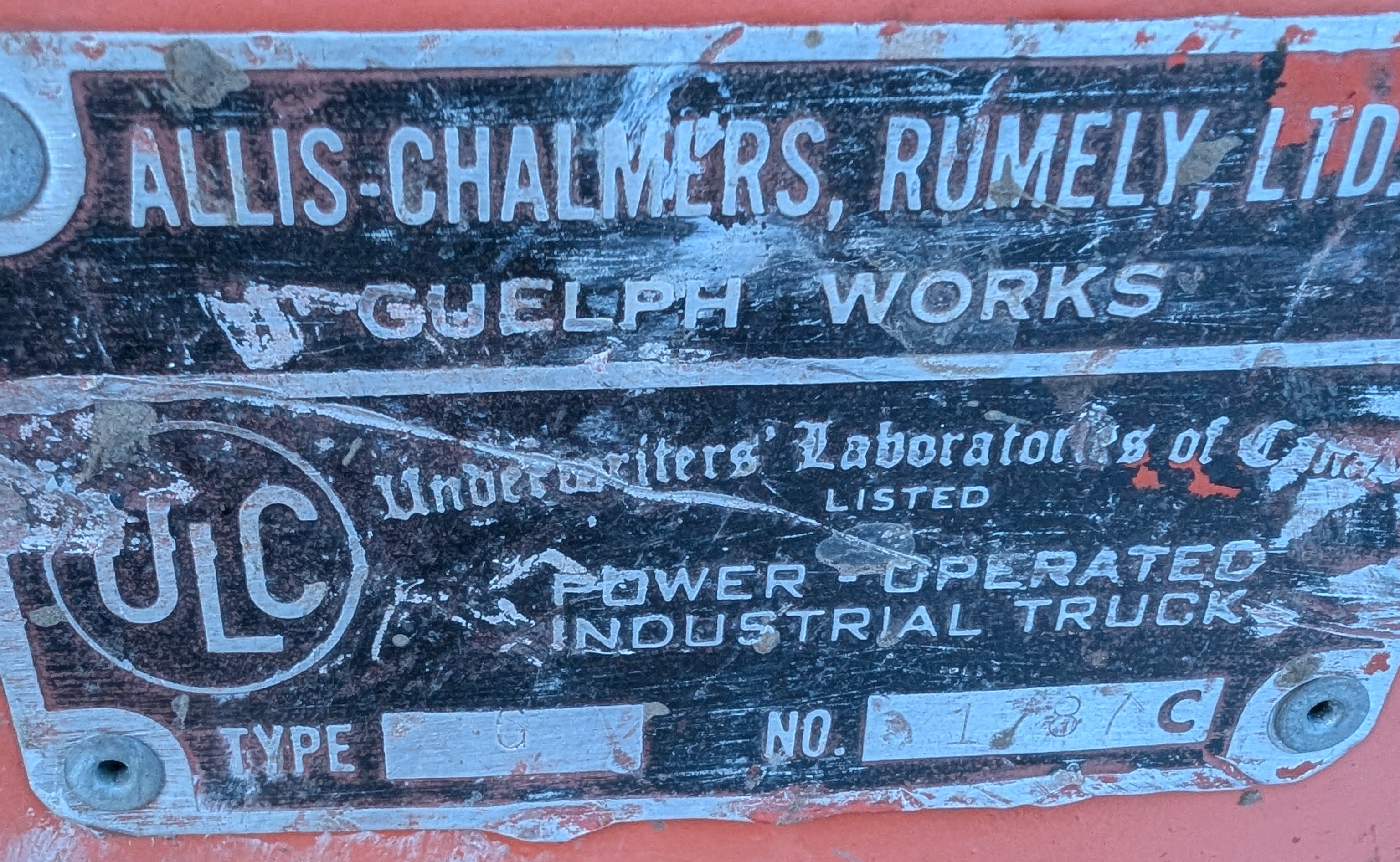

i found the playe- fp40 indeed. I hypothesize that the original motor died and they could find the 6 but not the 4, so they put a six in it. doesnt much matter to me.

My guess bigger engine needed more cooling, bigger radiator.  Fork lifts being notoriously tight on space, they just added a second where ever they could mount it.

Swapping in a six from a four (I'm betting they're identical Continental flatheads of just two more cyls) meant the engine cooling radiator needed to be moved to the far side of the counterweight (for clearance)...  and the OTHER heat exchanger is an oil cooler...
But if it's two rads, they'd be plumbed in series.
Sometimes guys have challenges with flatheads and cooling... yeah, they're thermally challenging, because there's a host of thermal design challenges just from the GEOMETRIC standpoint... and a host of other challenges, that when overheating problems start to appear, guys are at a loss, so they do anything they can... crazy things... to try and solve problems.
