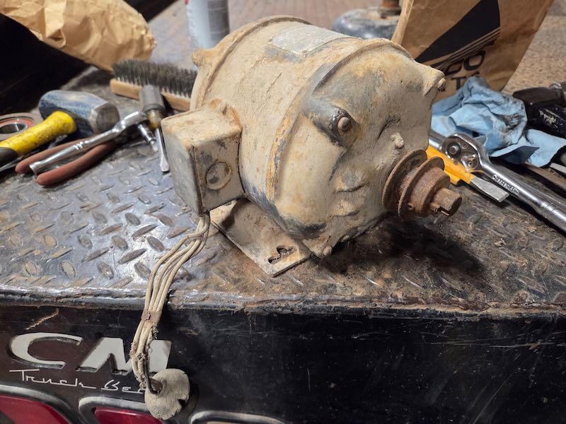

I am hoping to fix up this old Century 1/3 HP motor that came on my Clipper 2B seed cleaner instead of buying a new motor. I'd like to be able to use it to clean some wheat soon and plan on using it for other crops as I start growing more. The motor seems old enough that if not original to the cleaner, it can't be too much newer.
The motor and seed cleaner shafts were locked up when I bought it over a year ago. I freed up the cleaner by hand yesterday, and put a chain wrench on the motor pulley. It broke free with very little effort. I pulled the cast iron pulley off last night and it fought the whole way, and got slightly bent, so if I can't straighten it I may be replacing it. It obviously needs a new cord.
What's the best way to confirm the motor is still good, and put it back into working condition? I was planning on cleaning all the dust/mud dauber nests out and changing bushings/bearings. I'll do what I can with a multimeter to check the windings. There doesn't seem to be much play in the bushings/bearings; however, there is some end play in the shaft. Anything else I need to know about? I do not work on electric motors much.

if the motor spins, the best way to test is just to plug it in... that will confirm real quick if you need to do more work.... iif it starts, you can listen and see if it needs greased and cleaned or new bearing... i dont see a start or run capacitor..  might be a small one inside the rear cover...if not, they do it all in the windings.... cant tell if the plug on the end is ready for 120v power or of all the wires are just hanging... should be a wire diagram inside the small elect box that shows which wires are connected together... it might be a reversible motor due to the multiple wires.

Thanks Steve. It's a split phase motor so that should explain the lack of capacitors. I presume the light load of a seed cleaner is no problem for startup.
You can't see in my picture but the bottom of the motor casing is open and it's filled with stuff, so I do want to clean that out first before I try to run it. From what I can tell this model just had top drip/debris protection.
I do agree it seems like there are an awful lot of wires coming out of the motor for what is labeled as a 110V. What is left of the plug appears to have been a 2-prong connection. I haven't gotten into the wiring box yet.

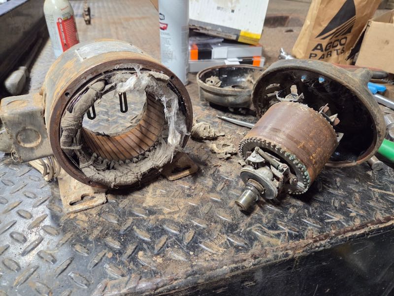

Probably has a start winding controlled by a centrifugal switch.
As long as that switch hasn't been broken, just clean it up good, blow it clean with compressed air, oil it, reassemble and put power to it!

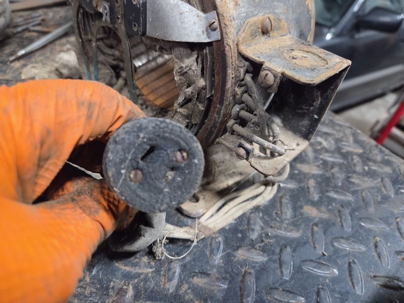

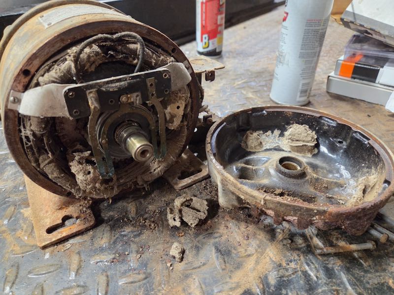

Finally had some time to tear it apart. I dinged up the shaft a little pulling the bushing off, but I can clean that up with a file and it should be okay. The bushings are plenty tight so things don't seem to be worn out. The inside looked like what I expected - mud dauber nests and cobwebs. I will get around to cleaning it up and inspecting it next.
The plug interesting - either the prongs disintegrated, or seems more likely it's female. I'm wondering if it's a pair of wires for each winding, basically?

sure looks like a plug from 1920 with NO GROUND WIRE !!!   Odd that it is female..
the centrifigual switch that DAVE mentioned can be seen in the first two photos... Make sure it "throws out" by pushing with your finger.... clean the POINTS or CONTACTS so that they do contact..
