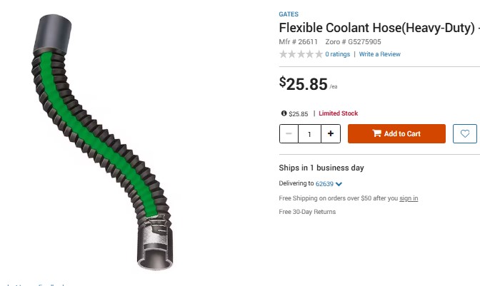

Like PaulB said, it's pretty much the same as a D17 engine. Anything that would be unique to a power unit (I don't know for sure, but maybe camshaft, fuel pump, radiator, hoses etc.) probably isn't available since all of the aftermarket parts volume is in the D17 engine/tractor. You can likely find what you need to keep it working though. You might have to find something close as far as radiator hoses go and splice two different cut down hoses together, for example.
Posted By: steve(ill)
Date Posted: 20 Mar 2025 at 9:37am
something like this is a good option... Stop by NAPA or other Auto Store and ask.
