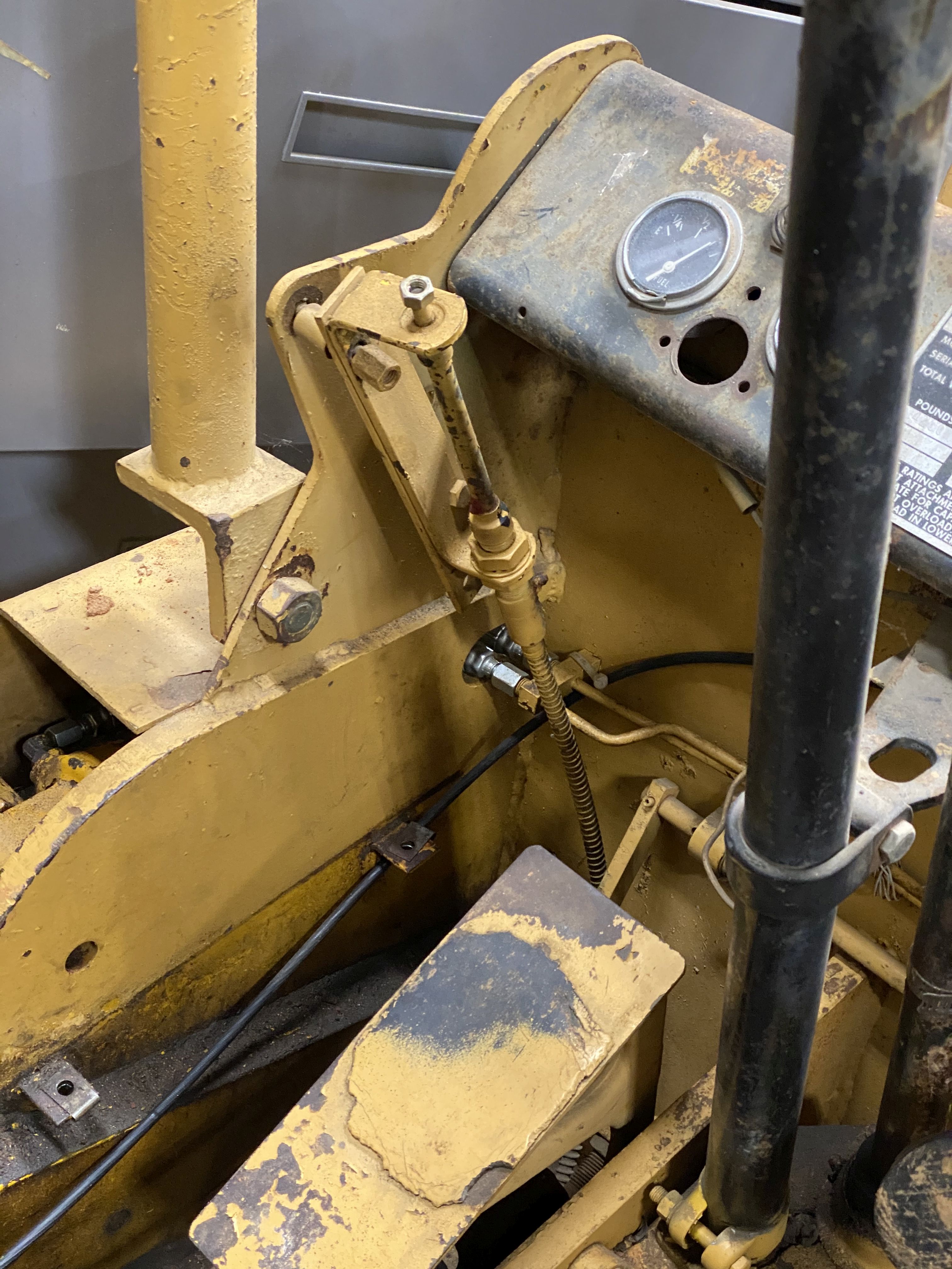

OK, hoping to reopen this thread..
I'd like to know how to put the '2 speed' control BACK onto the dash or wherever it's supposed to be.
Mine has a 'custom' lever on the floorboard, leftside, behind the heel of my boot.
Up seems to be low, down = high.
A picture would be nice....Google hasn't been to helpful, sigh....

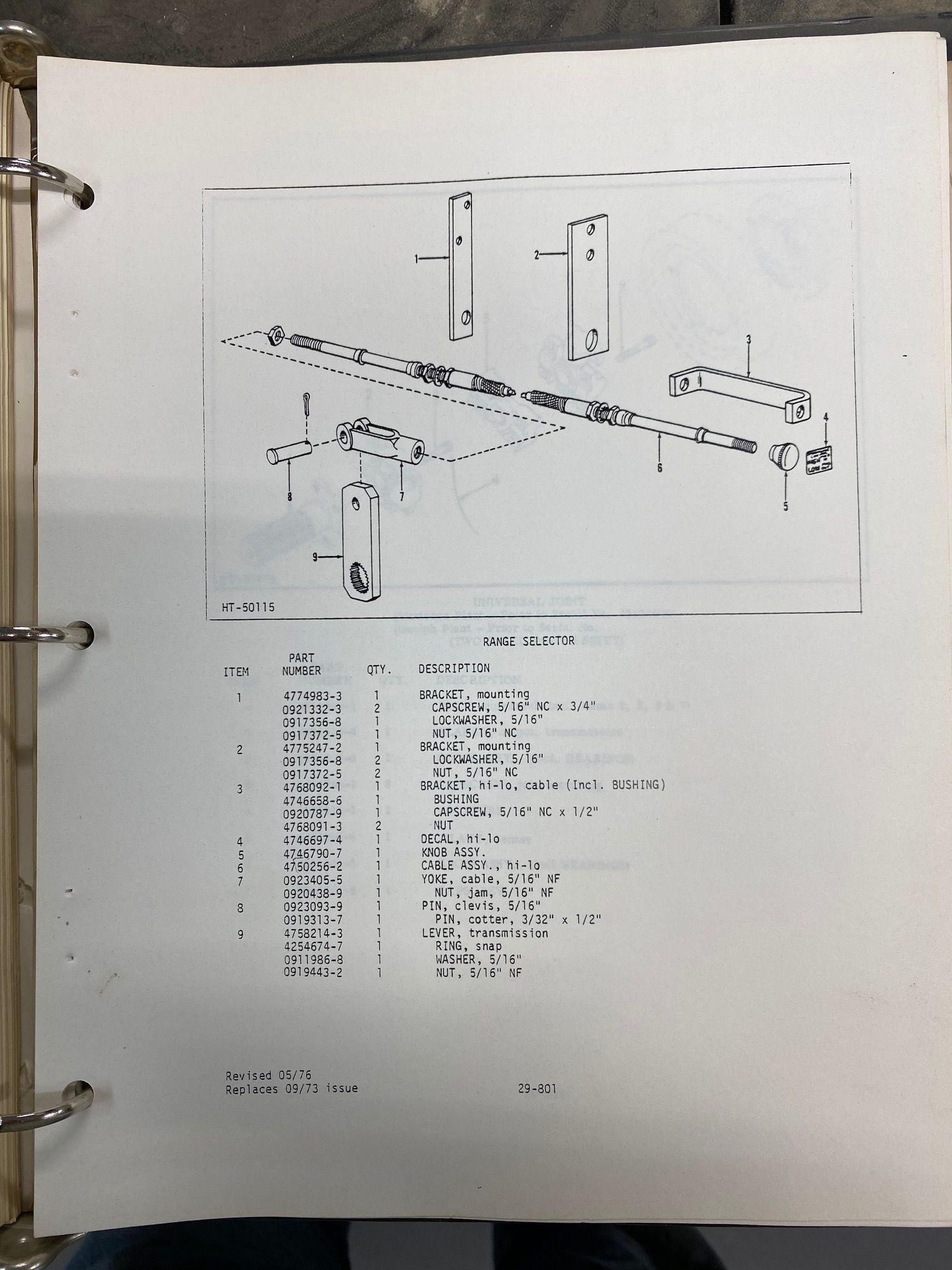

Posted By: sinklar
Date Posted: 05 Oct 2020 at 10:21am
Here is a picture from my forklift, it show the cable by the steering wheel. Also I have a picture from the parts manual I have included. If you by chance find a suitable cable I would be interested because mine is froze up.
Posted By: sinklar
Date Posted: 05 Oct 2020 at 10:27am
The other picture
Posted By: NomoreJohnDeere
Date Posted: 05 Oct 2020 at 11:29am
you can have a cable made

Posted By: jaybmiller
Date Posted: 06 Oct 2020 at 2:04pm
hmmm... your hi-lo cable is where my parking brake is attached ! Makes sense about a cable instead of 'bars of steel'....
as a 'bodge', I've disconnected the PO bodge, stuck it in LO and real happy I can get up my driveway now  without taking a friggin run from acorr the road !!!
