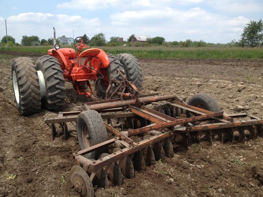

The how much disc can I pull with XYZ tractor, always make me shack my head. There are so many variations of disc's. Maybe there is someone on here that could list 75% of the models AC made. Then move out the other major brands, then all the short line companies.
I have a very similar disc to the one pictured below ( 8 blade 12 inch spacing)  (hopefully my copy and paste is viewable) that I am not sure if if any AC 2 wheel drive until the 7000 series would really handle. It took 70 hp crawler to really handle it ( HD 9 AC ).  I also have a very lite finish disc 16 foot a 40 hp 2 wheel drive handle fine.
Just saying without weight per foot and blade size not much is more than a guess. As there are discs and then there DISCS.

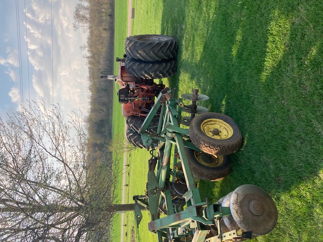

I have duals on my D17 and pull a 12’ John Deere disk. Makes for lighter ground pressure hence the disk cuts in better and doesn’t leave wheel tracks, also makes for a lot smoother of a ride on rough ground.
