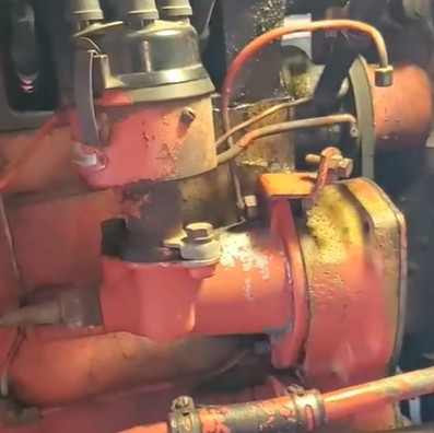

Hey all. I am a timber framer, and I often cut beams larger than I can lift anymore. I bought an old AC rough terrain forklift, and it doesn't run, but I am getting close. I bought the shop manual, it's in the mail, but this thing has been tough to find info on. Based on the info I have so far, it is the same as a D15 series II. (?) I think.
I will post a pic once I figure out how. it has been fun, so far. I figured out you have to push the leftmost foot petal, and that lets the engine turn and starter crank. I don't even know what it does yet....
Anyways, the distributor is old and has rusted so the advance won't work. Any idea what part number I need? Thanks for any help...

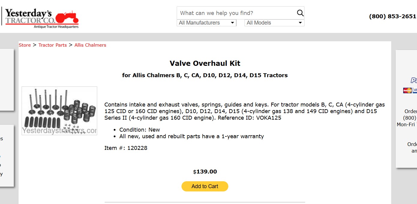

I got the new distributor, and it still sputters, but wont run. it sparks fine. I checked the compression and i had zero psi in 3 and only 90 in 4. 1 and 2 were 140. Not good enough to run!
I took the head of in 15 minutes. You gotta love tractors. the valves in 3 werent seating properly, and the ex valve in 4 was chipped away. So that explains that.
gonna order some parts, and have the valve seats redone. I finally got the book on my tractor/forklift, and the book says I have a Power Crater 160 motor, but I cant find much info on them, anyone know?
apparently there was also a perkins 3 cyl that was called that as well.
Posted By: steve(ill)
Date Posted: 01 Dec 2024 at 7:34pm
That engine series started as a 138 cubic inch in the D10- 12 ... Later that was bugger bored to 149 and many in the D14 and D15 farm tractors.... Last update was to 160 inch for the D15 series 2..... GOOD MOTOR !!
I think valves / springs / "parts" for the D14 and D15 149 motor should all fit, except the BIGGER PISTONS...
Date Posted: 01 Dec 2024 at 7:45pm
couple of sites list a different part number for the later D15 II engines ( i think they mean the 175 cid diesel)-- ( valve kit).. some site list them as all the same..( gas??). VERIFY with vendor prior to purchase..
Date Posted: 01 Dec 2024 at 7:53pm
Power Crater was the later design of pistons used in several tractors... The design was a DISH or CRATER in the center of the piston that  moved the gas / air mixture to a concentrated point in the center under the spark plug... Should be more efficient and more HP.
