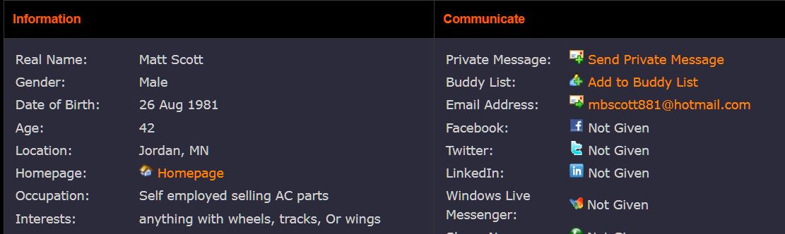

Posted By: steve(ill)
Date Posted: 13 Jul 2024 at 9:15am
you might send Matt an e-mail and see if he has anything.. or maybe knows someone who does... Just a State over from you..
