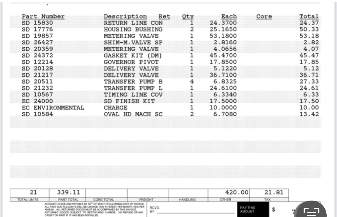

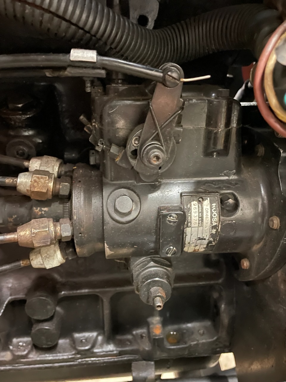

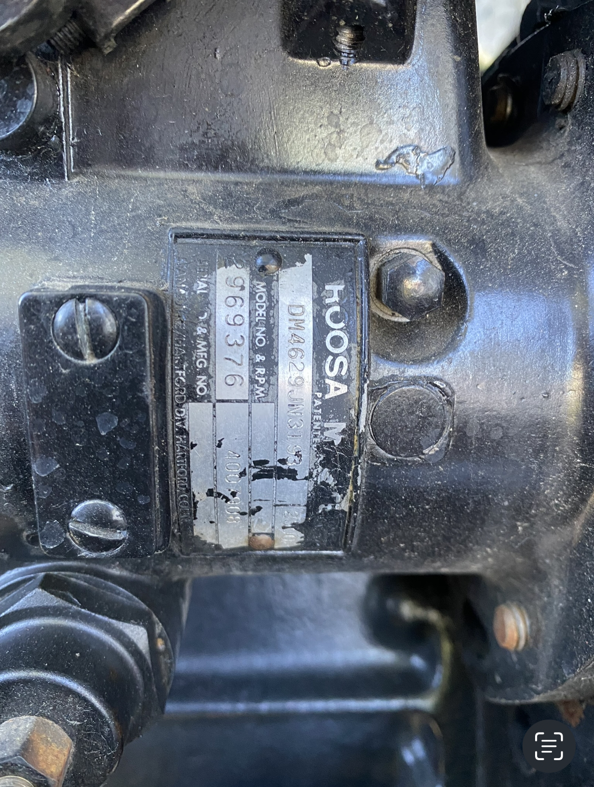

It doesn’t look much different honestly. Supposedly was done 10 hours ago. Here is receipt he gave me for pump along with picture of pump. Can I check/clean screen in pump without hurting anything?
Still need to check pump shutoff when I get a chance tonight.
I am thinking more and more might be pump since everything else was gone through that or turbo maybe.

Those prices are what I have from 2016. It could be all gummed up inside. I've seen pumps get gummed up with crummy modern diesel in a year or less. You already said it had algae, so I'd bet money it's nasty inside the pump and not working properly.

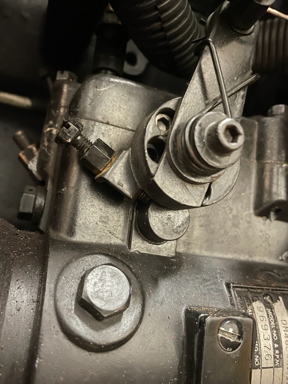

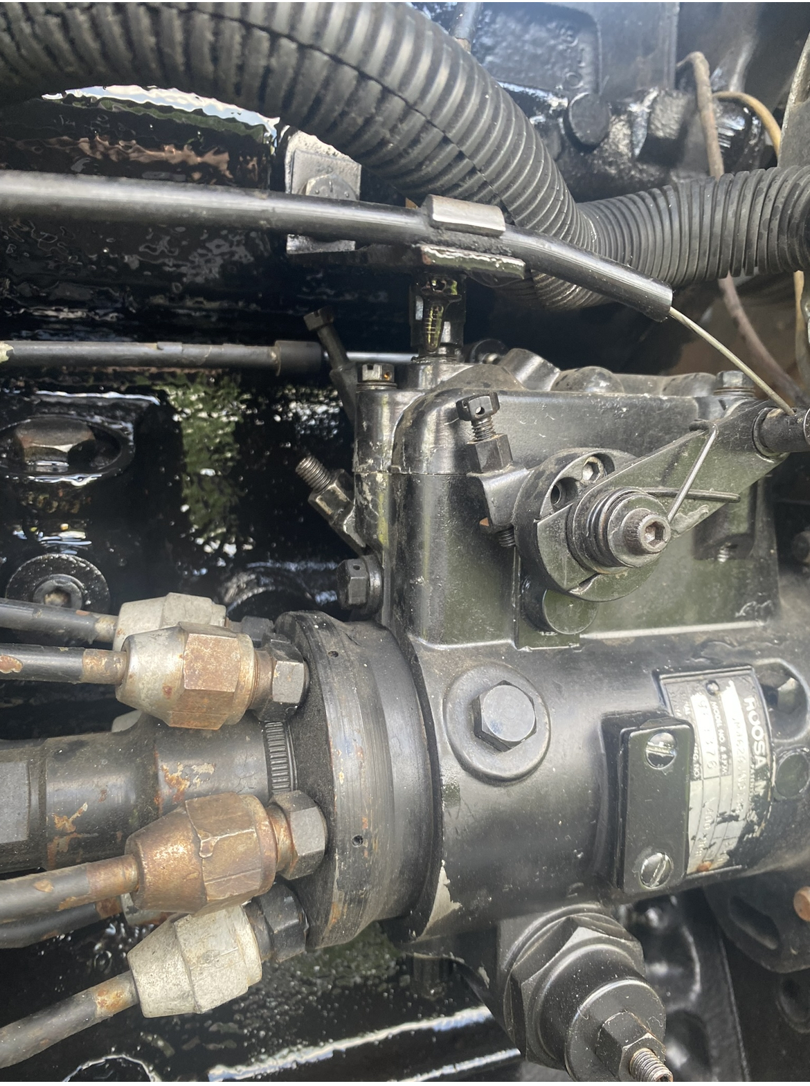

Made out in the shop for a little bit tonight. Unhooked cable and pinned back shut off. Did not make a difference when getting out and driving down the road. See picture attached. Can I screw out the stop screw all the way without hurting the pump so that fuel shut off is “more” open and then try again? I imagine it shouldn’t hurt anything, but wanted to ask before just doing it.
Posted By: DrAllis
Date Posted: 29 Sep 2023 at 11:09pm
You may, but it should NOT change anything. Loosen the screw and do not change the lock nut. Just back out the screw 1/4" and try it. Return back to where it was when it doesn't do any good.
