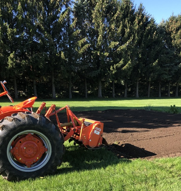

Posted By: DSpears N IL
Date Posted: 20 Sep 2023 at 8:02pm
I make at least 2 tilling passes in opposite directions.
The 1st pass is at 1/2 throttle, and the final pass in the opposite direction at full throttle!
It is much easier on the equipment and hopefully do not find anything left buried in the ground!
The CA can handle the 4 ft tiller fine!
Tire tracks are to the outside and not a problem!
Posted By: Tracy Martin TN
Date Posted: 20 Sep 2023 at 10:45pm
That looks great!Tracy
