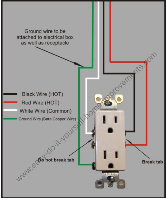

In the US when you use RED- BLACK- WHITE.. you "normally" are connecting to a 240 v plug... like the stove or arc welder, etc..... "MOST" of the power usage is from BLACK to RED ( 240v) .. you may have a timer / light bulb / clock that is connected to the BLACK- WHITE and runs at 120v.......
That is the theory in your breaker box also Lars.... "MOST" of the power ( amps) are going between the RED - BLACK ( or your two HOT WIRES INTO THE BOX) that is 240v.... that runs the Air cond, stove, hot water heater, furnace, etc.... The WHITE wire is ( or neutral from the power pole)  for the 120v circuits and normally only used for 50 amps ( in a 100 amp box), or 100 amps ( in a 200 amp box)..... it is basically not used ( much) on the 240v circuits.
Posted By: steve(ill)
Date Posted: 18 Jul 2023 at 11:08pm
red goes to one receptacle, blk to the other. They are fed from a 'double' breaker. allows you to have a toaster  AND a kettle connected to the 'duplex receptacle'
well something dont add up there... If the RED has 20 amps and the BLACK has 20 amps... then the WHITE would have 40 amps.. If its the same size wire it is OVERLOADED....... assuming this is  120v circuits.

I looked up "SPLIT PLUG" as jay mentioned in his post. Personally i have not seen a 12-3 wire used to feed two  ( split) plug.....You are really running a 240 v wire to TWO 120v sockets.. If you think about it, the power flow FROM the red to white, while it is flowing TO the black from the white... then the SIN WAVE CHANGES and the flow is TO the red (from white) and FROM the black (to the white).. In this way the Neutral (white) will not see excessive current flow... so that should work as long as the two BREAKERS are side by side on different INPUT LEGS of the breaker box.

no, you're running two , 120 feeds from a ganged (2 pole) breaker. At no time does either receptacle get 240 . red and wht to 1/2, blk/wht to the other 1/2.
Date Posted: 19 Jul 2023 at 8:51am
there is 240 volt "in the plug box" from the black to the red wire... but your right, they are SEPARATE inside the gang box to two INDIVIDUAL PLUGS , so you just have 120v to red to white and 120v black to white..... shows that in the movie.... no way to plug into the red and black with ONE PLUG... but a VOLT METER will show 240v inside that box.
The BREAKERS can not be a SPLIT using two on the SAME LEG inside the breaker box.. You must have the BLACK and RED on DIFFERENT legs inside the breaker box.
So if you use both halves of the outlet at the same time, which seems to be the point, the current from both would be carried by the white. How’s that allowed?
Date Posted: 19 Jul 2023 at 12:42pm
think of a sin wave... RED is +120 v.... Black is -120 v .... white is "neutral" in the center.. ZERO on the graph.......you have to picture it as a 240 v SYSTEM.. even tho you are going to divide it into 2 - 120v circuits.
Three phase power does the same thing... Since they are OUT OF PHASE, when you add them up, the neutral ( white) see very little current flow.
The catch is you have to be on BOTH LEGS input to the breaker box, so you have a SIN WAVE. (240 v).. You cant have the Black and Red on two breakers on the SAME LEG INPUT..(120v each, 0 v difference ) if you did, the white wire would pull DOUBLE what the Red or Black is pulling.

found this...
https://www.electrical-online.com/kitchen-split-receptacle-circuits/" rel="nofollow - https://www.electrical-online.com/kitchen-split-receptacle-circuits/
shows and tells how they're done.
 it saves a lot of wire,quicker to install ,so cheaper.
here in Canada the new code rules require 20Amp 'T' style receptacles in the kitchen,with/without GFCI is close/not so close to the sink.
typical of the guv, turn something simple, into a complicated MESS (lookup arcfault breakers....)

If the supply is moved to breakers of the same row in the breaker box, does that improve the issue?
Posted By: Lars(wi)
Date Posted: 22 Jul 2023 at 7:36am
Otherwise, to avoid any confusion, run a XX-4 wire and break the tab on both sides, black and red on the ‘hot’ side, white and wrap the exposed blue with white tape and run as a neutral. Problem solved?
Date Posted: 22 Jul 2023 at 8:01am
Lars, really not the best idea to use 12-4 and use the blue wire as a ground, but that WOULD WORK..... NO  12-3 ( red- black- white - without ground ) .... You should be using a ROMEX 12-3 WITH GROUND........ The BREAKER needs to be  double breaker as we use on 240 volt systems.. That gives you TWO POLES of 120v..... Not the smaller "SPLIT" breaker that has two small breakers on one leg... that would be a NO- NO. ( of course you have to have the right BRAND name for your box)
Posted By: Lars(wi)
Date Posted: 22 Jul 2023 at 8:22am
Didn’t say cut the blue. Break the tab between the ‘hots’ and break the tab between the neutral. Use the red and white wire for one circuit. Use the black(hot) and use the blue as a neutral(wrapped with white tape). A single pole 20amp breaker for each hot. Workable?
Date Posted: 22 Jul 2023 at 8:37am
Yes, that is POSSIBLE... but the two INDIVIDUAL BREAKERS have to be side by side to get TWO DIFFERENT POLES.... By  "CODE" the two breakers SHOULD be tied together so when one trips, the other trips..... That way you can not  shut off one breaker, and still have a HOT plug box............ but YES.. it will work... and YES.. you can use the BLUE wire as a ground if you have 12-4 wire available instead of 12-3 with ground..
(i was adding photos and updating my text when you posted above... I did initially think you said CUT the blue wire, not TAPE the blue wire white )
