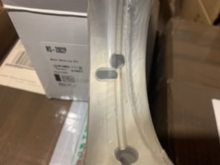

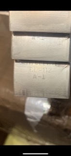

I believe I have some 426 mains that are 112 series in Clevite and Standard size

But which 426 bearings// to a D21/210/220 or 7000 series with piston cooling?? or 8000 series with connecting rod piston cooling ??

I believe they have the oil passage.

I have pictures can’t get to load.
Posted By: cms
Date Posted: 01 Jun 2023 at 6:58pm
Posted By: cms
Date Posted: 01 Jun 2023 at 7:00pm
