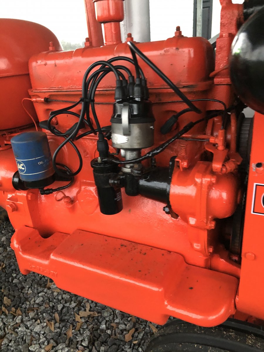

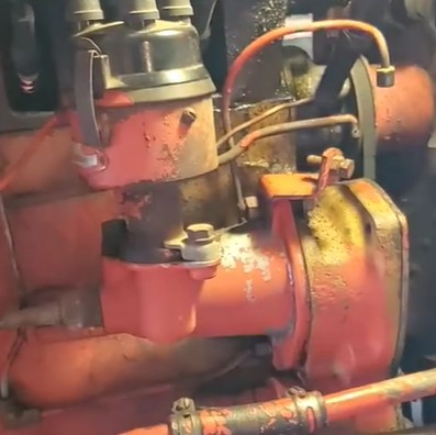

when you remove the MAG, you notice that it is not a gear drive.. It has TWO TANGS that drive the shaft... That is what you are looking for.. Something off a B, C, CA will all work... looks like this on e-bay.

Steve above has listed ONE way to do it, you also can do it with another setup. Steve has listed the magneto conversion style, there also a factory setup with an extended drive gear setup that was used on CA's and a similar setup on d14/d15

Date Posted: 26 May 2023 at 9:09am
Posted By: steve(ill)
Date Posted: 26 May 2023 at 1:36pm
What Mfam8 said... with photos...
