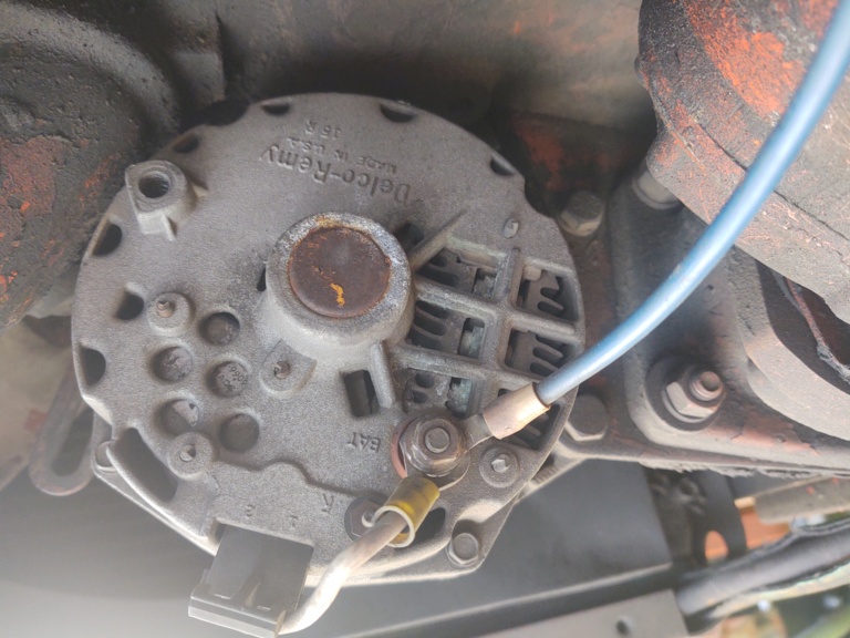

I posted a picture on here awhile back showing my old headlights and Steve in NJ pointed out that I obviously had low voltage situation so I finally got around to looking at it.  I put a voltmeter on it and I only show 1V coming out after I removed the battery lead.  So, I think I have a bad alternator, but I am new to alternators.
When I look at the shop manual wiring diagram, the alternator looks completely different than what I have.  Mine appears to be a replaced 1 wire alternator?  The model that I found that matches the look of this alternator seems to be called a Delco 10SI?  Is this original?  I think there used different styles over the years but not sure.  Mine is 1968 serial 14419 if that matters.  Should I get the most reliable model, if it is not.  Not sure if this applies to this model but I read where 1 wire alternators need to be running 2000 rpm to charge?  They also have to have an exciter wire?
Any guidance is appreciated.
All States Ag sells 2 different alternators and both look the same and do not look like the one I have.  Prices are more expensive than what I have too.  If I get an original, do I have to rewire things?
Here is the picture of what I have, in case someone can shed some light.  What is the purpose of the jumper wire?

A alternator will not charge without battery lead hooked up. Check voltage at big post on alt. With tractor shut off. Crank tractor with some RPMs and check same place. Should have around two more volts unless battery is full charge.                MACK
Posted By: steve(ill)
Date Posted: 17 May 2023 at 10:09pm
That white wire going to the double spade connector is an ODD BALL... If it was a 3 wire and using the two spades, you need a signal wire to #1 and a jumper from BAT to #2 .... If it is a 1 wire alternator, you should not need the jumper to the spades... So yes, something is wrong.......... you can go either way, 1 wire or 3 wire .. your choice.  and YES that is a DELCO 10 SI.

On the back side of the black plastic connector there appears to be a connector but no wire attached.  I think it was there at one time.  Is it possible that a second wire was attached?  I can't see where a 3rd wire was ever attached.  Can an alternator be useful as a 2 wire?  I am going to look around and see if I can find a wire under the dash not attached to anything.  By any chance would that missing wire go to the the dash voltmeter?  It so happens I have a non Allis voltmeter gauge  in the dash.  It seems to be working too because once I turn on the key I see the voltmeter gauge go to 12 volts.
I don't think I need 3 wire since it is merely lights only on the 190XT.
I also tested the output with a voltmeter with the blue wire attached and it definitely is not putting out 13-14 volts.
The blue wire goes to the voltage regulator and not directly to the battery. That blue wire is always live.

Blue wire goes to the amp meter ( your Regulator is internal ) in your photo i thought the WHITE wire was attached to the PLUG.. But that does not make any sense.. If the PLUG is just covering the two spade terminals, then you have a standard ONE WIRE alternator..  A 3 wire alternator would be wired DIFFERENT inside and the two terminals would be  #2 HOT and #1 SIGNAL from the dash light.. Someone could have removed the  NOT USED wire... In the beginning ( 1970s) it was not a 1 wire system.
a three wire would look like this--- resistor or dash light in the #1 spade..

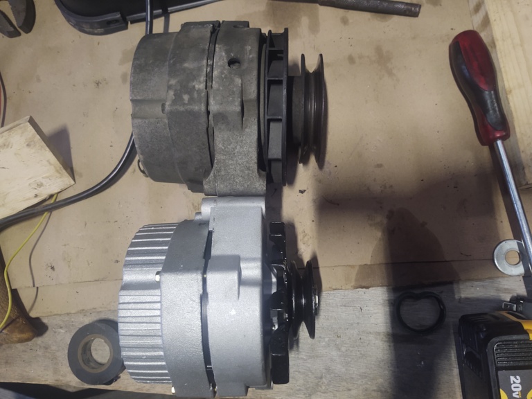

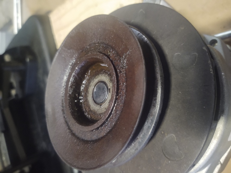

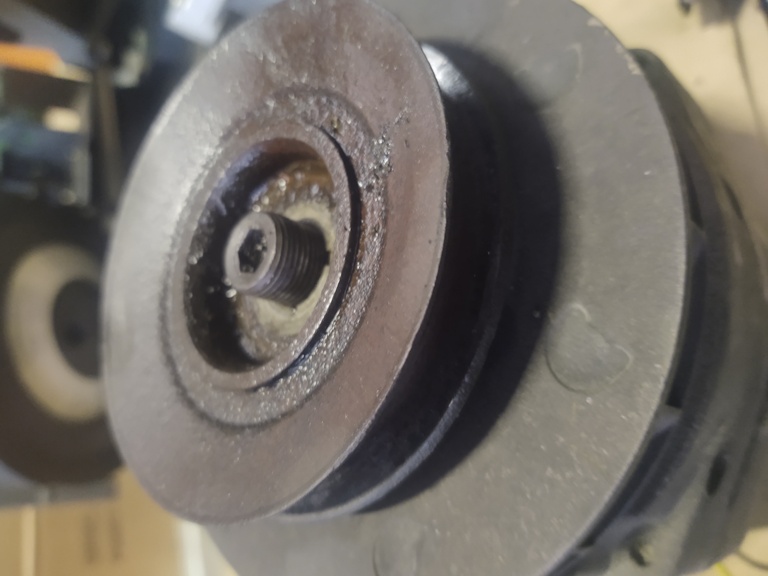

Like always, things aren't straight forward for me as they should be.  I bought the 10Si and it is not exactly like my alternator.  I pulled off the pulley so that the same belt could be used and there aren't enough threads on it to put the nut on.  Here is the new alternator with old pulley.
Here is what it looks like on old alternator with old pulley.
If I tried to use the new alternator with the new pulley, the belt would be out of alignment since the shaft is shorter than the other one.
This picture shows the difference.  it is about 1/2 inch shorter.
 So, I guess I am going to have to get the old one rebuilt?  I don't want to keep buying other alternators without knowing the shaft length, only to have the same problem.

If he wanted to modify the mounting bolts with a few shims, the 10SI that he bought would work fine.

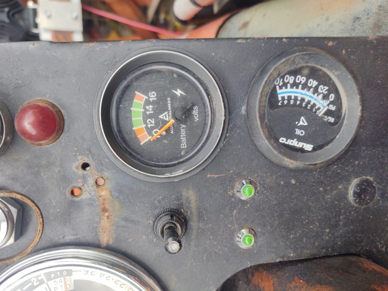

Here is the voltage gauge that I have and it works although the alternator wire is not properly attached.   Is this gauge a 190Xt gauge or from something else?  Seems I didn't see this in the parts book.  It says Allis Chalmers on it.   That non-standard switch and led lights in the middle is a turn signal switch and signal indicators that I installed in case you are wondering.
 The oil gauge is connected to nothing so I think it was going to be a future improvement that never got done.

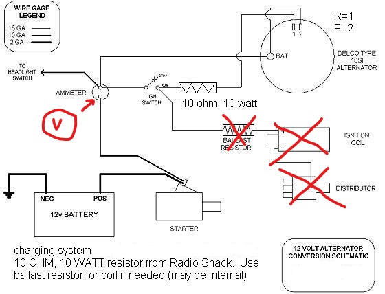

Date Posted: 22 May 2023 at 10:51am
Since I have a diesel, I don't have the ignition coil, distributor or ballast resistor to worry about.  It seems that I don't need the external voltage regulator installed below my dash.  Can I remove it?  I also don't have an ammeter but rather a voltmeter in my dash and I assume I can use it rather than an Ammeter?  Here is a 10W/10Ohm resistor that I am going to use.
I am not sure about sending the wire to the headlight switch from the Voltmeter?  Is that what I want to do?  I haven't tracked my ignition key wires yet but do I need to do anything different there?
So, here is what I think I need to do to wire for a 3 wire alternator setup once I get my alternator fixed.  Thanks for the help.
Date Posted: 22 May 2023 at 4:11pm
YEP... and a VOLT METER jus measures voltage OUT of the switch to GROUND... not INLINE like an amp meter ............. maybe something like this....and you can put your head light switch wire on one of the ignition switch wires.. if you put it on the LEFT side, you can have the head lights on with the ignition switch off... if you put it on the RIGHT side, then the ignitions switch kills the power to the head lights switch.
Posted By: calico190xt68
Date Posted: 22 May 2023 at 8:28pm
First, I really appreciate these diagrams you make. It makes it clear. I now know ammeter measures flow (amps) of electricity whereas voltmeter measures the storage (??) of electricity (volts). Be great to have both gauges but not sure I have dash space. My oil Guage doesn't work but maybe some day. I need to get the fuel Gauge working after this. I hope to start on rewiring all this over the weekend so I will report back.
