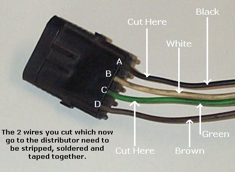

Joe, i google "4 pin connector on chevy distributor" and got this ... dont know that it will help, but might.... apparently the 4 pin plug goes to a computer than checks for spark knock, timing, etc...... your trying to bypass that... and the two pin plug might be the POWER ? ( pink wire he talks about ??)
GOOGLE---
I had a problem with my 86 C20 305-H engine. It could start and run fine and just suddenly die out, sometimes start right back up or take a couple hours to get restarted.  After several weeks of this nonsense (and getting very good at getting those half turn dist. cap latches off), I did some checking.  There is a power feed to the spark control unit under the dash that comes off of the pink (hot) wire to the distributor.  The pink wire clips into the connector for the feed, which in turn clips into the dist. cap.  What had happened was the feed for the Spark Control was shorting out somewhere, killing the spark.  I talked to some Chevy mechanics at my dealer about this and they told me how to bypass the spark control computer and keep the original distributor, something they claim is done quite often.
First thing to do is unhook the spark control computer lead from the pink wire and hook the pink wire directly to the dist. cap.  Make sure you plug it into the cap at the BAT terminal.  The second thing is to locate the 4 wire connector that feeds into the ignition module.  There's a brown (D), green (C), white (B), and black (A) wire there.  The letters in () are on the black clip that the wires come out of.  You cut the green (C) and black (A) wires between this clip and where they go into the distributor.  Then all you need to do is solder the 2 cut leads from the dist/ignition module together, i.e. the green and black ones, (make sure to tape the exposed wires) and now your HEI distributor will function just as a pre ESC model does.  I did this and it has been running fine for well over a year now.
Dan
Note:   http://www.73-87.com/7387garage/drivetrain/escrepl/plug1.jpg" rel="nofollow - Here  is a photo I made of the plug which goes to the ESC control and feeds the ignition, which Dan mentioned above.  I labeled the wires which need to be cut and showed which wires are A, B, C and D.
That's it.  Of course you will need to adjust the timing when you get it running.  This mod converts your truck back to a regular HEI ignition, without all the electronic controls.  You will have to monitor your spark knock yourself since you won't have the ESC to do it for you.  If you have ever had an older vehicle you know how to do this anyway, why do you need the ESC to do it for you?

 Hey STEVE,,, I KNEW YOU WOULD FIND WHAT I NEEDED,,,!!!! I can't wait for daylight to gp put a spark in the bruiser,,,,Ummmm,,,,366 lead sled,,,,LOL
 That guy knows what he's talking about as those are the wire colors, cause I just come back from out there,,and it is FRIGGING COLD out there and I was in my jammies,,,!!!
 Many THANKS, Steve.Clap

 Well, me being an eternal Optimist,I'm going with the link Steve sent me as what I really need to do ATPIT is to get the engine to fire via the procedure that dude sent to Steve. I checked the wiring harness that was with the engine and the 4 wires at dist are same color as he states including the 2 wire harness going to the coil. Then just spray some Boy Scout Water in the Throttle Body to keep it running long enough to verify oil pressure, ect, ect and then clean it and the BIG old Allison trans up and sell it,,,,OR,,OR,,if it will fire with that dude's mods to distributor, then I would look at an aftermarket intake specificly made for the Tall deck BBC,  throw a Holly 4 barrel on that and let er rip,,,,A dude on one of the groups on Marketplace says lots of tall deck BBC's are alive and running with those mods,,,SO,,I got my fingers crossed,,,,ClapClap
