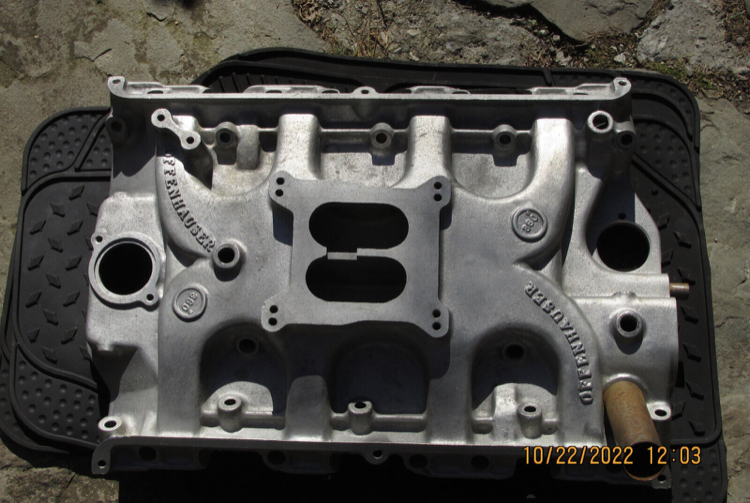

Posted By: jvin248
Date Posted: 26 Nov 2022 at 12:48pm
How smooth are the flow passages in those two manifolds?
That will change performance.

Posted By: CrestonM
Date Posted: 01 Dec 2022 at 9:23am
Could someone tell me what the tube coming out of the right front of the manifold is for? None of the new ones I’ve seen have that. At first I thought an oil fill tube but since I haven’t had my manifold off yet, I don’t know where it would lead to if that’s the case.
Also, why is there a notch machined out of the divider between the plenums?
Last question…there is a hole at the back end of manifold with two bolt holes. No other FE manifold I’ve seen has had that hole. Looks like where the thermostat housing would go on a GM. Since GM has the distributor at the opposite end of the thermostat, could it be possible this isn’t an FE intake?
Posted By: plummerscarin
Date Posted: 01 Dec 2022 at 11:54am
Most definitely an FE intake. I have the dual quad version of that. I made a block off plate for the rear opening as the oil fill is in the valve cover. Mine does not have the tube in front
Posted By: Thad in AR.
Date Posted: 01 Dec 2022 at 6:17pm
Does it still have the thermostat location on the front?
I’m just wondering if that’s some kind of marine setup?
Date Posted: 01 Dec 2022 at 6:52pm
Yes thermostat is in the front facing forward with an L shaped housing. In photos I've seen the tube is the oil fill. My cast iron manifold for the 68 does not have this fill tube. The Offy dual quad I have has the opening for a fill tube but I don't have the tube. The big opening in the back opens directly to the lifter valley. I don't know what would go there and I can't find literature that shows it. That's why I made the block off plate
Posted By: IBWD MIke
Date Posted: 02 Dec 2022 at 7:45am
Creston, is that a 'dual port' manifold? They had a divider in the runners. I believe the thinking was to keep the velocity high. Kind of unique. That would make a good intake for what you're doing. Ford buddy of mine growing up had one on a 429 C.J. He also had a 427 tunnel port that I drooled on a time or two. He still has the 429, it's in a '70 Torino Cobra. The tunnel port is long since gone.
Posted By: injpumpEd
Date Posted: 02 Dec 2022 at 7:47am
rear opening is for earlier FE engines, that used a road draft tube for crankcase ventilation. They also used the tube oil fill in front like pictured. The tube can be removed and a plug installed, and a block off plate put on the rear opening. The FE went through a lot of minor changes in it's multi decade run.
Posted By: PaulB
Date Posted: 02 Dec 2022 at 12:56pm
Those Dual Port 360 manifolds were supposedly the thing for fuel economy for light driving and still give flow when you stomp on it. They came out after the Arab oil embargos of the late 70s early 80s. The small ports were for the primary barrels. I put one on my 75 P/U with a Thermoquad on it.
Posted By: Ed (Ont)
Date Posted: 04 Dec 2022 at 9:26pm
If you are using that intake you will need an adaptor plate to use Quadrajet style carb (small primaries and big secondaries). Those adaptors are maybe an inch thick or a bit less. You have lots of room on a truck so should have lots of hood room. The extra height will give you a few extra ponies on the dyno so a win win deal. Holley square bore will bolt right on.
