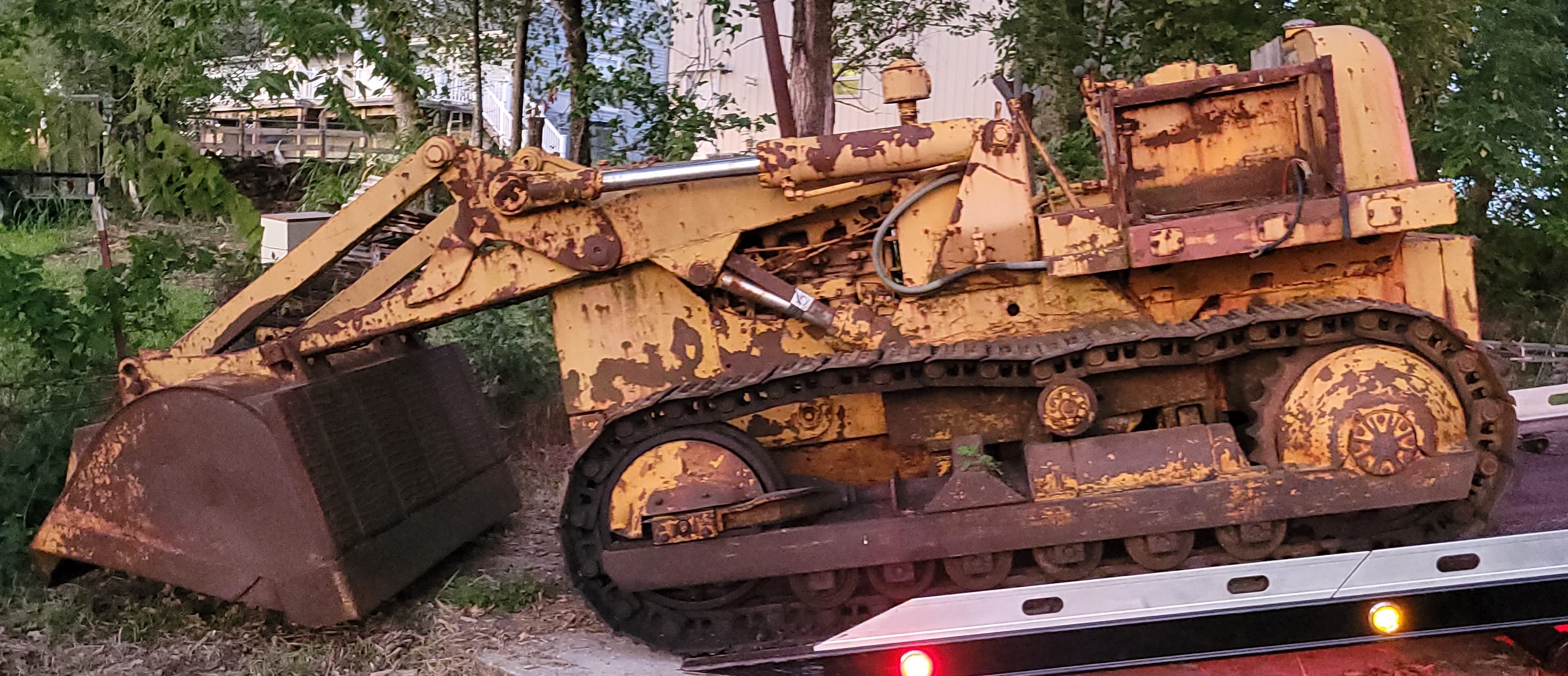

Well here she is, in all her glory. I told the tow company she weighed in at 16,000+, but the dispatcher told the driver it was 12,500. He must have looked up the Ag crawler specs and didn't know it had a loader and counterweights. That truck was bagging, but hauled it the 30 miles to my house. Seller said it had been down for 'a year' . My guess.....3-5 years. Many controls and linkages stuck, and the tracks wouldn't turn....seller assured me 'it would roll', they had 'moved it with a tractor several times'. HA! I figure the brake bands are rusted up. Anyways, has full oil with a lot of diesel fuel in it, hydraulic fluid is clean and full. Clutch is out. I wonder if diesel dilution in the oil will separate after setting for a long period? Will it float to the top? I'm going to change the fuel filters, flush the lines, put in some batteries, and see if this old B#$ch will fire up. As an old nostalgic mechanic who loves old machines, this is like a mystery novel. I feel like Dorothy finding the Tin Man and loosening up his parts with oil. I will find out all that the seller knew , but didn't tell me, and I will find out how much he didn't know, and why he couldn't keep it running.

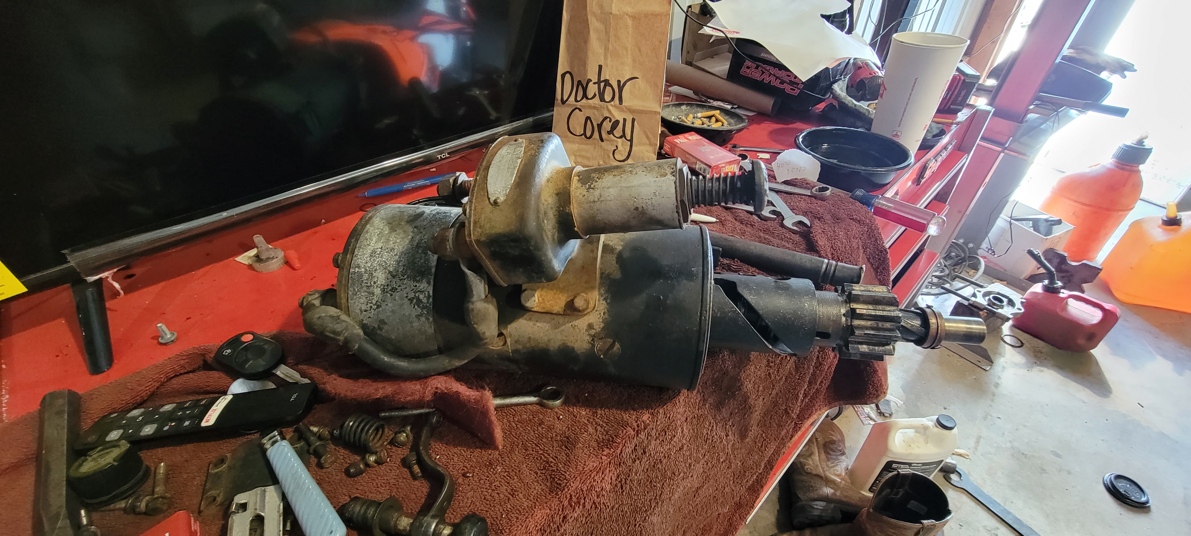

Can you post photos of the starter and parts; along with identification tag? I will be over to the rebuilder I use next week and can show them what you need. You may be better off replacing it however.
Posted By: doctorcorey
Date Posted: 10 Sep 2022 at 11:24am
The only ID tag is on the manual contact switch. Hard to read  DelcoRemy 4070, or 4c7c....32737. Definitely has been rebuilt before, very clean on inside, and old punch marks. This little pawl on the bendix arm has been repaired before, I found an old clutch cylinder rod from my F250 that matches the two step diameter of this pin exactly, so I will make one if necessary.

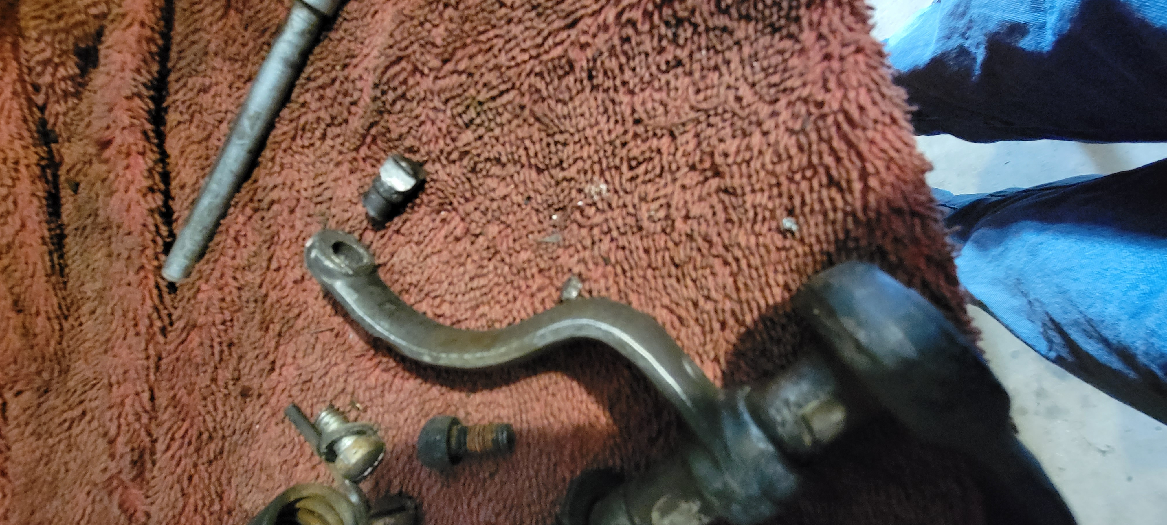

So, today I fabricated a new pin for the starter engagement lever, and reinstalled the starter. I then changed the fuel filters. About that time, it started to get cold and rainy. I got fuel to the primary filter, and figured I'd try to see if the starter would now work. Hit the plunger, and it spun over like a sewing machine. I cranked a few times for a total of probably 20 seconds. It sounds very even, like no dead holes. It started filling the oil filter housing, and sending fuel to the secondary filter. There was nothing in the cylinders that was combustion-worthy....I had went through the intake ports and added a mixture of ATF and Berrymans B12 before manually turning the engine over about 10 revs.  I had a small tin bucket over the exhaust, and I did get it to 'rattle' that bucket a few times. It was getting dark, and the rain picked up, and so did my beer intake. I'll get back to it tomorrow, and I think it's going to run. Thanks all of you for your help.

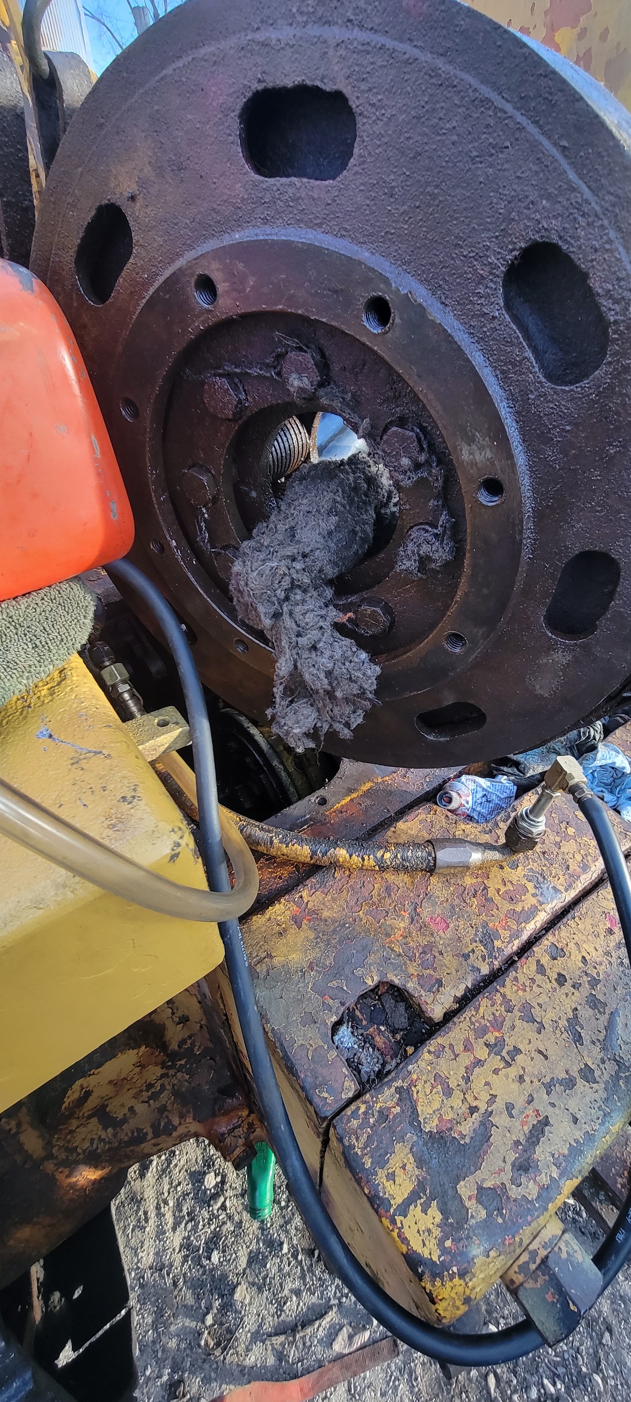

  Thanks, I'll try that. Now, I'm trying to tilt the radiator guard/nose piece forward so I can access the injector pump (to get the transfer pump out, the guard is partially blocking it). I removed the two rear bolts. Am I supposed to turn or loosen those two big flathead pivots with the 3/4 square drive, or is it supposed to pivot on those? Never had to move this piece on my 7G.
  Also, it looks like someone has chiseled on those in the past, to try to turn them, I guess.

I got all filters thru our local NAPA. Pull the motor to work on/replace the main clutch. Hopefully you have an oil clutch. The adjustment is under the floor board.   Usually easy to adjust. Good luck with the old gal. They are a whole lot of fun to operate. Wish I still had the last one I owned. It went to central Nebraska.
Posted By: 200Tom1
Date Posted: 11 Sep 2022 at 11:12pm
I've used 2 torches at the same time to heat up those big bolts. Spot weld them on the outside and get the biggest breaker bar on those nuts and start in. While you have it opened up. Replace the radiator hoses. Be careful you don't leave anything laying on top of the motor while starting the motor. I left a 3/8th wrench up there, the fan kicked it thru the radiator. That was $400.00 to fix 20 years ago.
Date Posted: 11 Mar 2023 at 11:24am
Three or four days soaking the entire clutch pack in hydrochloric acid, and was able to separate the clutch discs. They look like they were nearly new. I replaced all the steels, and springs. Installed grease hoses on the t/o bearing while I was in there. At least I saved the drum $$. That mouse pee, over time, becomes a good imitation of epoxy. Used new brake bands L and R from SC.com. My tractor is now ready to move dirt, but it's rained every day for what seems like a month, and this black Missouri topsoil likes to sink tractors. Still, even with replacing steering clutch and main clutch, I'm still under my $6,000 budget, and can lift, push, or crush anything on my ranch.
Semper Fi USMC    1958 HD6G, 1959 MF 203 loader, 1960 Case 420B Backhoe, MF 65 Tractor/Loader Diesel
Posted By: orangeman
Date Posted: 11 Mar 2023 at 3:54pm
Nice Work ~ Orangeman
Posted By: 200Tom1
Date Posted: 15 Mar 2023 at 12:33am
Way to go guy.   I sometimes wish I hadn't traded my last 1 off, but since my left arm went bad, I couldn't work on it. I hope you have fun running the old gal.
Date Posted: 20 Mar 2023 at 5:25pm
  The main clutch was the worst part, one or two good arms. My big belly didn't help at all.....Tongue

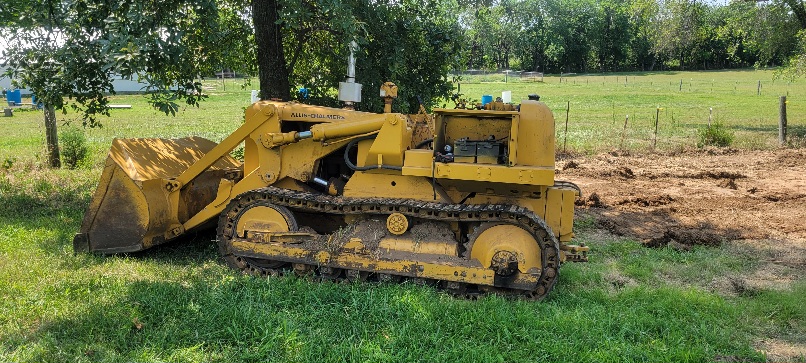

Date Posted: 23 Aug 2024 at 8:20am
Thought I would post a Pic just for the heck of it. It just runs and runs.....
Date Posted: 23 Aug 2024 at 5:44pm
Nice muffler set up - where did you source?  ~ Orangeman
Date Posted: 24 Aug 2024 at 12:19am
The muffler itself, I bought off of ebay, just shorty 3'' turbo muffler. The manifold I built from the stock piece, cut out the oval muffler and welded in a piece of heavy wall muffler tubing in it's place. I put the extension on top of the muffler to keep the fumes out of my face, but it provides a substantial arm/moment to strain the welds and clamp junctions due to the engine vibration.  Need to add a rubber suspended brace somewhere.
