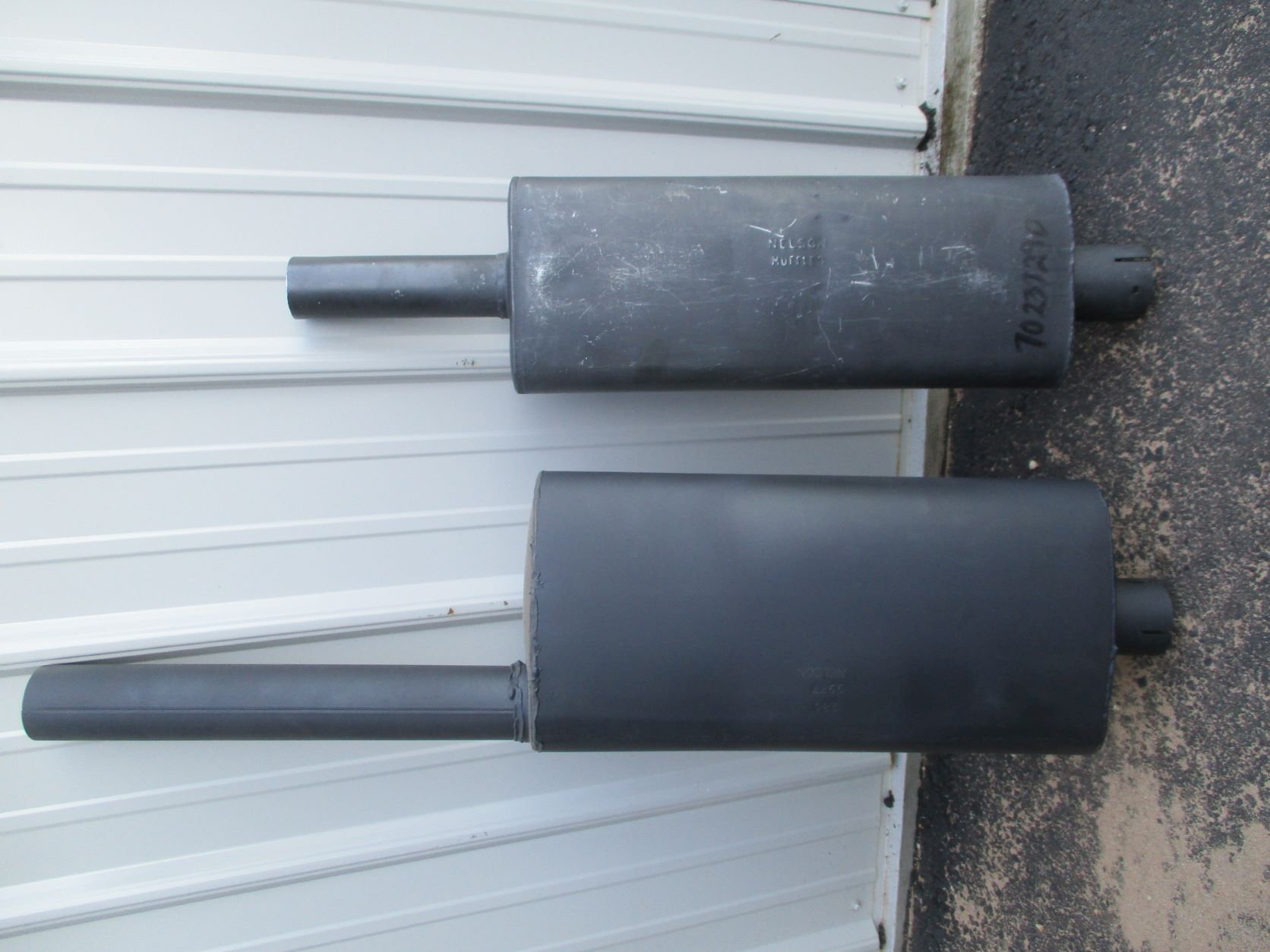

Here is a new 185 muffler next to a NOS late D17d muffler.

OK. The 185 muffler does fit a gas series 3 and 4  D-17, and also pretty sure the D-19 gassers are the same too.  I'm surprised that it fits the gas models and the diesel is a smaller body.

The D19 gas should have a 1 3/8" inlet and the 185 muffler will work on them. You may have hit the wrong key as the 175 gas muffler fit the D17 III/IV gas and the 170 gas, those have the same inlet at 1 15/16". But none of those have the 3x7 oval body required for the D15/17 diesels. And it is not a straight through design. The only other A-C mufflers that have the 7x3 body are the D10/D12 oval and the HD3 crawler that I know of. If I have some time, i'll see if Nelson makes any mufflers for other colors with the 3x7 oval yet.

Not a wrong key. I use the 180/185 mufflers on D-17 3 & 4 and 170 gas tractors. First one was my Dad's series 4 back in 1969 or 1970. I have to use a piece of pipe to adapt the larger inlet to the gas manifold pipe. They sound better, exhaust up higher and surely (in the mind of a 16 yr old ) had more POWER !!  I also had engine speed/governor action so full load was 1900 RPM instead of 1650 RPM, so the larger outlet had to help reduce exhaust temps when working it hard.

To update everyone on the D15/D17 diesel oval muffler, according to Nelson there is no 3"x7" oval body muffler in production or in their current catalog. So there will be no alternative Nelson available as ordering new ones is insanely cost prohibitive. Only option is to cut hole in hood larger or to space the 4.25x9" oval above the hood.
