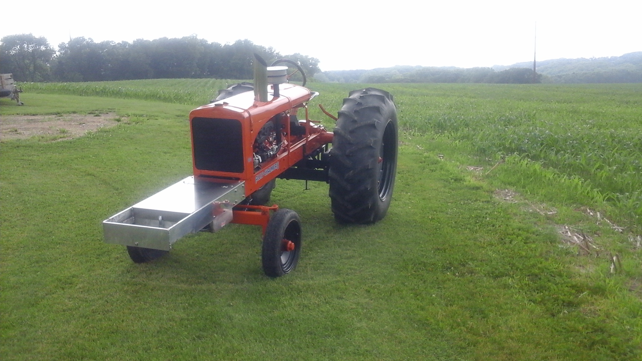

Posted By: Robacpuller
Date Posted: 24 Jul 2022 at 8:44pm
4.600 bore, 6.250 stroke.
Mine is 4.600 bore 6 inch stroke. A lot of air flow work.
Really good cam. 290 lbs of compression low 120's for power.
18.4 x 34 tires
