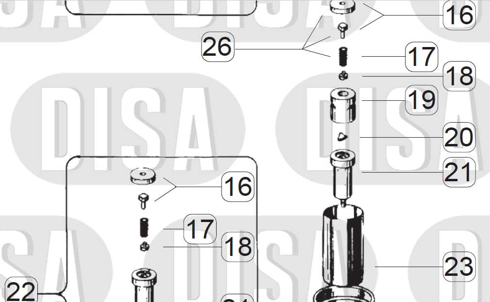

In trying to reassemble the injector with a new tip, the spring got away from me and the parts got launched into lunar orbit.  I have recovered them somehow except for the smallest parts, 16,17, and 18 on the diagram.  After being overwhelmed by the whole thing, I finally discovered, I think, a trick to squeeze the parts just right to get that side retaining pin in.  I'm lucky my face wasn't impacted by all this.  My budget has been stripped bare and hoping someone may have a good or bad injector around that those parts could be scavenged from.  As always, pure joy in the challenge.

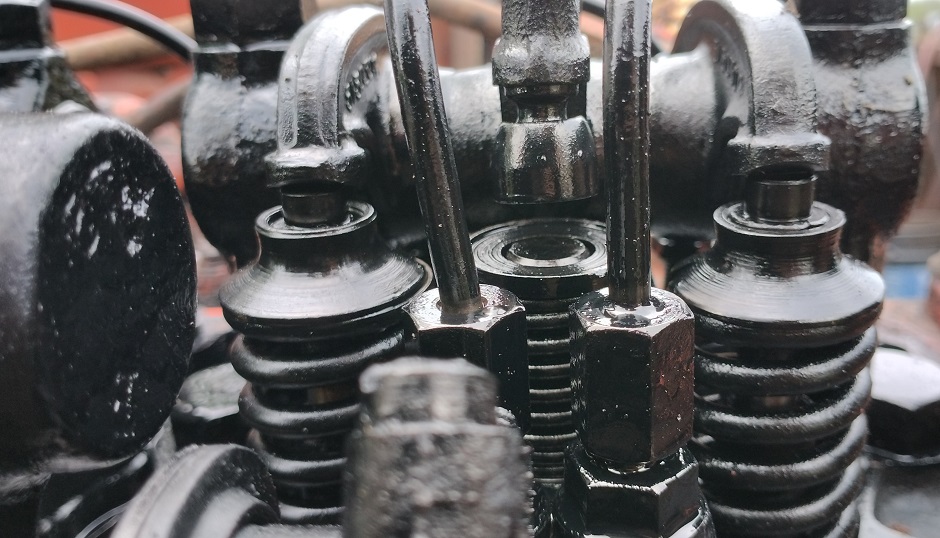

Looks like I'll be in for  learning curve on a 2-71.  Rack won't move, and a big gap between top of injector plunger and injector rocker arm on one injector. Don't think that is right.
 Injector plunger stuck
